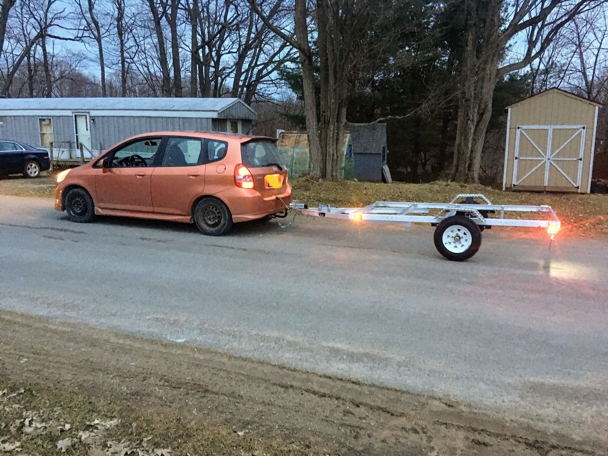

Here is my list of parts from etrailer to tow a 1000 lbs with my fit
C56011 Curt T-Connector Vehicle Wiring Harness with 4-Pole Flat Trailer Connector
F-4 Curt Class I and II Pin and Clip - 1/2" Diameter
C45014 Curt Class II Drawbar - 5" Rise - 9-5/8" Long - 3,500 lbs
C40018 2" Hitch Ball - 3/4" Diameter x 2-1/8" Long Shank - Chrome - 3,500 lbs (this depends on what ball your trailer takes)
24776 Draw-Tite Sportframe Trailer Hitch Receiver - Custom Fit - Class I - 1-1/4"

C45014 Curt Class II Drawbar - 5” Rise
This was one of the things I bought because I couldn’t get it locally.
The hitch is really close to the ground so for almost every trailer a straight draw bar would put the tongue of the trailer really low.
This is the largest rise I could find in a 1 1/4 and I didn’t want to add adapters as that would increase leverage of the tongue weight on the hitch.
You can see even with a 5” rise the nose of the trailer is a little low even without weight on it.

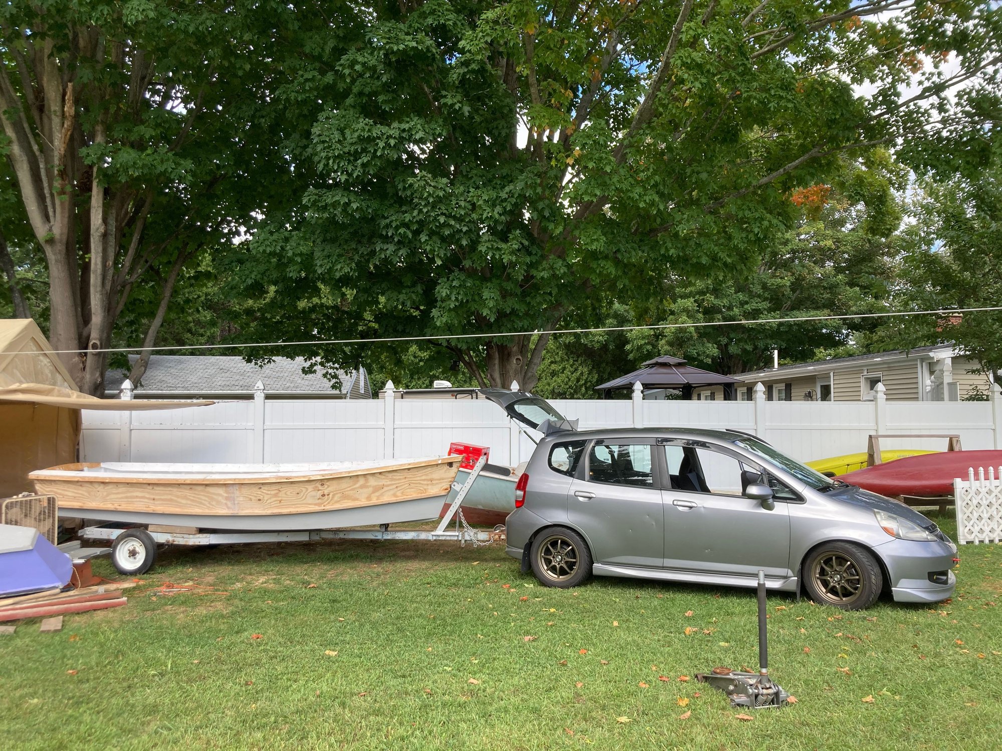

I think it’s because the trailer is pretty high, I’ve towed a small (empty) landscape trailer ... and several small boats with my fit. I use a regular 2” rise/drop hitch and the aforementioned trailers sat very nice behind my car (even lowered a couple inches it takes the load well)
it looks like your trailer might have the axle mounted on bottom of the springs instead of on top - raising the ride height

Yeah the axle is below but on this trailer its one of the U channel axles and I didn’t want to modify it. I would rather just replace it someday with a proper braked axle.
