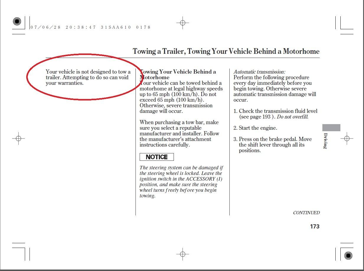

I thought all the trailer hitches are mainly for bicycle carriers and not really to tow a trailer since the manual explicitly warned against trying to tow anything on the GD model. Has any tried? Safe to do it?
you have revived a fairly old thread to ask a question that has been answered numerous times in other threads ... maybe try a search next time ?
afaict, there are plenty of folks who have towed using the usa-fit - and yes, they did it safely... if you want more info (like what extra equipment they might have added to ease the strains), try searching...
sorry to barge in, but im kinda snippy tonite...

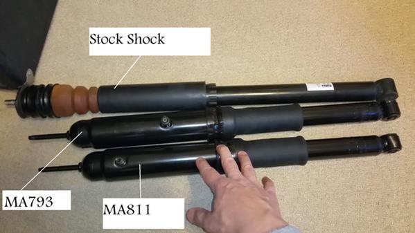

Class I trailer hitch from Curt Trailers installed
Curt Brake Controller
7 way adapter
This is before I got the air shocks installed. its squatting somewhat, not anymore with the monroe air shocks.
furniture haul 02
tongue toolbox
Mock Setup of Air Shocks
MA811, MA793, and stock shock compare
MA811 installed with 40psi and ~130lb tongue weight on car.
~700 pound lumber run
Tailgating Party with Trailer.
Plate installed. With Monroe air shocks at 50psi, height from ground is 14 inches
The 10" long shank makes it easy to clear the hatch for opening, and helps on the steering angles

I want to tow a small tire trailer on my GD3 as 4 track tires/rims won't fit easily into the trunk with my other track stuff. But the 2008 Honda manual warns explicitly against towing. I found a nifty site that has several tow hitches for sale at reasonable prices, but I wanted to see what others did. Also there's the whole matter of the electronics connector box for the hitch. I'm familiar with the transmission cooler trailer hitch combo on the Honda Odyssey, but that van was built to tow some stuff. I'm just glad I didn't see any posts about being thrown off the road while towing something on a gusty freeway. I guess I could always try to put the tires on a roof rack of some sort, that would be interesting as it would make me so top heavy.
