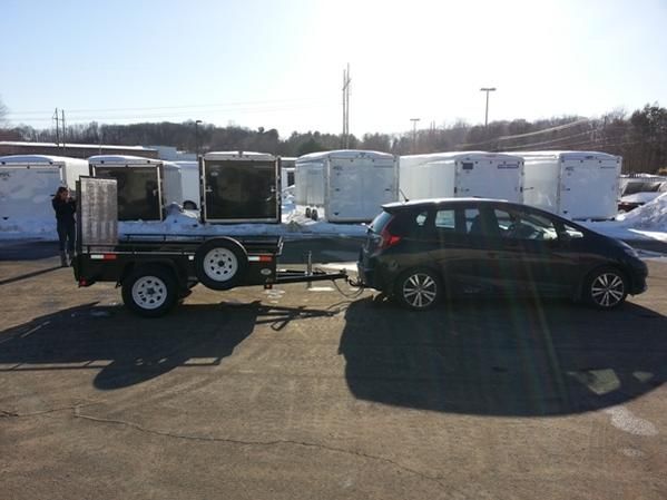

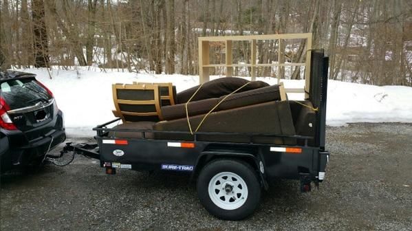

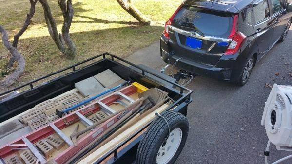

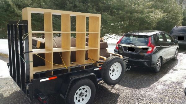

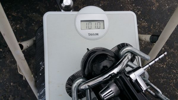

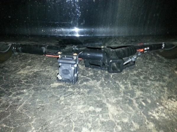

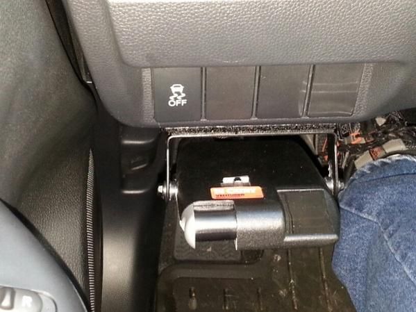

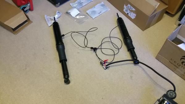

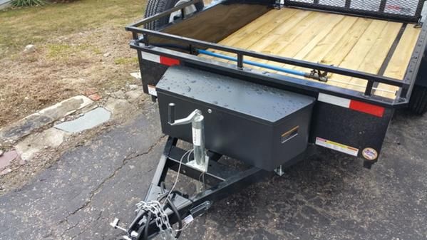

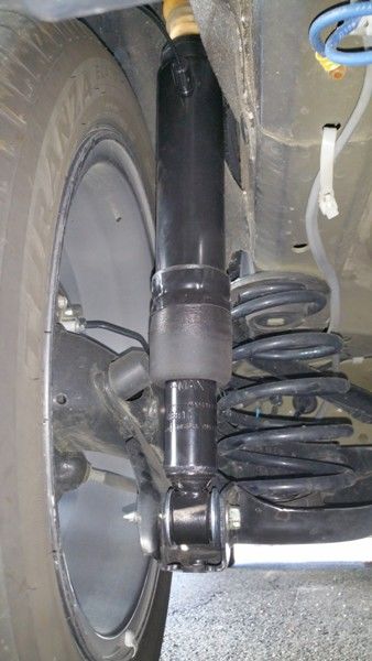

Ben i tow with my GK 3rd gen and have no major issues. I had to upgrade and customize the rear suspension with air shocks to compensate for the back end sag due to tongue weight. I have a 5x8 utility trailer 875lbs dry. Not sure how heavy a box or vnose 4x8 is but if its 875ish plus cargo you should be fine. I have hauled around 1700 pounds gross of the trailer/cargo. Granted its acceleration challenges at that weight but its doable if you tow smart. Check out my writeups and videos. Plenty of knowledge to share.
7 way adapter
Curt Brake Controller
Sure Trac 5x8 Trailer 02
tongue weight empty
furniture haul 01
furniture haul 02
Mock Setup of Air Shocks
tongue toolbox
MA811 installed with 40psi and ~130lb tongue weight on car.
~700 pound lumber run

I got the idea the OP was planning to use his Fit for a single long distance tow, as he moves his belongings from South Carolina to Minnesota. For a single move like that, I'm not sure I'd take the plunge into air shocks. Obviously, if he were to buy and keep a trailer and use his Fit-trailer combo for repeated trucklike duties the way Bassguitarist does, my advice would be different. Also, if he rents his trailer from U-Haul, it will probably have a surge brake, so he won't need to wire in a brake controller.

Good point. The only detractor with surge brakes is backing up. You need to insert a pin so the master cylinder in the tongue doesn't engage the brakes while in reverse. They work well for the application. I suppose skipping the air shocks is an option, but the back end was not meant to handle the extra 200 pounds max of tongue weight plus whatever is in the FIT itself. You will need to compensate for ride height, otherwise your Fit's ass end will be nearly dragging on the ground riding on the springs alone.
Air shocks prevent this from happening...
