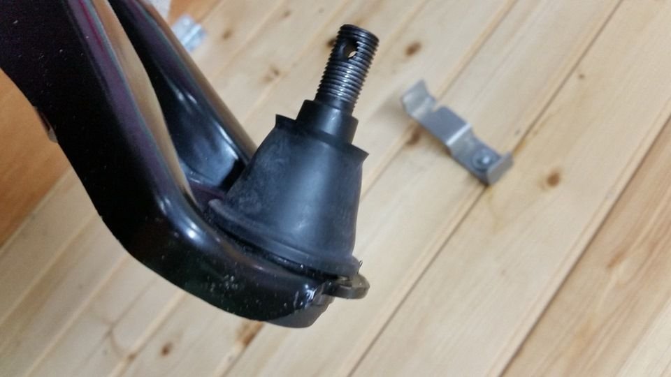

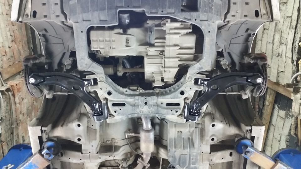

Some bad news about Dorman arms (the ball joints went in 30,000 miles).
The good news: alignment (toe adjustment) was not necessary after arms replacement
(source Drive2.com)
Work completed (in the shop)
Another view
Close up of the new arm with silly-looking boot

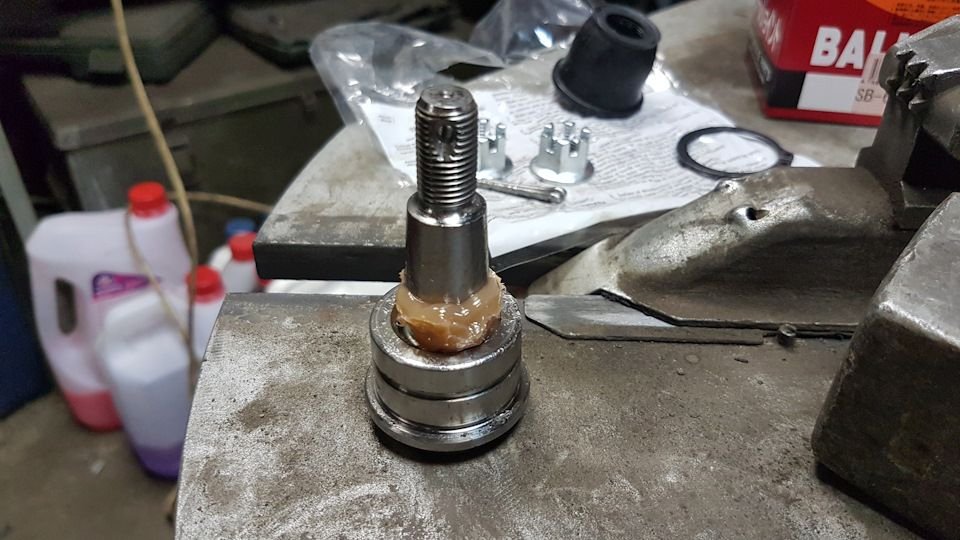

So the owner replaced the boot with Honda OEM

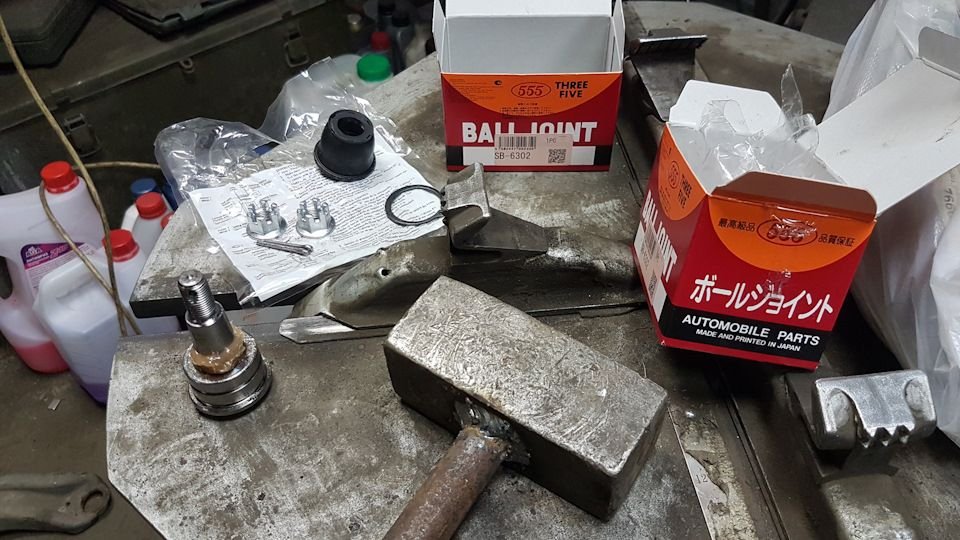

This is what he bought
Another joint he had to buy
I am guessing, he was using the sledge to drive a joint in? Well, Fit is not T-34 tank (it's stronger!)
