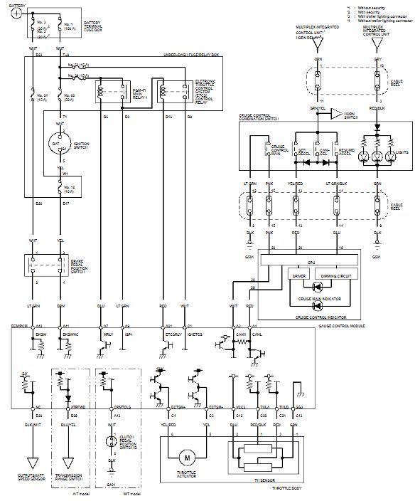

Jazz/Fit 2nd Generation Cruise Control Wiring
Old Sep 11, 2024 | 04:01 AM
oitar's Avatar
Joined: Jul 2022
Posts: 3
From: Johannesburg
On the same note, I have everything wired according to above schematic. Mine is 2013 Jazz CVT, right-hand drive. Cruise main comes on, but Cruise control doesn't engage. HDS shows me all button inputs, except the second brake switch, which is nowhere to be found. If anyone had this issue, please comment. The second brake switch should be normally open- that is when you leave brake pedal alone, it presses the switch, and sends +12 V to pin A41(the top ECU 49 pin plug). It looks like my ECU has CC disabled, but why would it then show all the CC switches inputs and outputs in HDS? Also, the transmission range input is called "AT Forward" in HDS, and is on when shifted to D or S.
Any help welcome!
