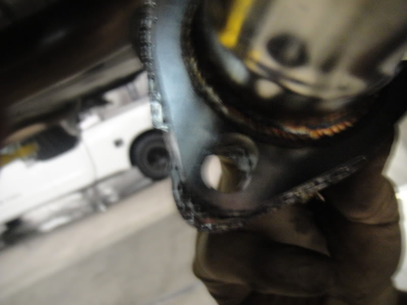

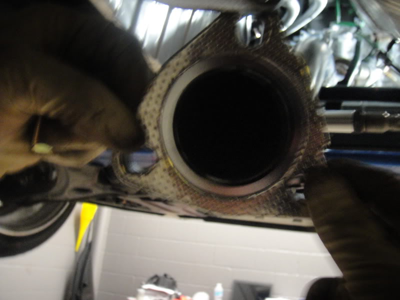

This is how the gasket fit on mine. I posted some info on the original thread for it, but I think the thread has been deleted since.
For the record I have never thrown a CEL with the header and no non-fouler. I think everyone else hasn't installed the sensor correctly.
