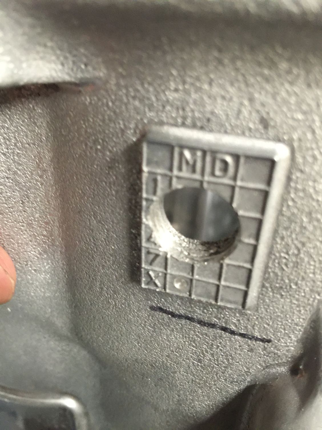

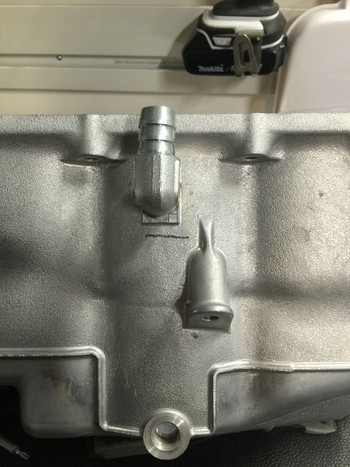

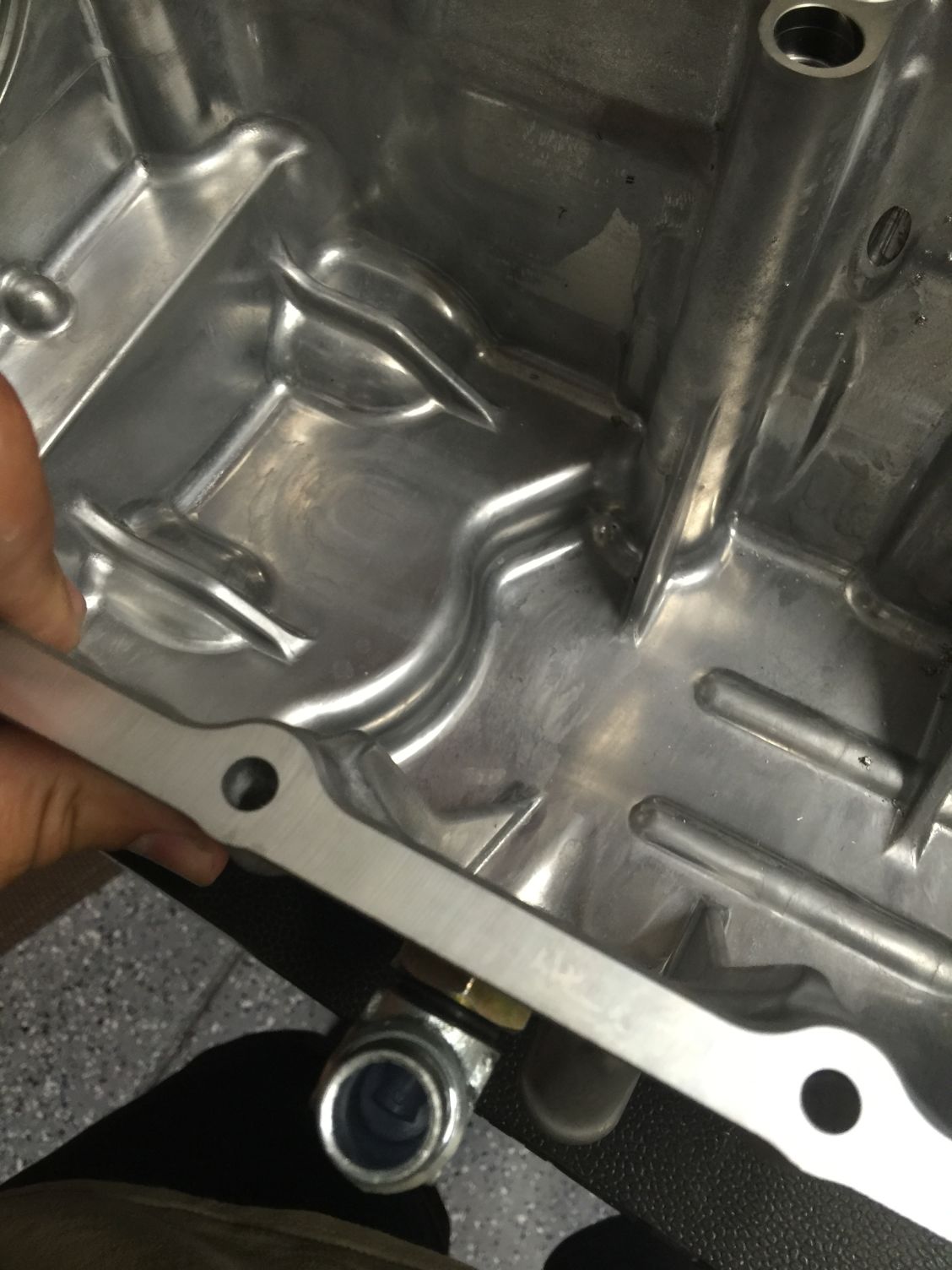

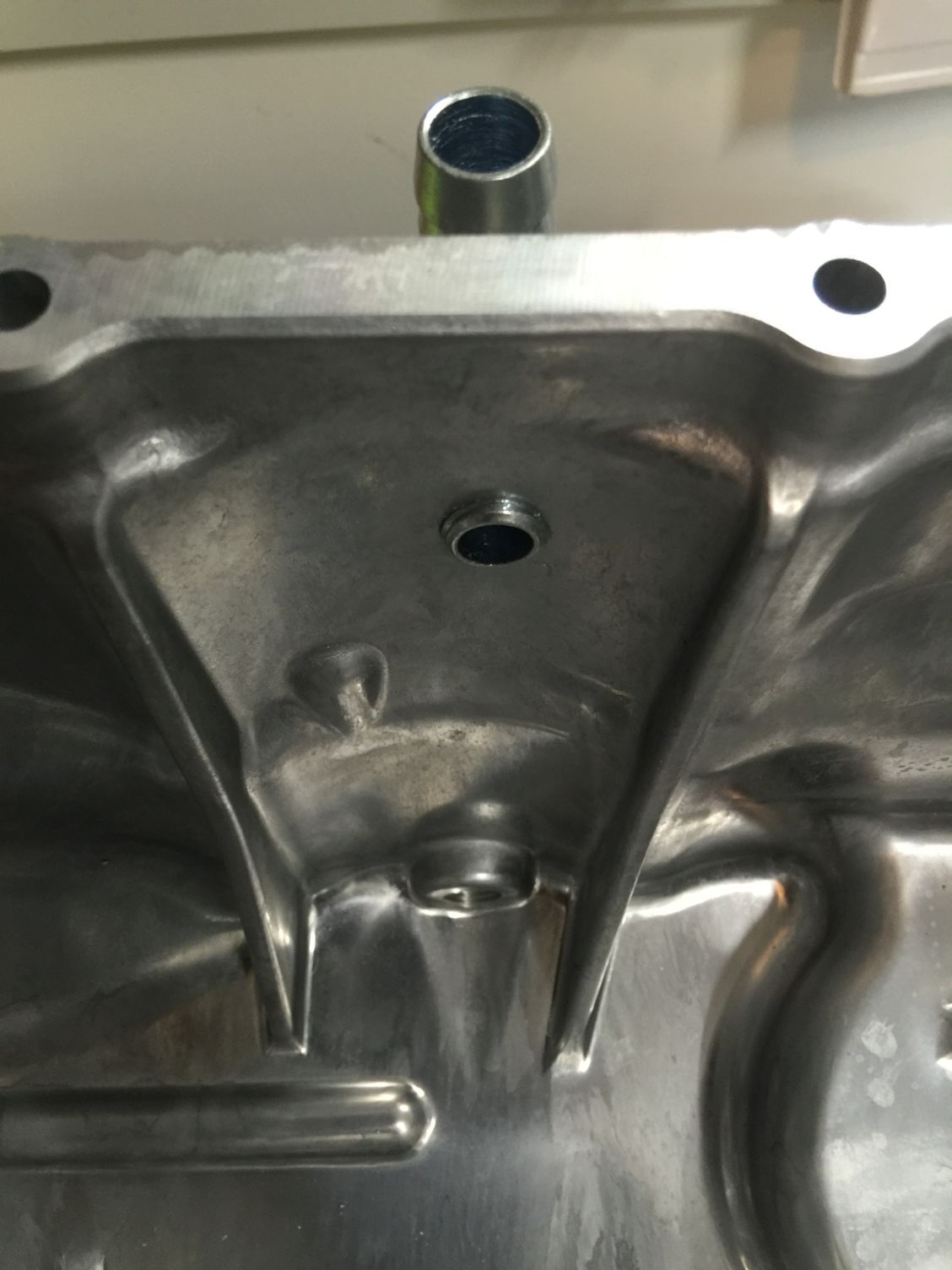

K everyone tapped the oil pans got the ktuner in and RDX injectors coming next week and fuel pump coming tomorrow and nuts and bolts on Tuesday almost ready to install!!

Dot know your whole plan,, but,, When I do the drain back line I use AN10 line, the turbo foams the hell out of the oil, give it a big line and the seals on the turbo will last way longer.
The foam backing up the line at high power is what pushes oil past the seals.
On a big turbo I use AN12. (Pull trucks. .)

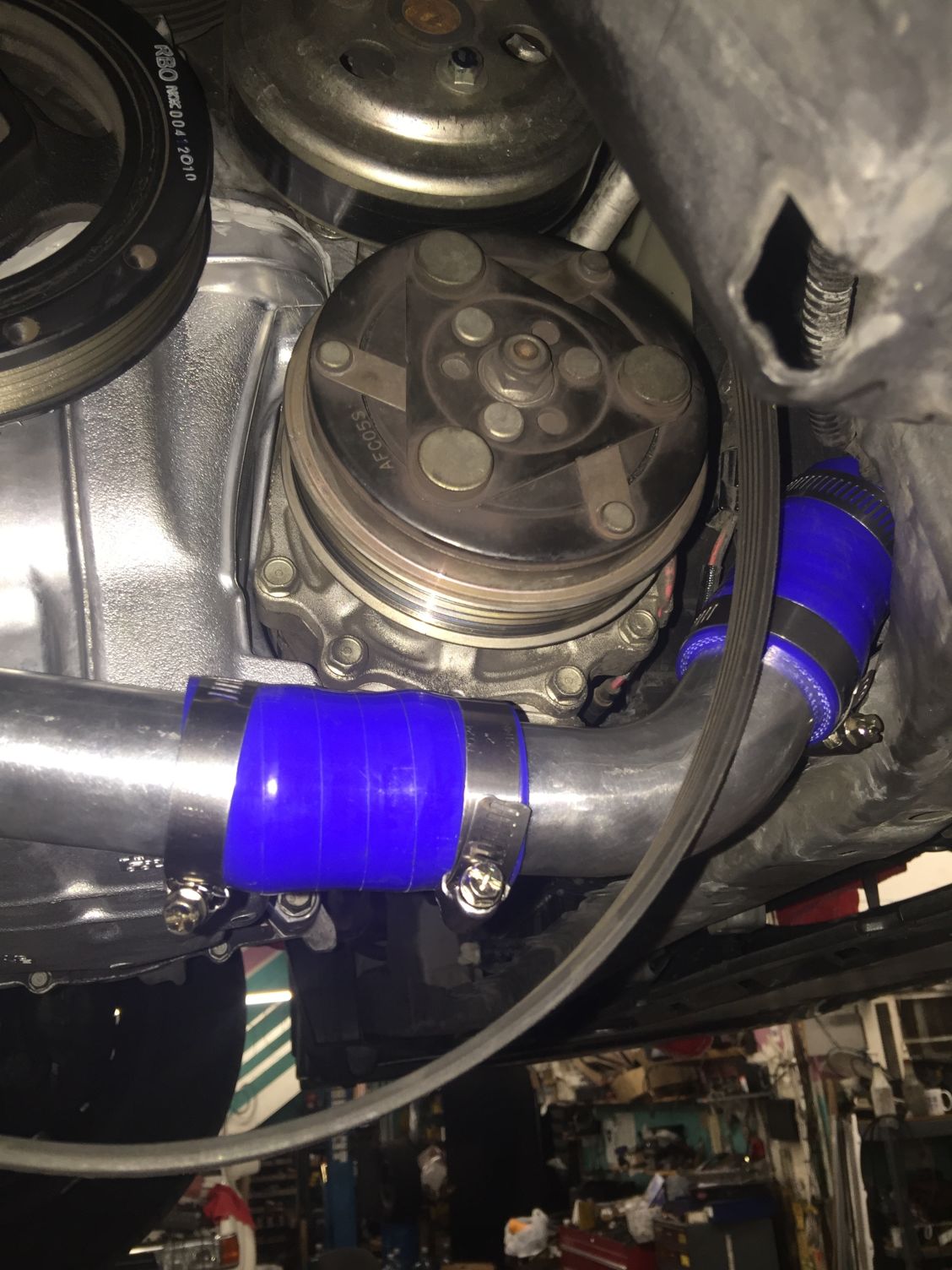

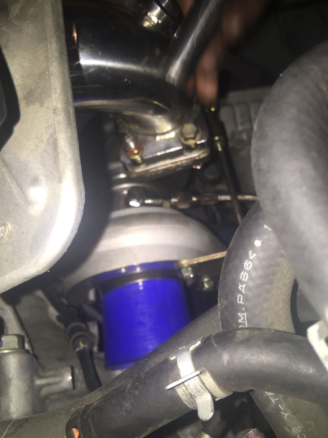

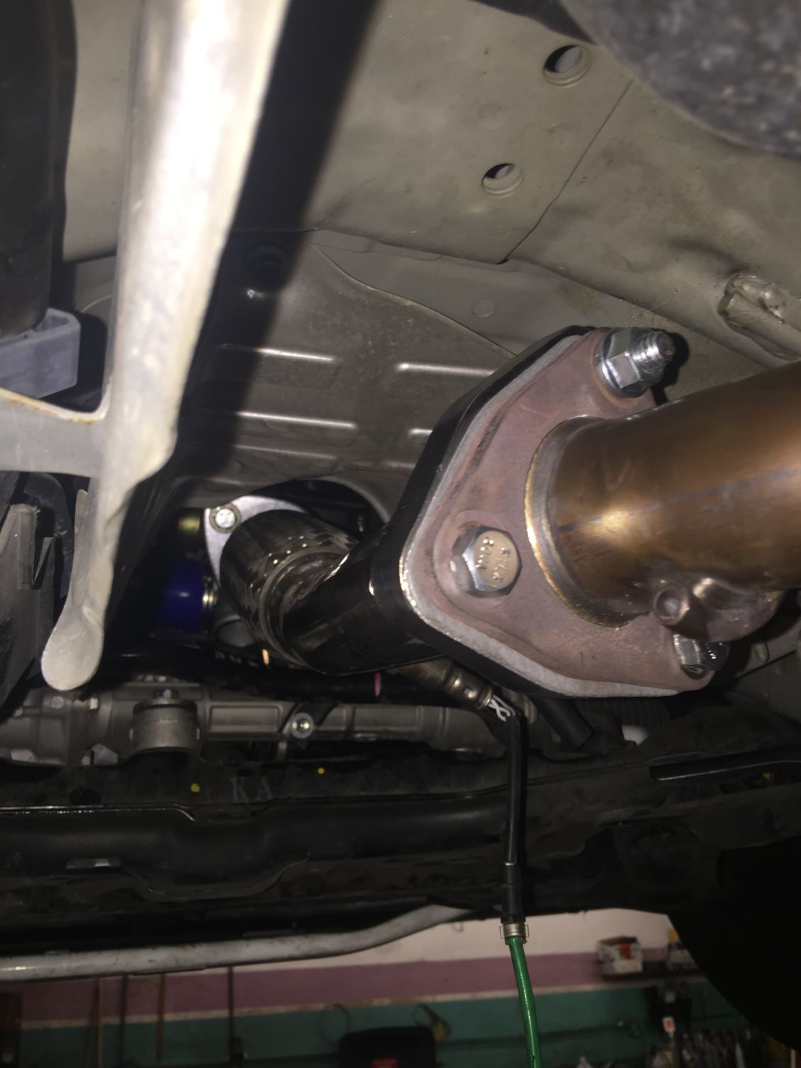

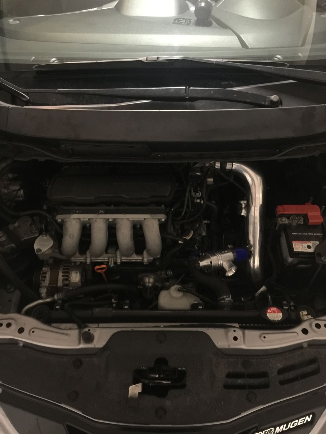

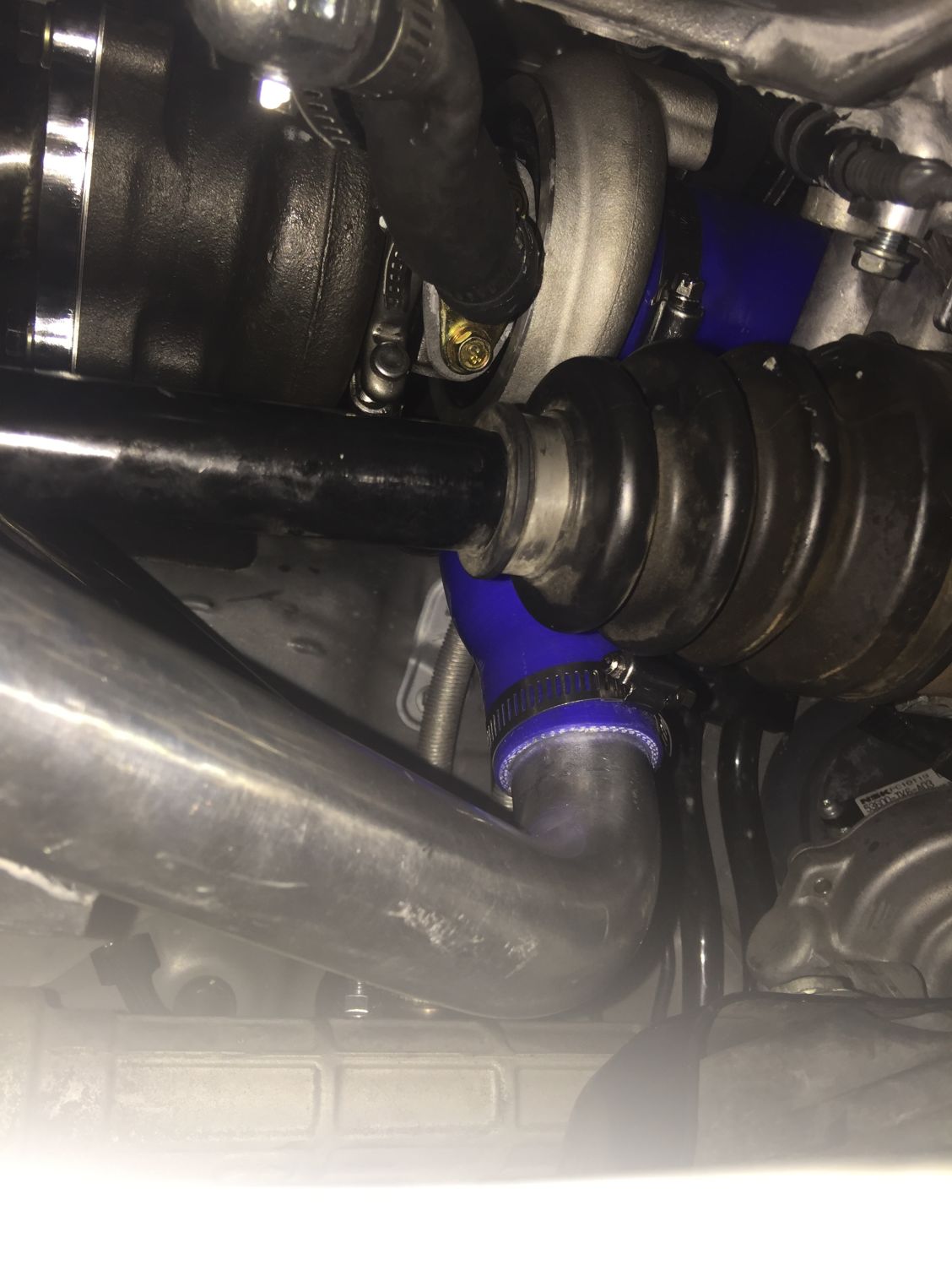

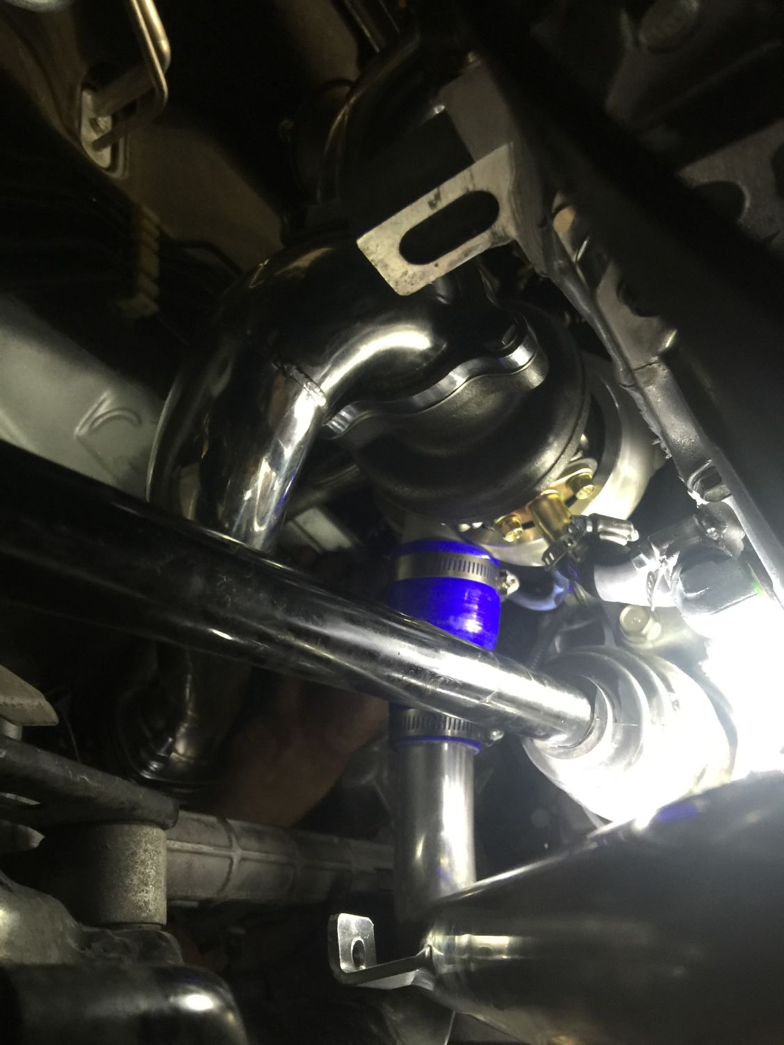

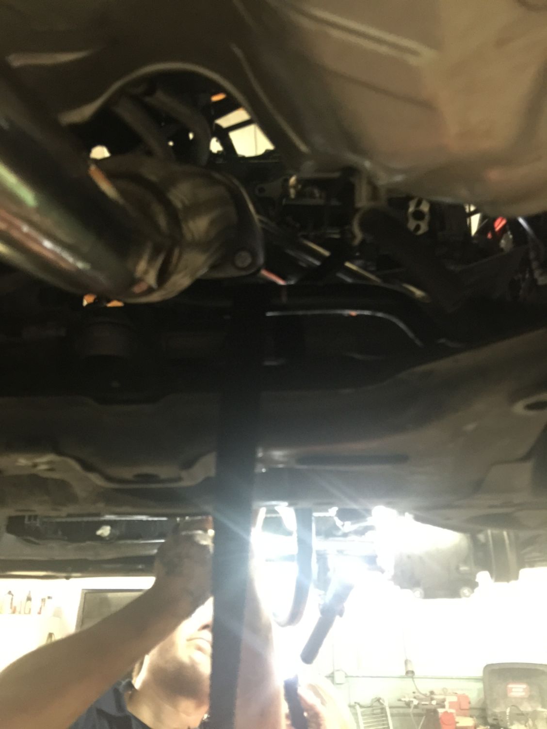

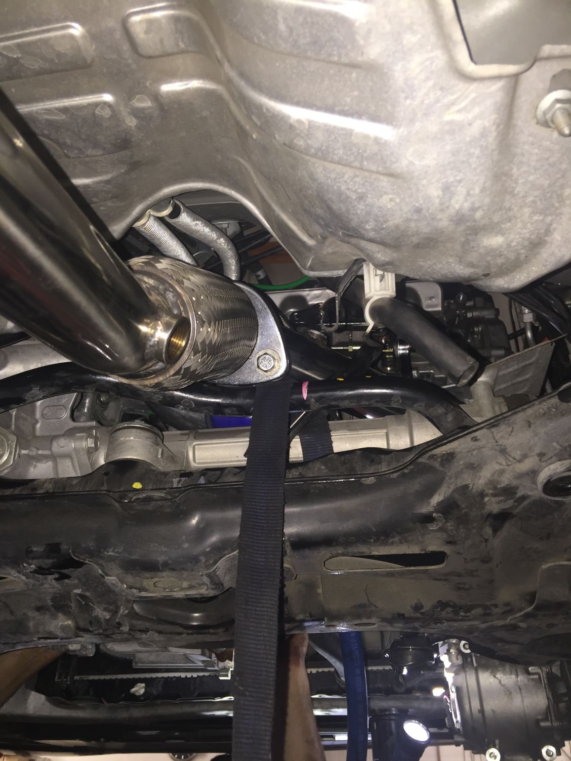

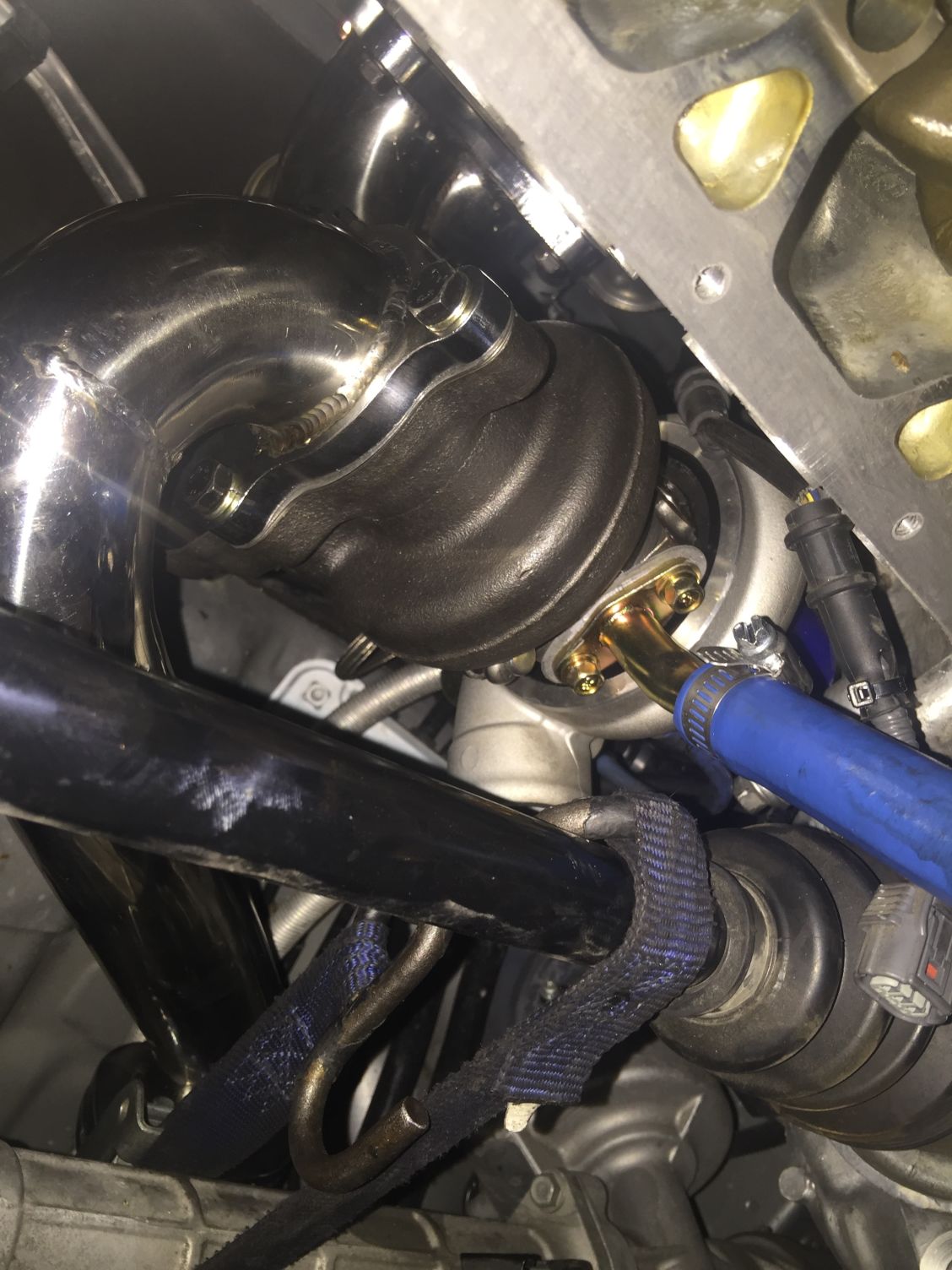

Well everyone Iam offically turbo!! Everything worked out great no oil leaks it amazing!!

Congratulations,
Please give a review on how it's drive, any turbo lag, power delivery, low to midrange feel and top end feel?
and do you happened to have an Air to Fuel Ratio gauge connected?
if yes, may I know the average AFR that you have?
so there is no welding or bending needed for this kit? and everything just bolt it perfectly?
any modification needed?
Thanks
