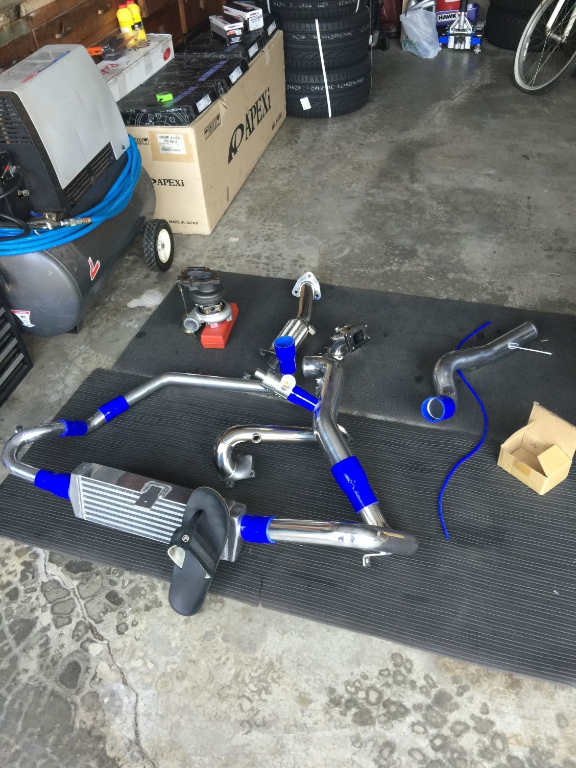

I just do more research on Zage Turbo kit, because I am really interested for my car...
there are some good review like where a Yaris used this turbo kit for 2 years and doing fine:
Zage Turbo Kit Install - Toyota Yaris - Toyota Yaris Forums - Ultimate Yaris Enthusiast Site
and there are an 9 year old review which is not so good:
Return Of The Taiwan GT turbos (background) - 8th Generation Honda Civic Forum
but if Zage still stay in business after 9 years, I think they had improved in quality,...
here is a conflicting 7 years old review:
zage turbo any good? - Page 3 - NASIOC
Another thing that worry me is there are so many connections with silicone hose,
that could potentially be leak point:
and this one on CRZ forum from a Honda Fit GE HYBRID owner in Pakistan that have his engine blown... he thinks it is because poor gasoline quality in Pakistan...
but still it worry me...
Zage turbo bolt on kit for CRZ/Fit Hybrid RS/Honda L15A7 - Page 17 - Honda CRZ Forum: Honda CR-Z Hybrid Car Forums
I can't argue with the bang for the buck for this Zage kit,
it actually make more torque than my slightly modified Sprintex
(restrictor removed, port/polish intake elbow and port/polish lower intake manifold)
and I am confident this Zage kit can make even more horsepower with higher boost,
something that is hard to do for Sprintex since it don't have intercooler and prone to heat soak... unless going to water/meth injection (with it's own complexity)...
on the other hand, there are at least several car in this forum who had been using Sprintex for more than 50k miles (2 years or more) and still going strong no problem...,
That is the reason why it took me so long before I buy the Sprintex because
i want to make sure I understand all the challenge and see how reliable the Sprintex
before I buy it.
If this Zage kit also can provide the same reliability after at least 50k miles,
then Zage clearly have a great product with great value for money, (at about half price of Sprintex).
When Zage is proven to be reliable, at that time,
I will be really tempted to change from Sprintex to Zage or even try to build by own turbo kit.
in the meantime,
GE8FTW really deserve the recognition as the Pioneer (the first one) with Zage turbo on USDM Honda Fit (non hybrid) at fitfreak!

Bmw, i too think its a lot of couplers on there. Id imagine you'd just be able to weld the ones that seem necessary.
