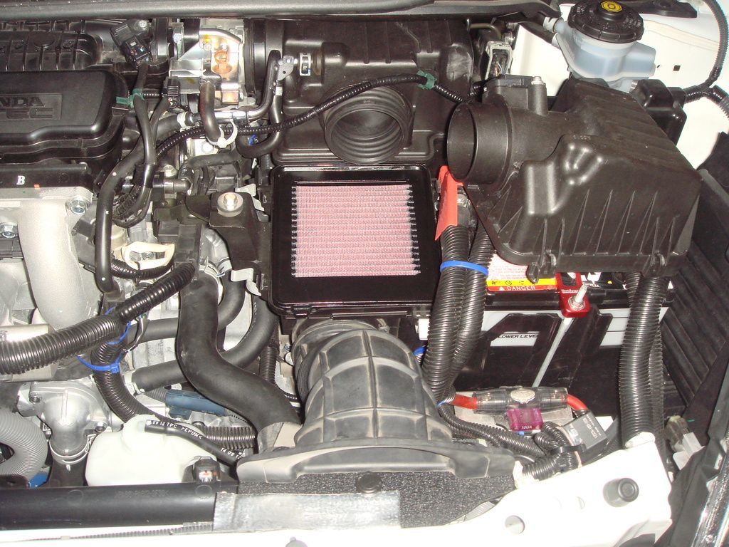

I had tried 6 combination of intakes:
1. Stock Airbox, Stock Air Filter
2. Stock Airbox, K&N Drop In Filter
3. K&N Typhoon Intake Kit (CARB Legal)
4. Honda CR-Z Stock AirBox with Stock CR-Z Air Filter
5. Honda CR-Z Stock AirBox with K&N Drop In Filter
6. Mugen CR-Z AirBox with K&N Drop In Filter
The best of all is of course The Mugen CR-Z AirBox with K&N Drop In Filter and utilizing stock CR-Z Scoop for a true cold air intake system with twice the filtration area of the CR-Z or Honda Fit AirBox and still sound quiet unlike the crazy loud K&N Typhoon.
BUT The best bang for buck is the CR-Z Stock AirBox with K&N Drop In Filter...since it have that CR-Z scoop that collect incoming cold air right behind the front grill, you can buy the parts from Honda Dealer (I bought the CR-Z airbox used from one of the member here but you can find it at low price at Bernardi Honda), its OEM Honda quality!
Here is picture of CR-Z Stock AirBox (cover open) with K&N Drop In Filter (take note on the scoop)
Ah, never considered a CRZ intake, I was just assuming it was identical. I see it has 2 large chambers, do you know what they do? One is for filter obviously, not sure what the other is for
