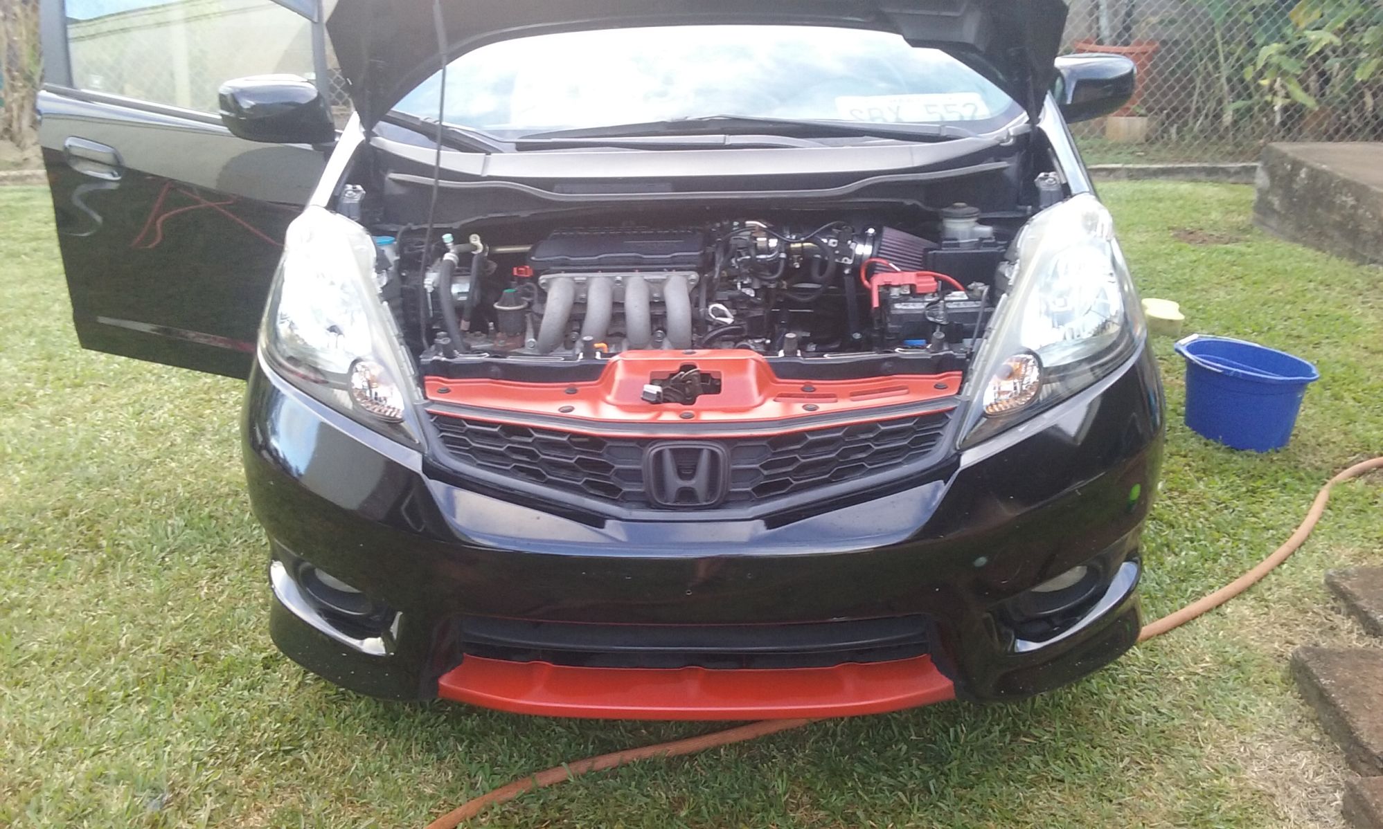

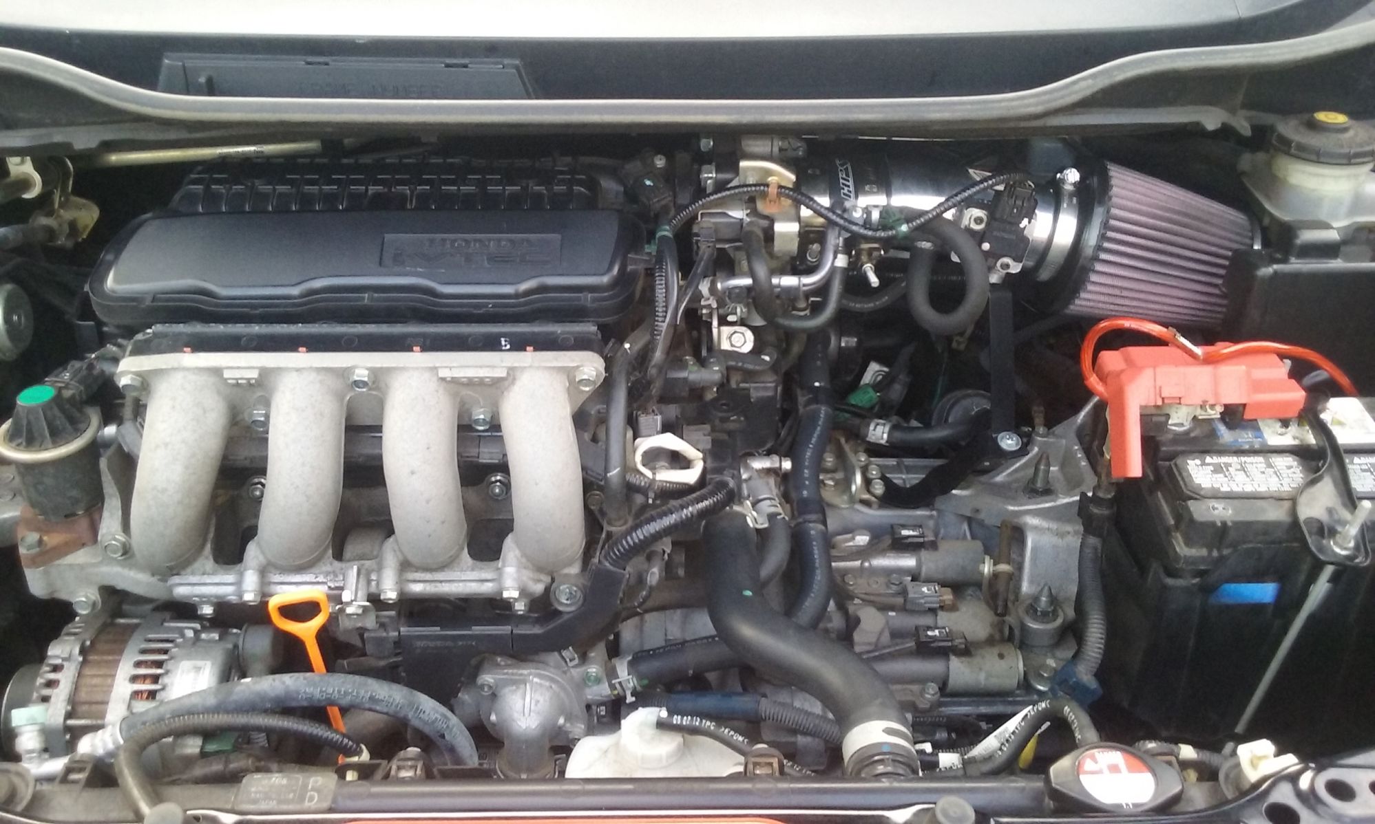

I love this intake! Sounds amazing. Gunna install my custom fit Megan n1 mufler from my old EF civic i sold until I can save up for a tanabe or hks. But this intake was really easy to install . I had to remove the battery to get the stock airbox out. But the install was easy just take out the stock air box put on the coupler and pipe with filter bolt tight and attatch vent hose and mount. I'll post a video of it as soon as I can figure out how to do that put I'll put a few pics in

I could really use this help figuring out what goes where tube wise. The left metal tube being case release I’m guessing I can cap off with a breather but what am I even looking at help?
Did your intake not come with instructions?
Mine did, and it was easy to follow. I'll take a picture sometime this week if you still haven't gotten it installed lol.
