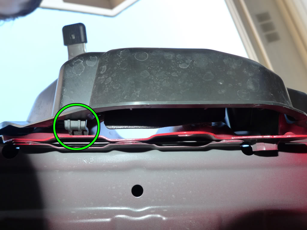

Here is a way to avoid removing the plastic housing surrounding the hood latch. This will save you from damaging those little black clips everyone is talking about.
Just unclip the bottom part of the plastic housing. I have highlighted the area to unclip.
With that unclipped you are able to access the bolt holding the horn in place with an open faced wrench.
