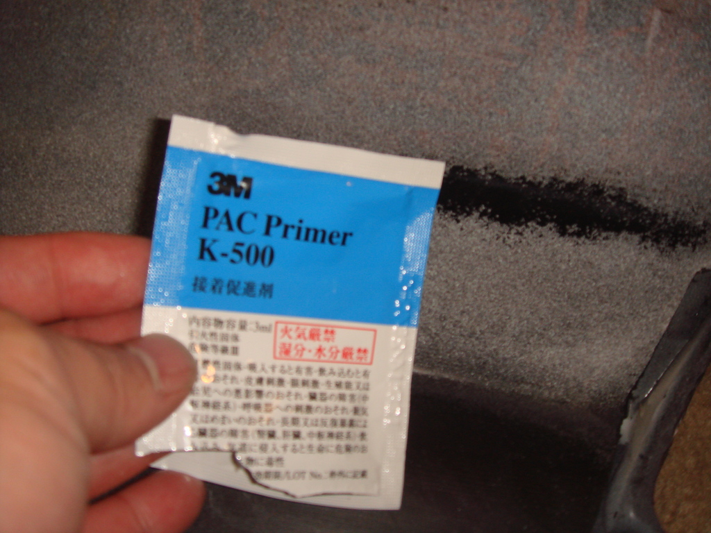

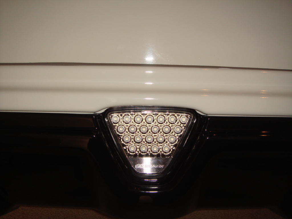

Now, clean the rear mounting surface with the included cleaner,
warning, this cleaner is very strong solvent and should be used
only on unpainted area,

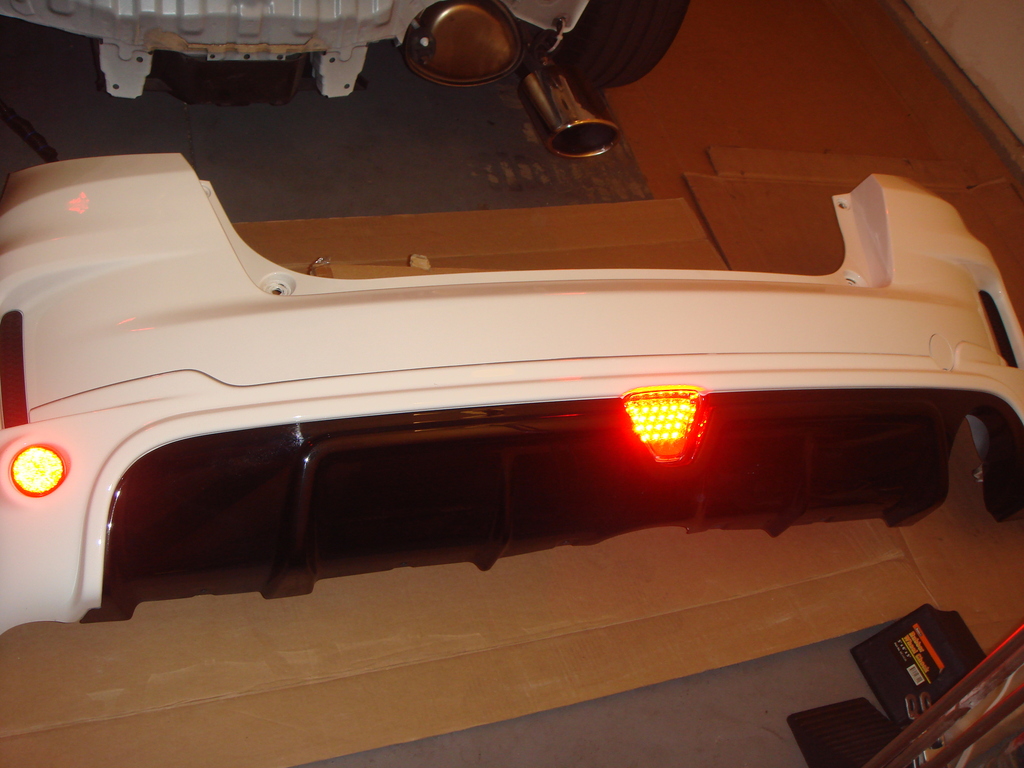

Attached the LED Assy with the double tape that came with it:

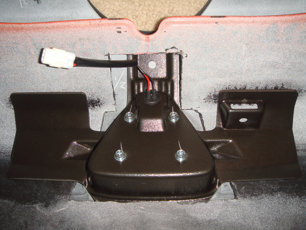

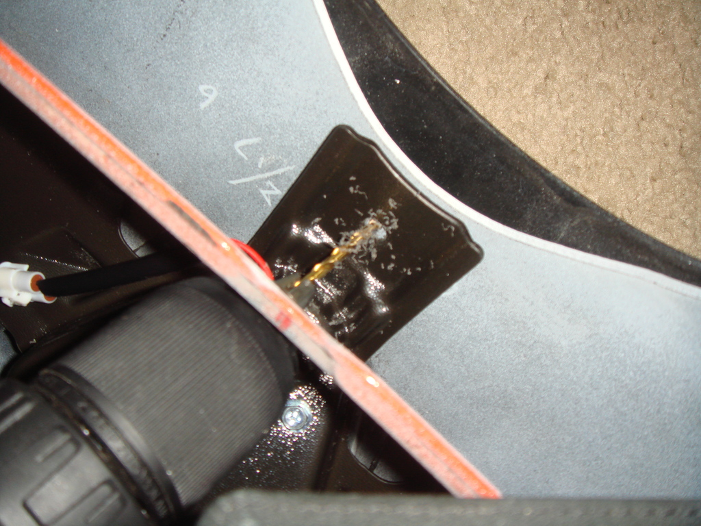

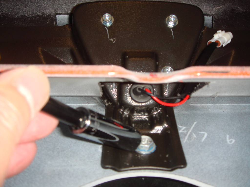

Drill a hole for the single bolt/nut and tighten the nut/bolt:
Check the alignment and adjust if the LED is not perfectly centered:

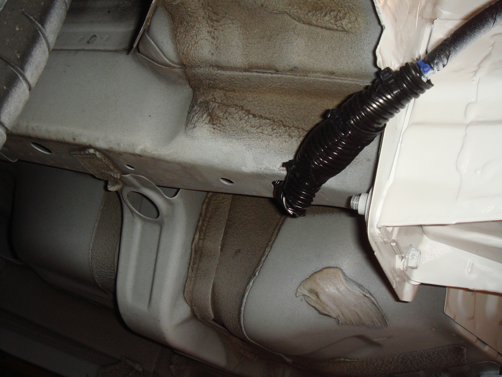

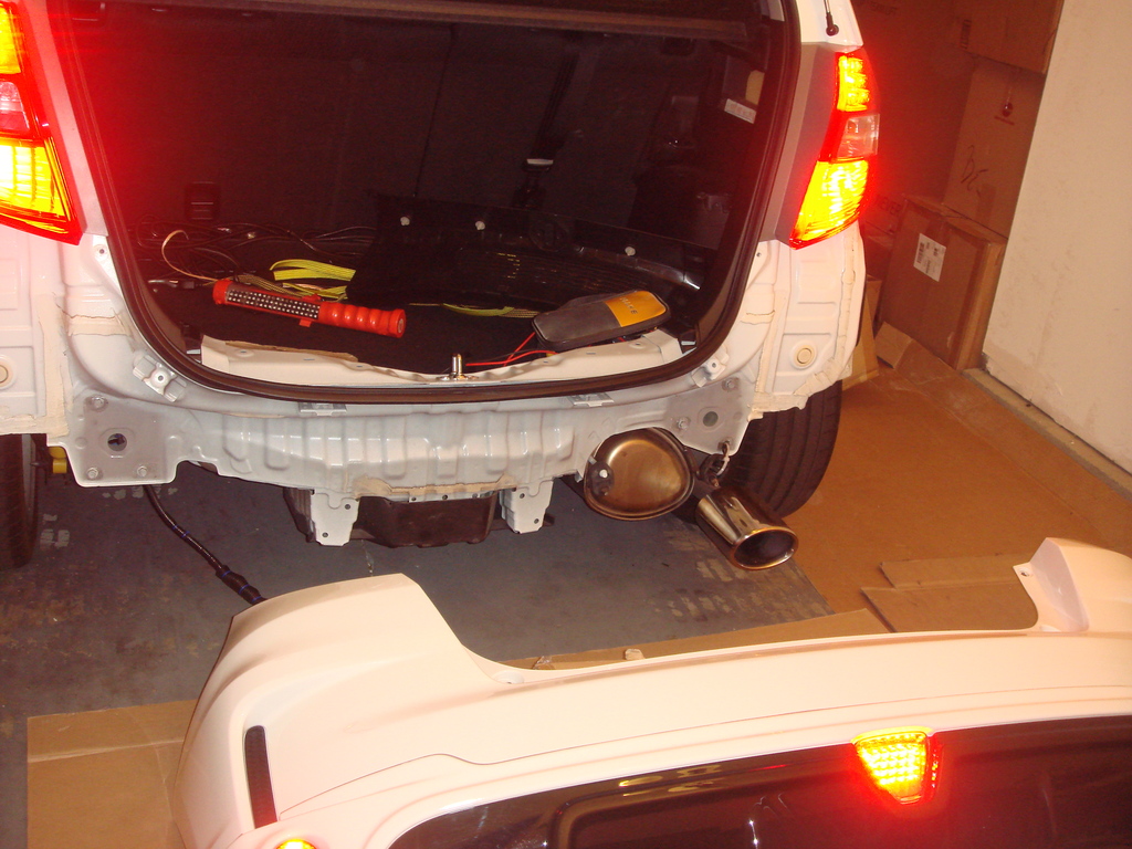

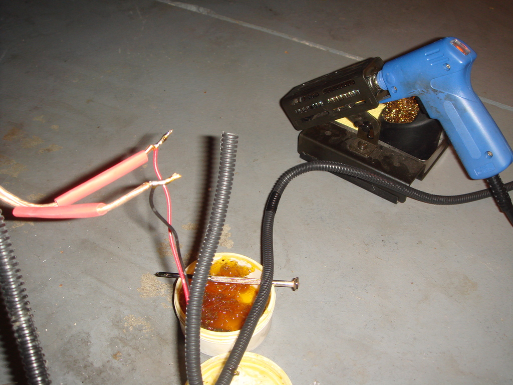

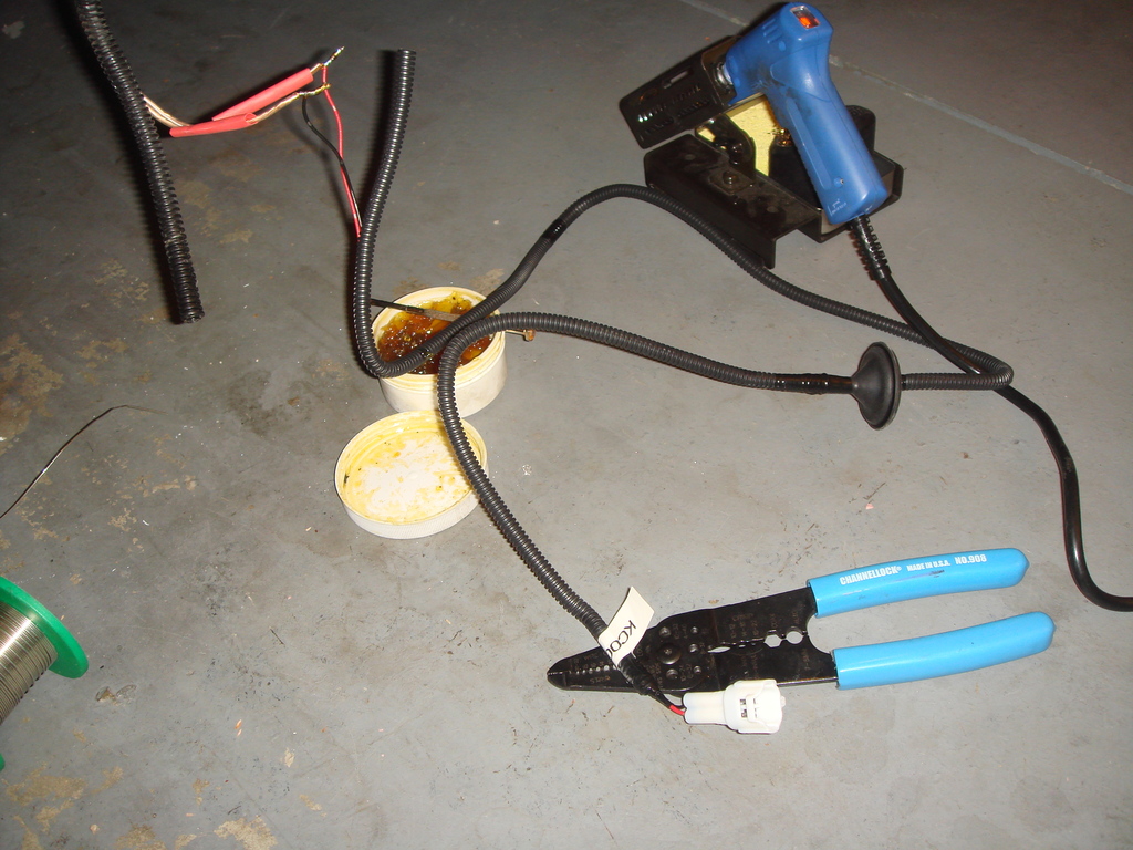

About 2 years ago, I had run a cable from the LEFT Rear Brake Light to
below the trunk floor, in preparation for this LED brake light,
it is amazing that it took me so long before I can afford to do this hahaha...
so now, I just need to cut the Wiring that came with this Mugen LED fog light kit so I can use the water proof plug connection and connect it
with the wire that I had prepared before:
make final connection using PC connector inside the rear left tail light:
Testing Testing:

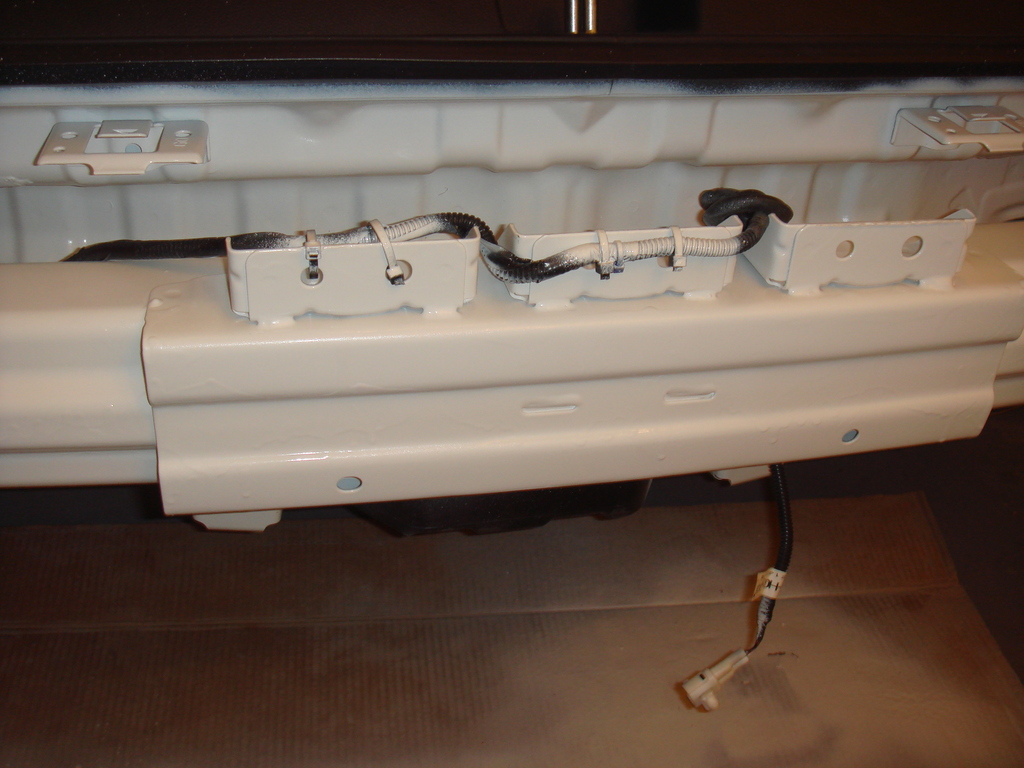

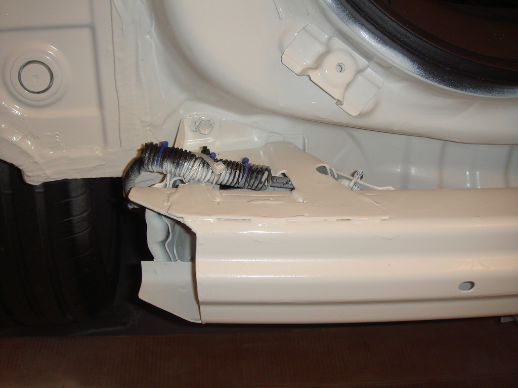

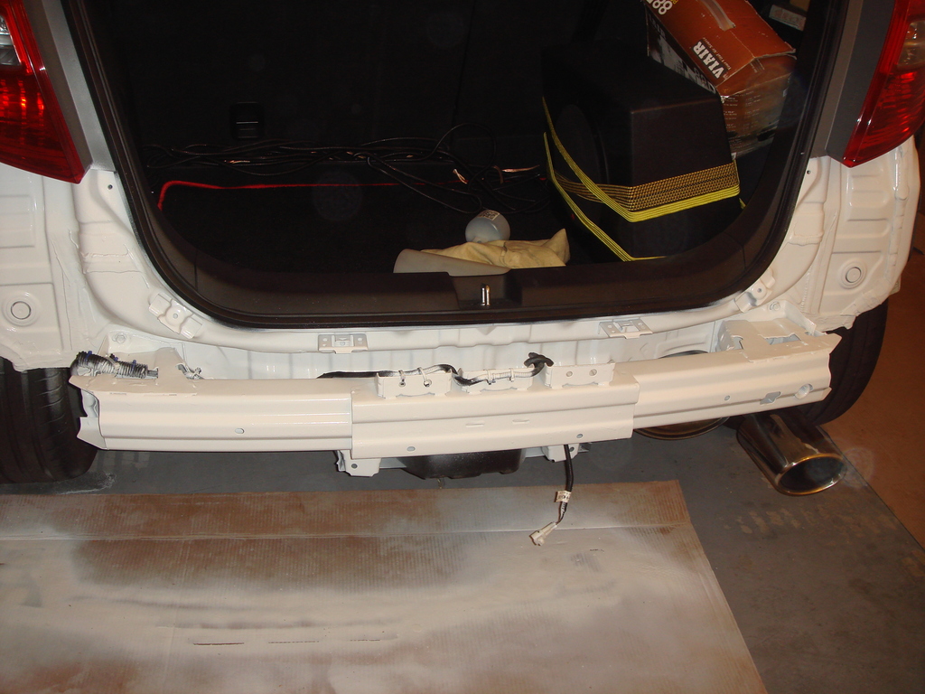

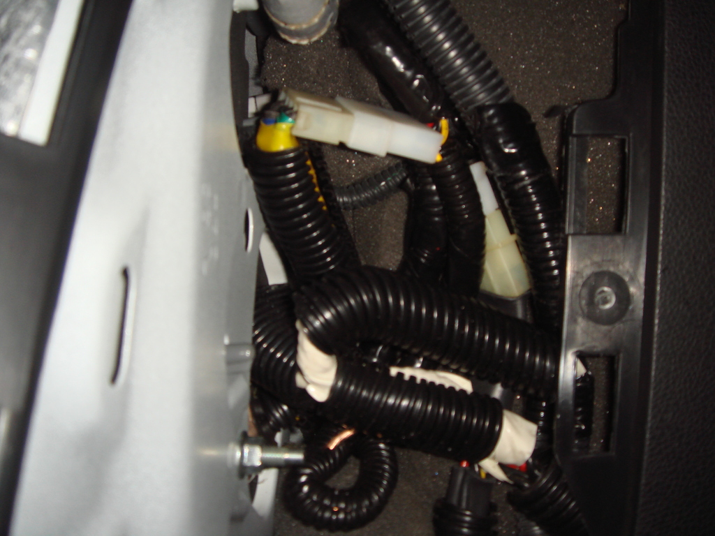

Oh, I also took this chance to Fix the Spot Welding on the Reinforcement Bar that were not properly weld by the body shop that did my JDM Fit RS
Bumper conversion 2.5 years ago,
I also Primer and Paint the reinforcement bar again since the old welding
were covered with rust !!!
then I run the wiring to make sure they are secure:
The connector that is dangling is the water proof connector that came
with this kit and in final step it will CLICK on to a mounting hole on the
housing of the LED foglight, I must say that Mugen really pay attention
to the last detail !!!

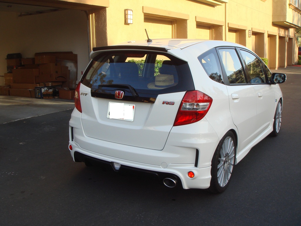

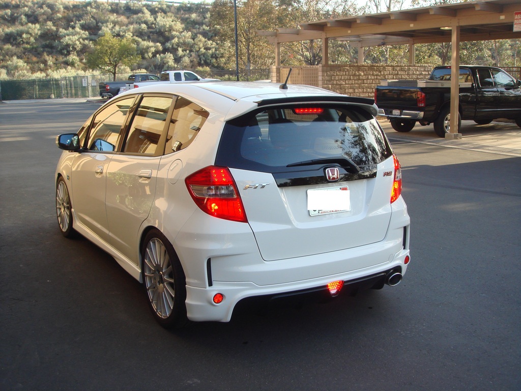

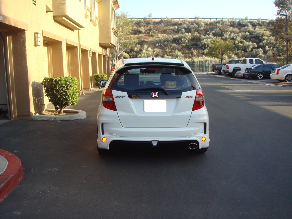

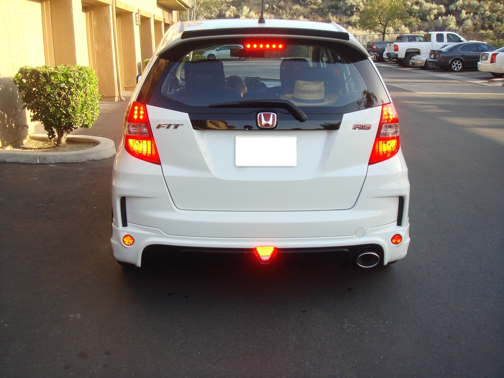

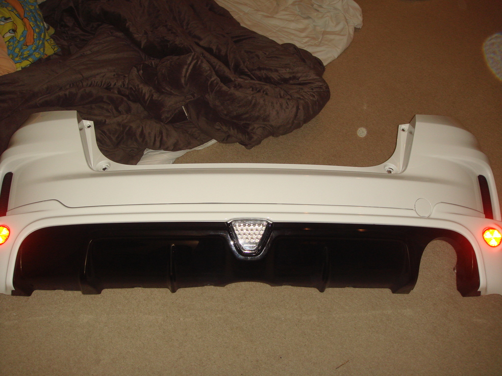

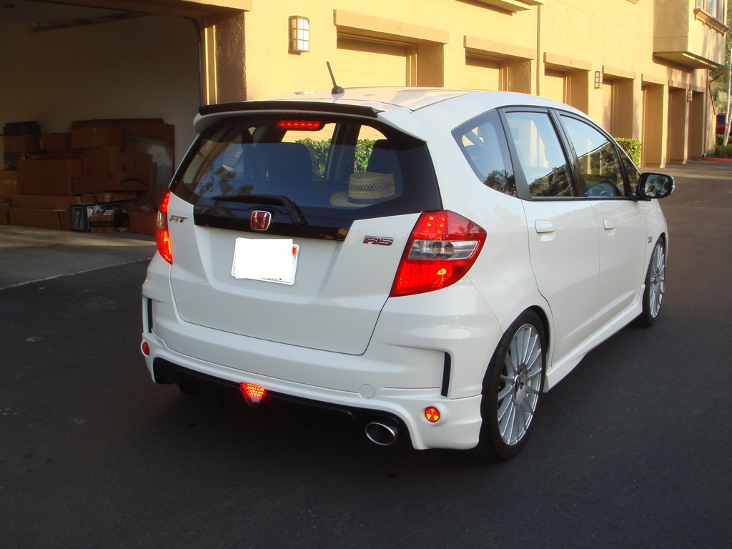

Finished Product
Now, I can finally say, the back side is done and perfect for me
Please NOTE that the 2 Round RED Reflector on both side of the Mugen Under Spoiler do NOT have any light, the reason why they look like they
have light is because I use Flash Light from my camera when I took this picture !!!
