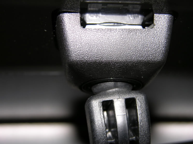

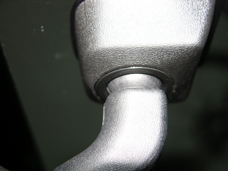

I recently got a auto dimming mirror for my '09 fit sport. I can't seem to figure out how to remove the mirror(well i can i just don't want to break anything) correctly. So my first question is how do you remove the mirror without breaking anything? Also, which wire do i tap into for power for the mirror?

Insert a small screwdriver in the slots on either side to release the tabs then pull towards rear.
No wires up there so you may have to snake one back to the dome light might work?

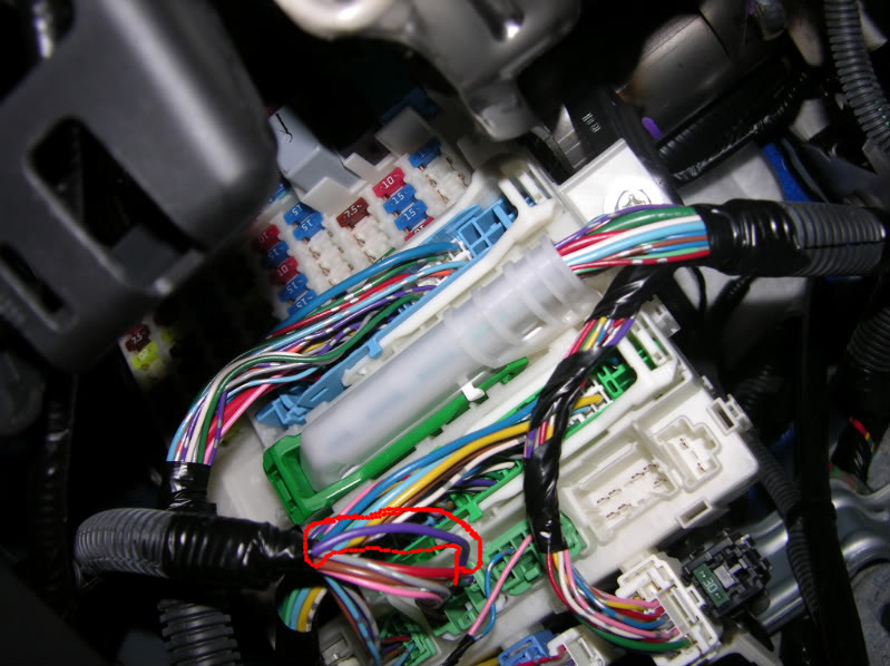

Thanks for the help, between your advice and a diy if figured it out without breaking anything ! I still have to wire it up though. Is the solid purple wire(outlined in red in the pic) the right wire to tap into for switched power?

The purple wire from what I can determine is the wire for accessory outlet so should give you constant power.
You may want to check other strings to confirm this before blowing anything up.

Well the diy Here says that the purple wire is an ignition powered wire, so it should work.

Looks like it.

Well according to the diy the pink wire is constant power(That could run the battery down!), I just need switched for the mirror. I helped my friend install angel eyes on his bmw about a year ago. No issues except running to walmart at midnight to get connectors to wire it to the lights.

I know I'm late to the party, but I just picked up my Fit two weeks ago. I installed the GenK50A today. It was fairly straightforward, until I decided to confirm the above DIY with a multimeter. It turns out the pink and purple wires are the correct ones for constant and switched power, respectively. I was a little perplexed, because the power doesn't hit the purple wire until you turn the key to the "on" position, and it stays there after you turn the key off until you do some combination of removing the key and opening the driver's door. I can't tell you the exact sequence, because I didn't take the time to figure it out.
