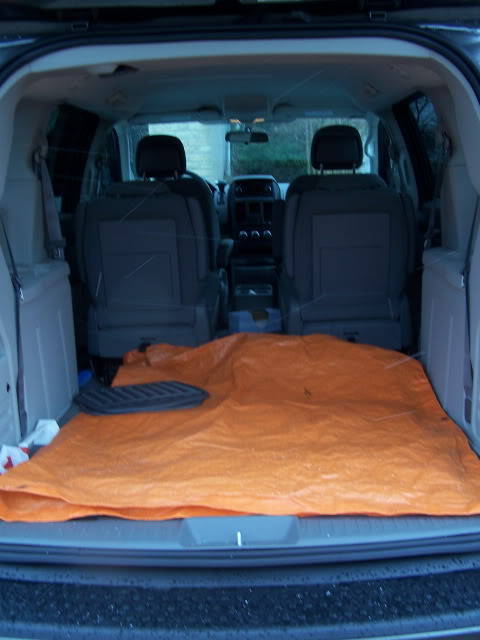

a piece of cake. If I need more just fold the second row into the floor. A couple weeks ago I hauled a 4 x 8 sheet of drywall for neighbour.
p.s. regardless of what car you drive throw a cheap plastic tarp in the trunk. Well save some nasty spill clean up.
