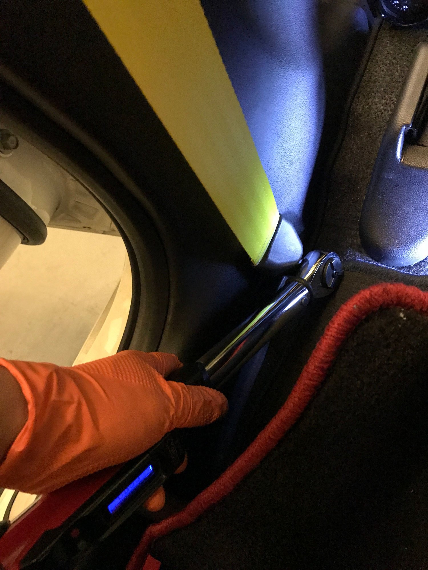

install the LOWER Big Bolt that hold the Front Seat Belt housing unit
and tighten it to 32nm with torque wrench

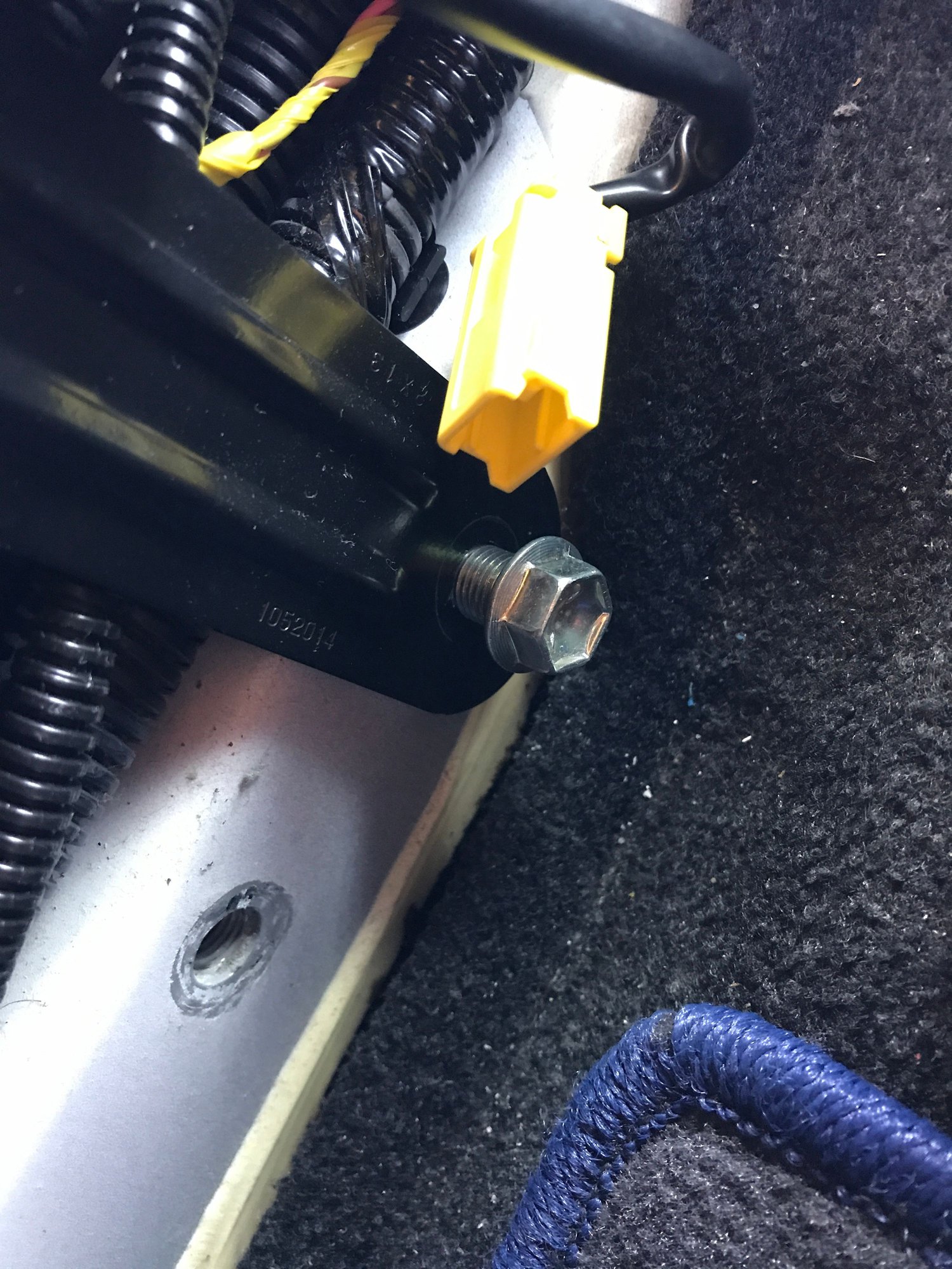

then install the smaller bolt on the top part of the seat belt unit
and tighten it to 4nm with torque wrench:

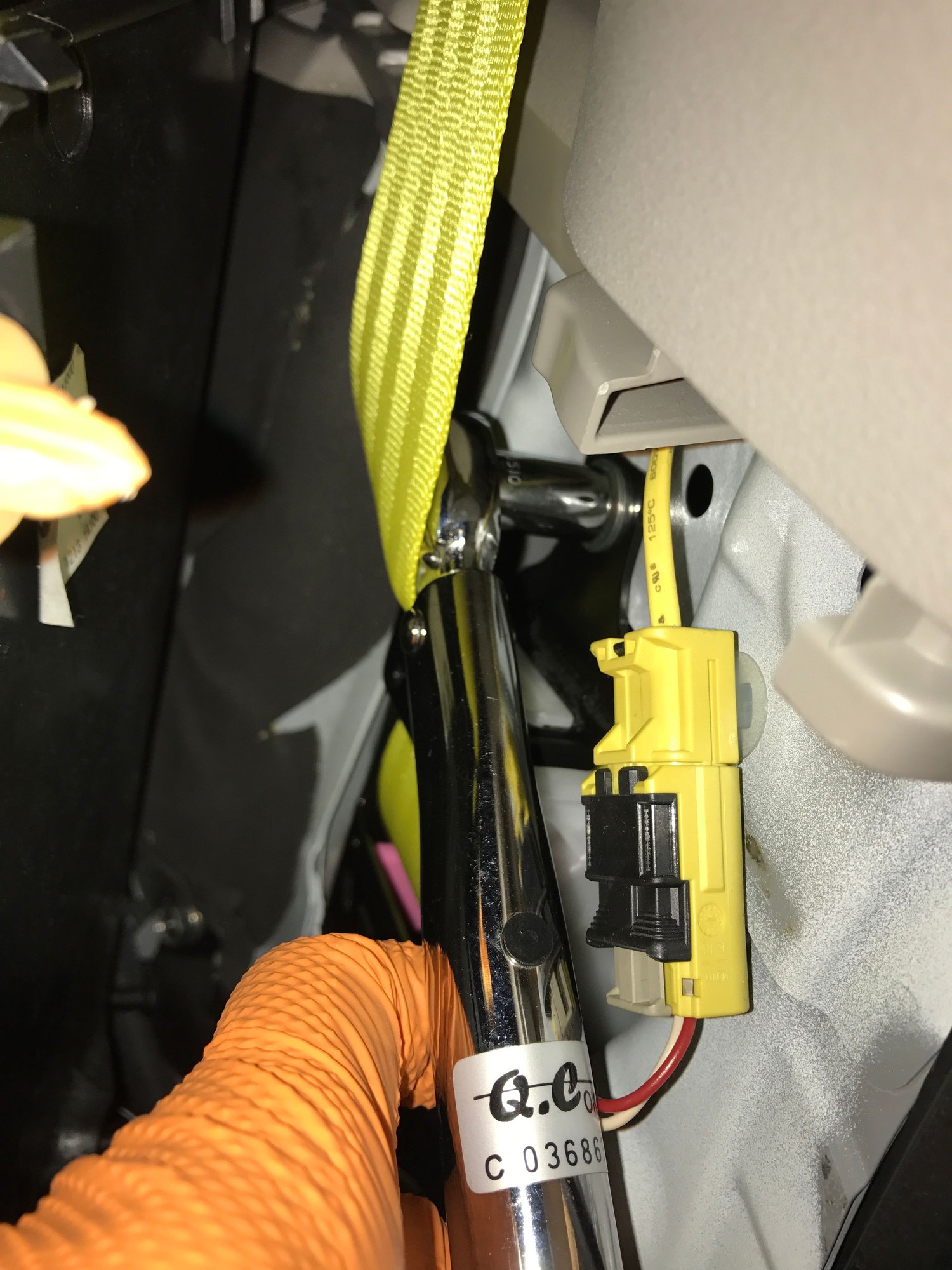

Reconnect the SRS wiring (yellow socket):

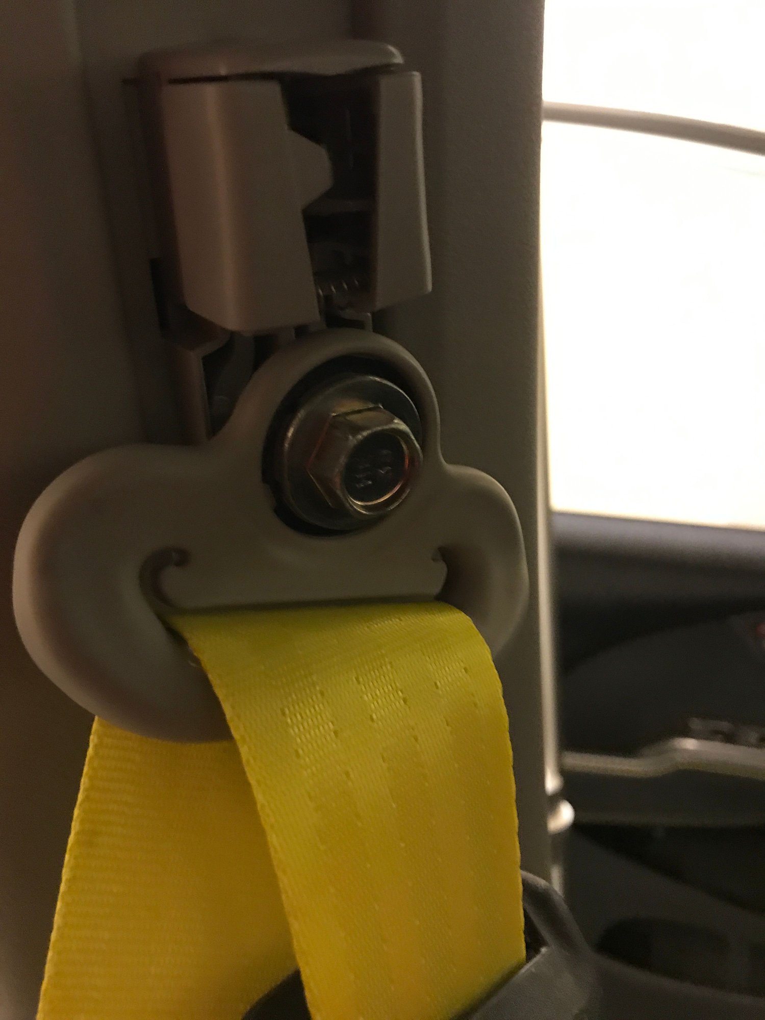

Now install the Height Adjustment Attachment,
again using Loctite and 32nm torque wrench:

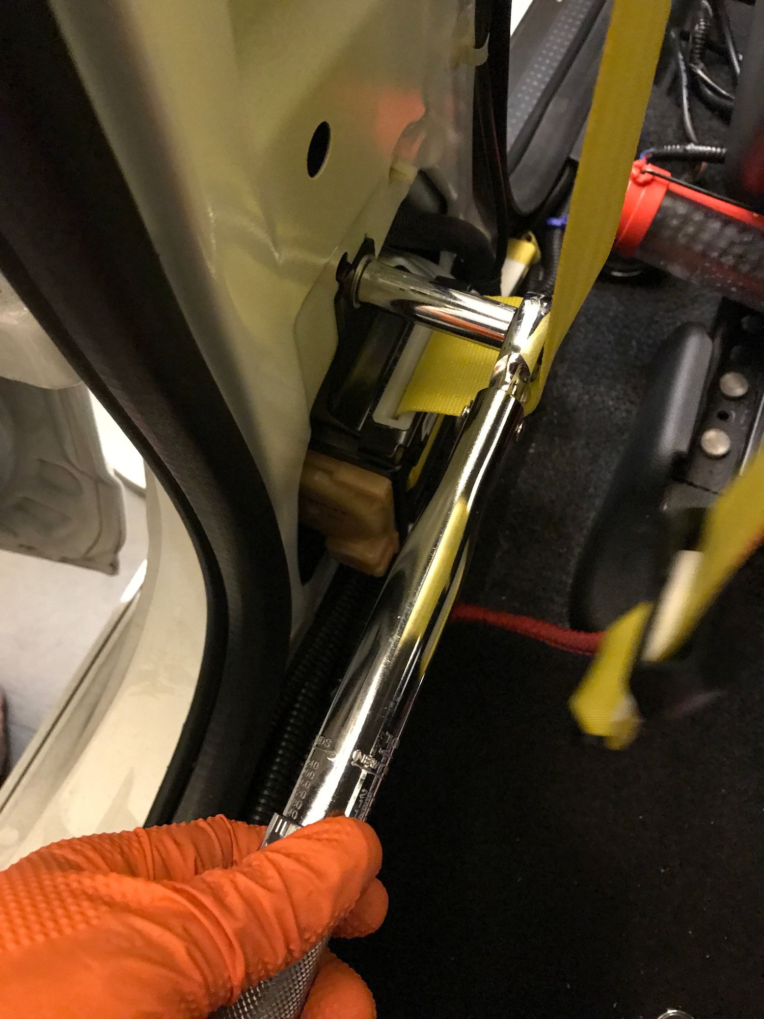

Finally you can install the lower final anchor bolt,
as usual Loctite Blue and 32nm Torque also
notice the arrangement of the washer/spacer on the botl:

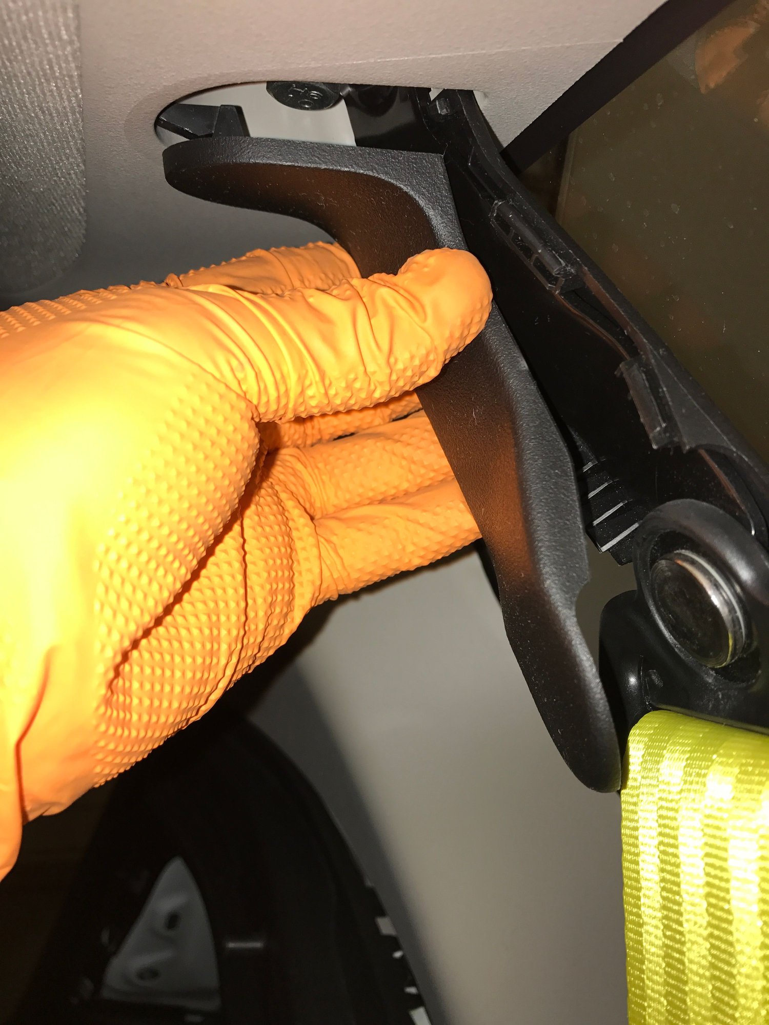

This is the TOP anchor (to the ceiling),
notice the spacer position on the bolt:
