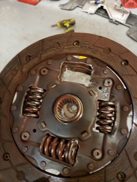

an end to the story
At the very end the clutch really decided not to work. Pedal was useless and could only push (gravity nudge) start the car in gear, and clutch-less revmatch up and down shift (1st-2nd was a bitch to learn)
Exedy OEM is going in, even though I still think maybe I should have gotten a sturdier clutch

RIP. I think thats exactly what happened to my clutch. (dont remember if it was diaphragm or plate springs that failed, had to have a shop do mine)
with the new one i wanted to go sturdier, and get a lighter flywheel. the lag in RPM drop when you shift drives me crazy. but also just went OEM because I already lost days of work :/
the dream is to keep the fit around for a while longer and do a swap when my kids get old enough to help, so something sturdier is definitely going in next time!
