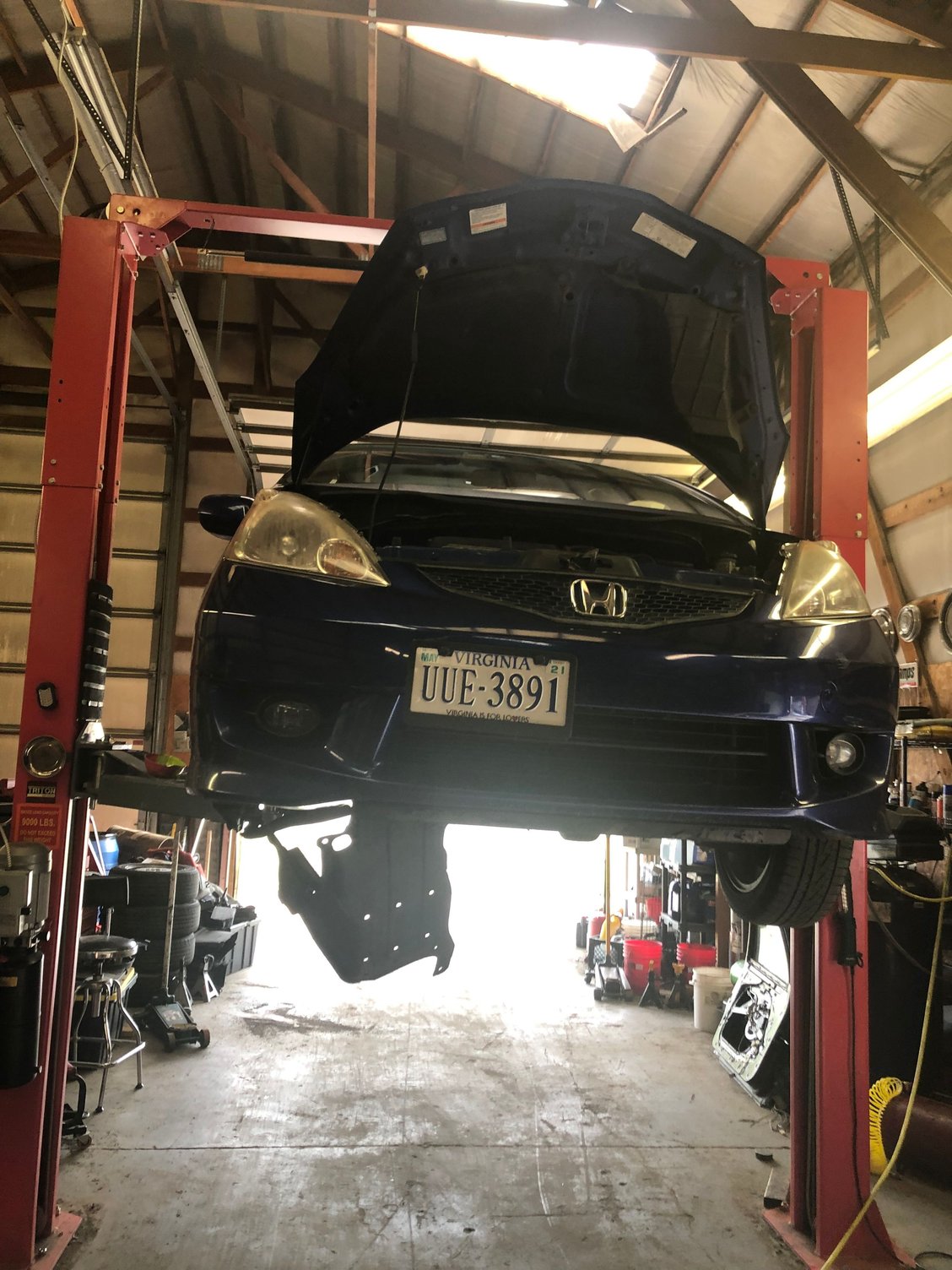

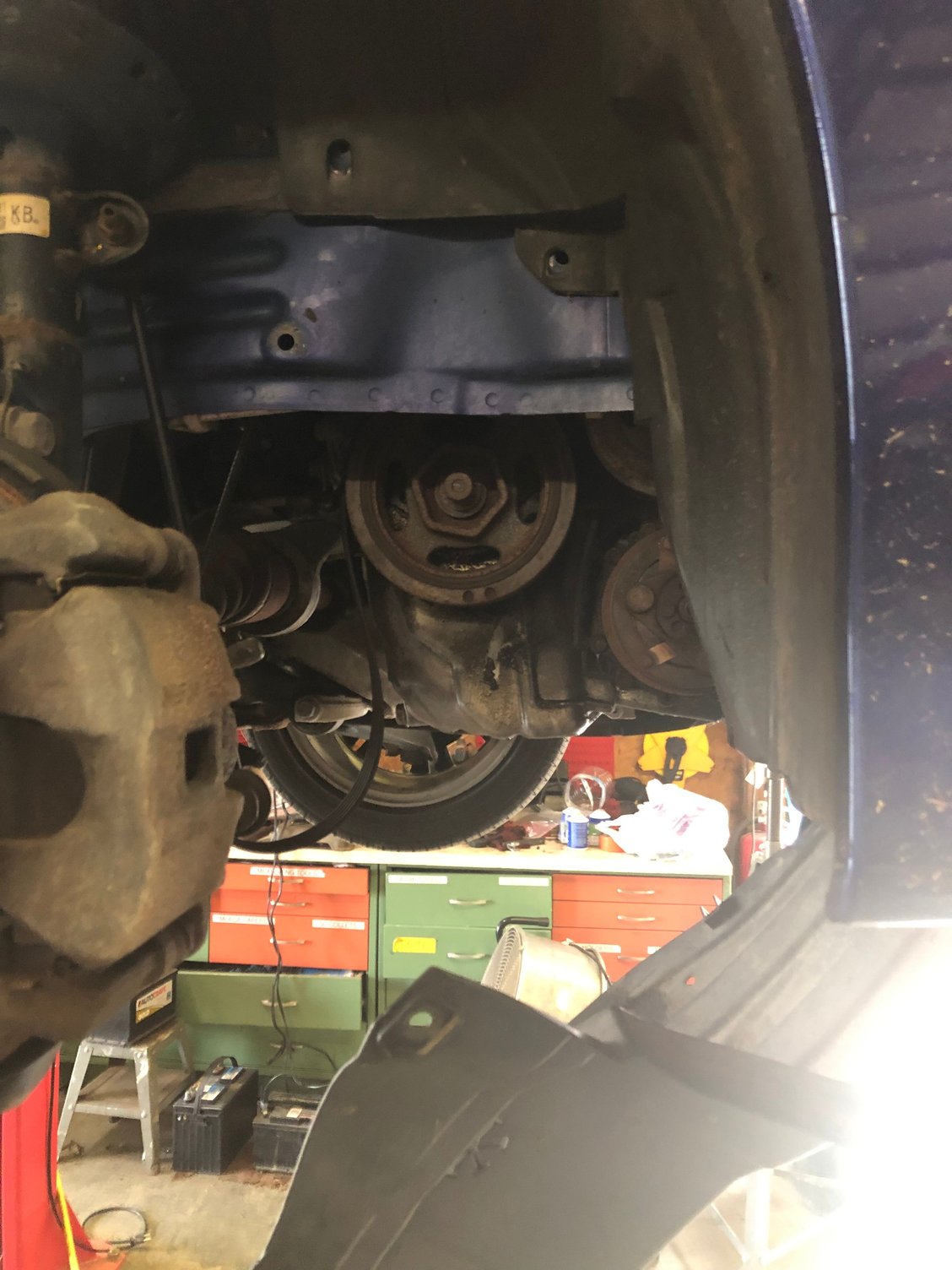

Ended up just replacing the pulley ( bearing is pressed into the pulley )
Some tips
- buy extra snap rings , I managed to make mine work, but they should be considered single use .
- pay attention to the gap between the pulley and clutch , spec is .035-.065 mm . Have a feeler gauge before you start . This was my issue I thing I hammered the pulley on a hair too much and the clutch would not engage. I ended up taking out the shim and just got it to minimum spec .
- I did not have a clutch tool to hold the clutch while removing the nut. Air impact wrench spun it off fine 14mm with a wobble extension . Used oil filter wrench to tighten it back on .
