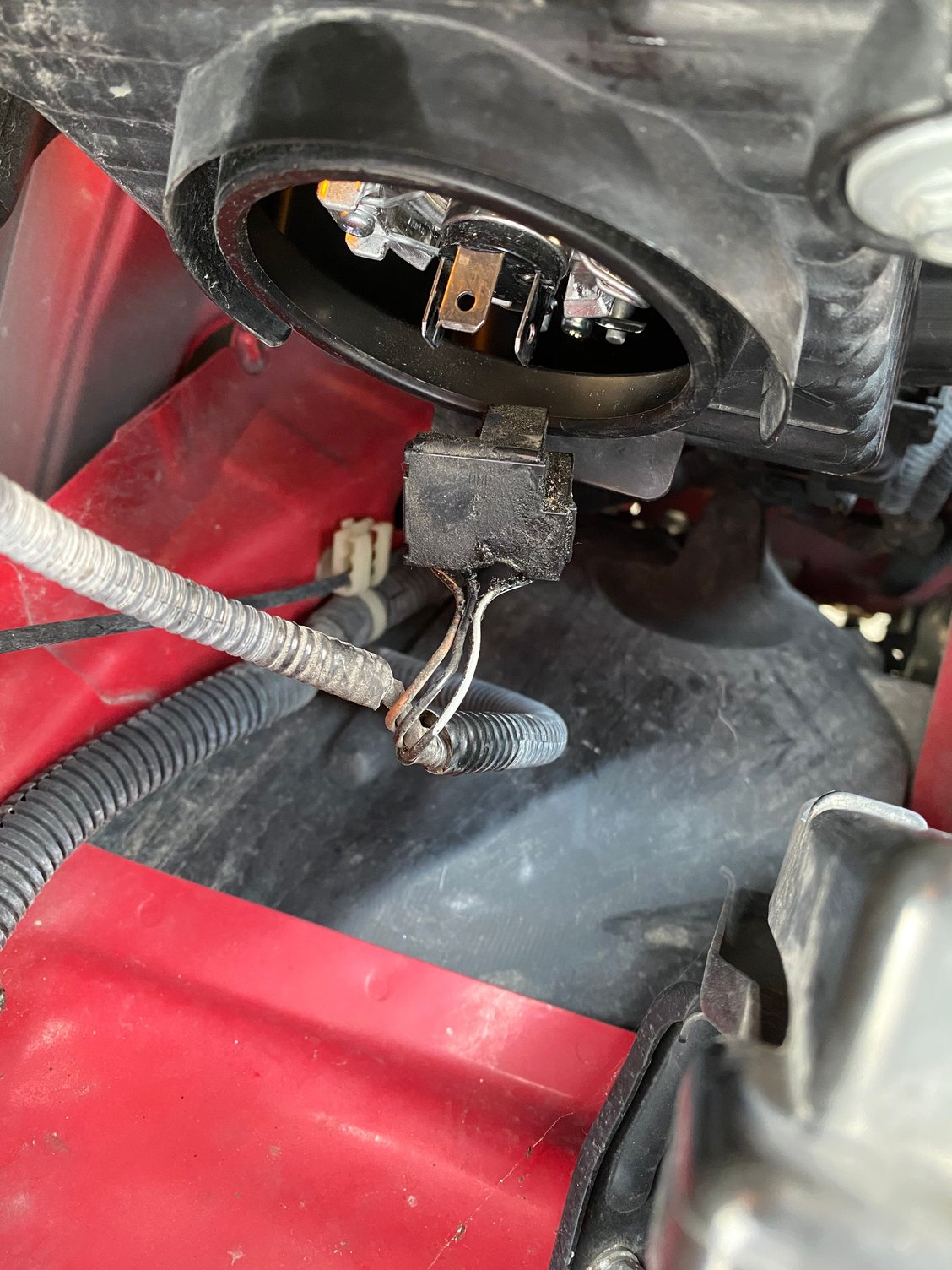

Hey guys! My mom had an 09 fit sport 5 speed for 7 years and she just got a CRV so I bought the fit from her. Its been a great car for her and has 240,000 miles on it already. Recently the headlights have been wiggly while driving so today I checked it out and if I grab the connector going to the headlight bulb, I can move the whole bulb assembly up and down on both headlights. I'm just checking to make sure this is not normal before getting new headlights. Thanks!

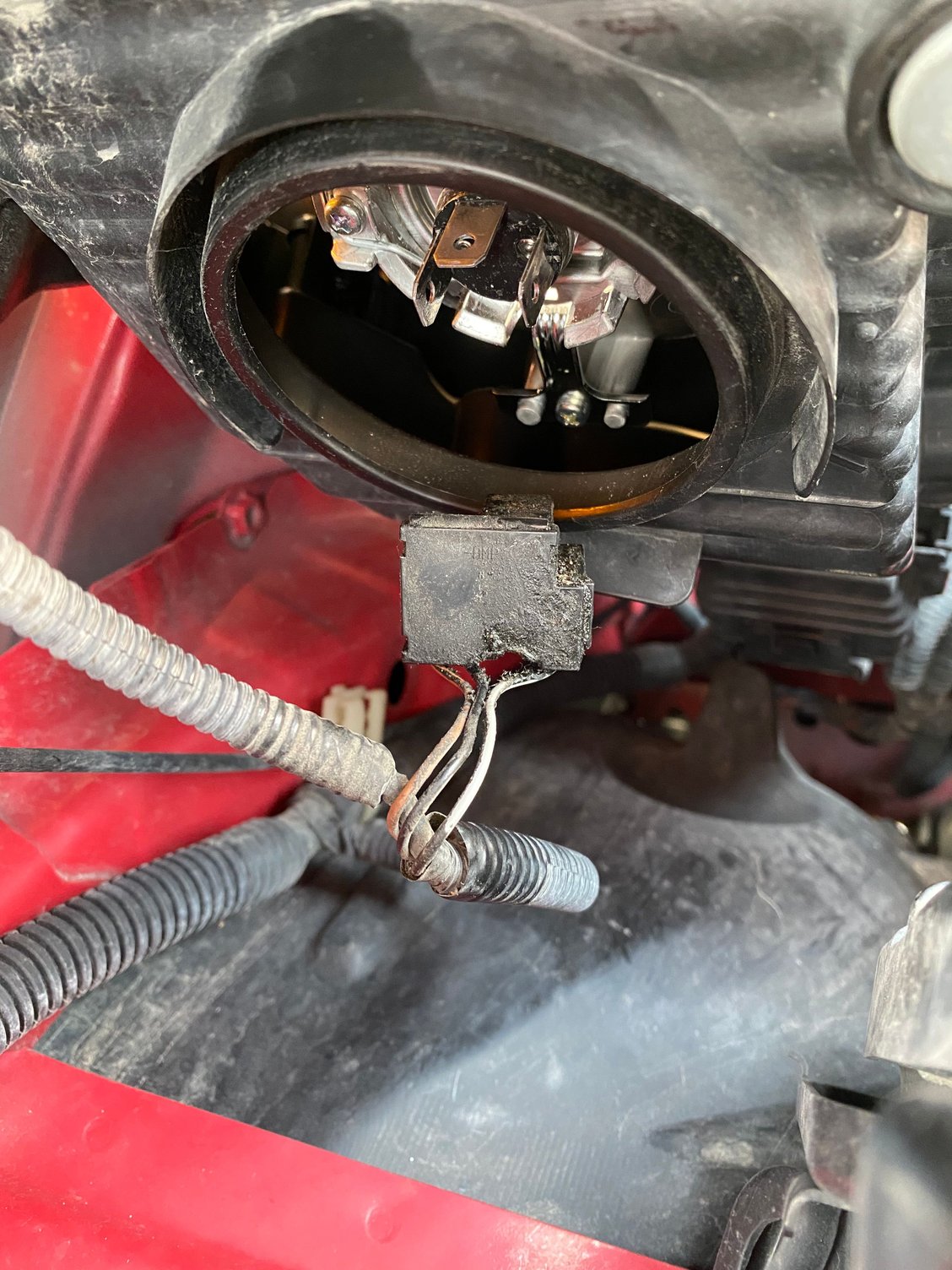

here’s some photos of what I mean, that whole thing just moves up and down

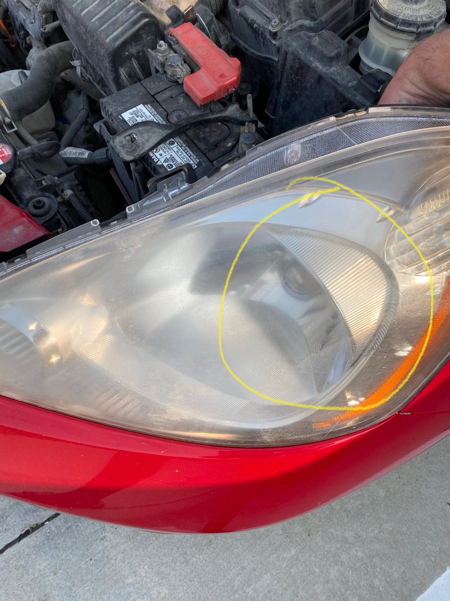

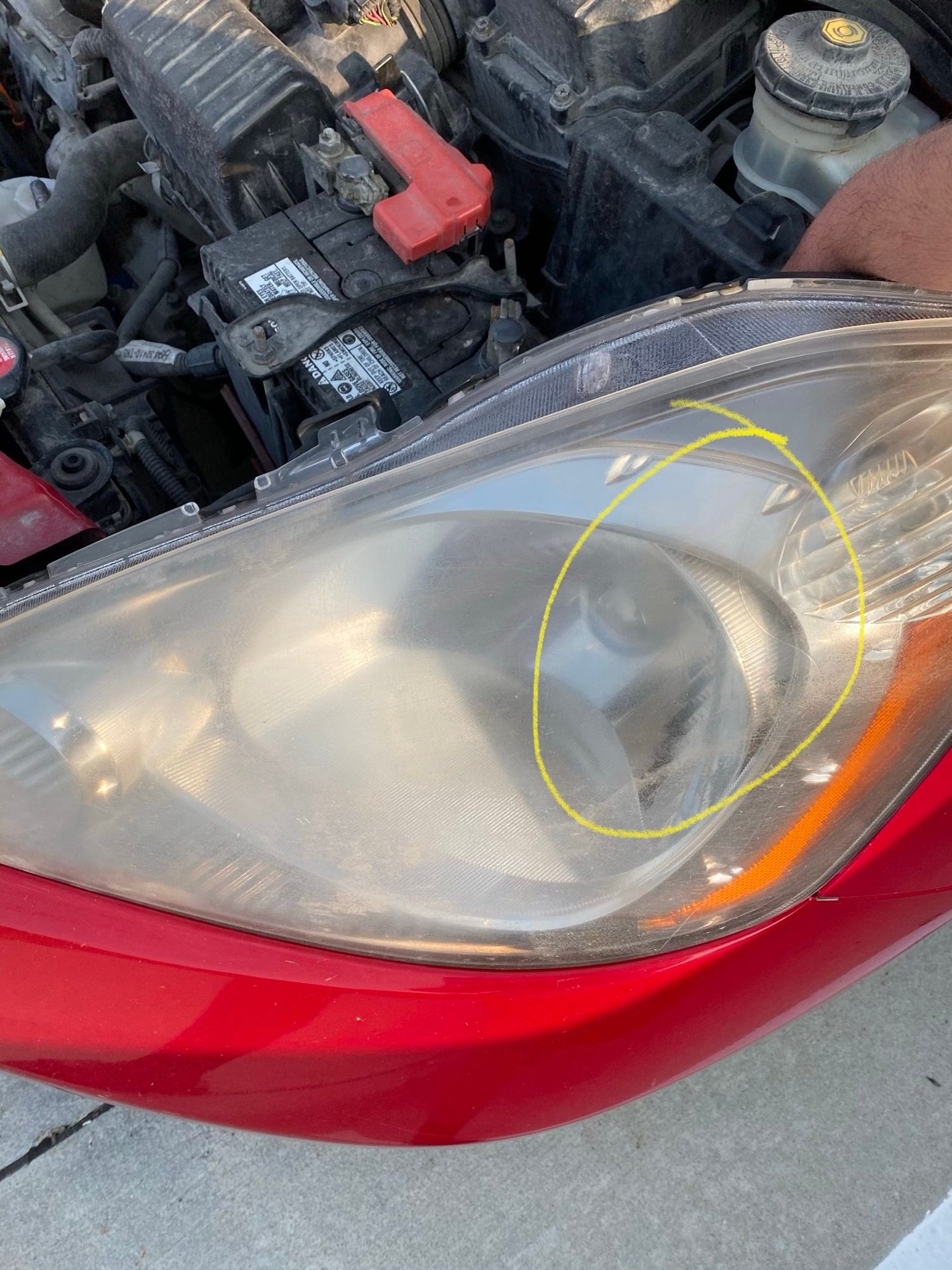

Old Sep 20, 2020 | 06:23 PM

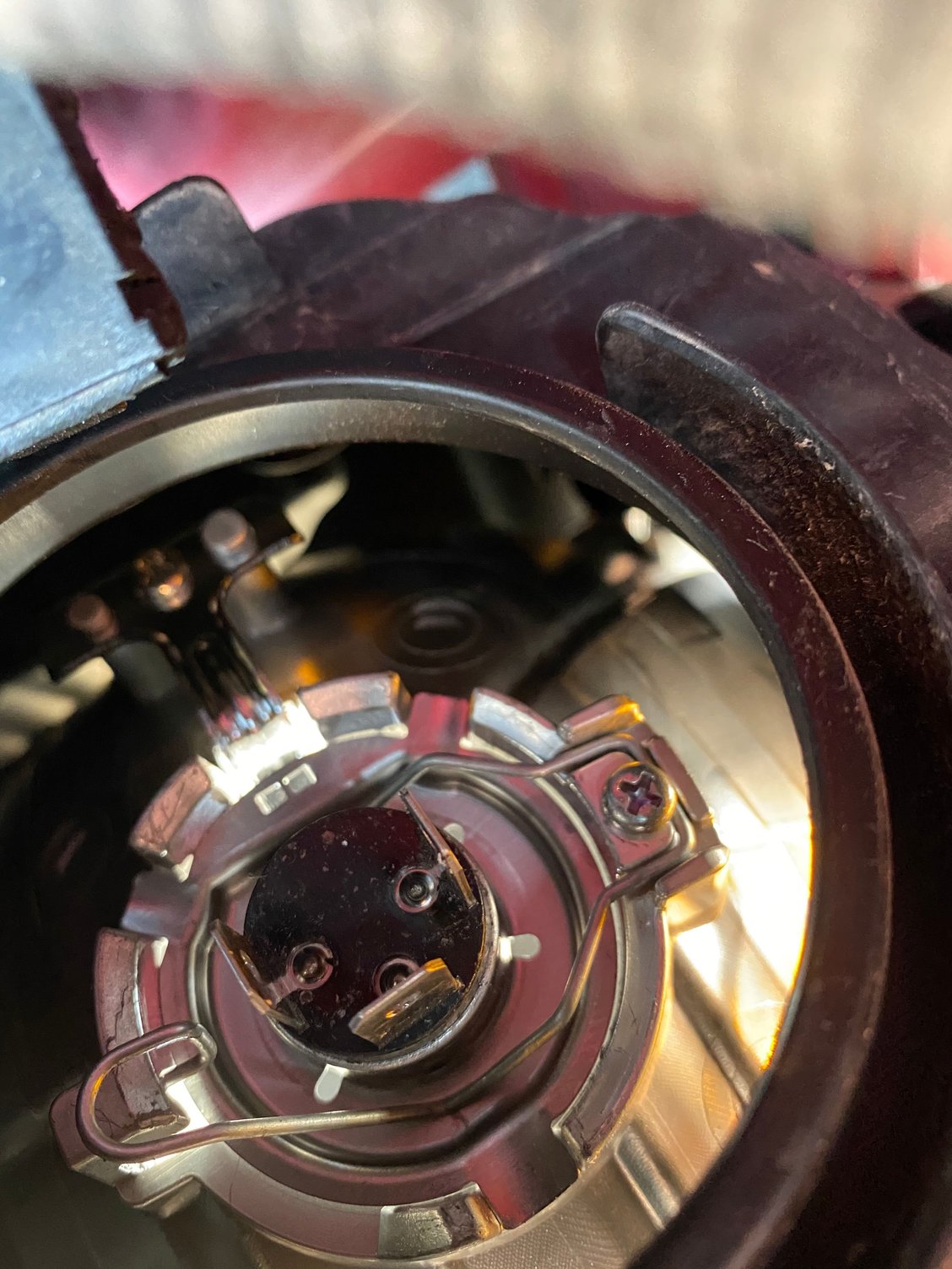

Back of the bulb

That all looks solid. If the bulb is broken such that the metal plate part is loose, its just a new bulb and that’s relatively cheap. If the bulb is solid, could it be the headlight adjustment screw/worm gear have worn out?
Sucks if this is a headlight replacement cost goes up a bit if it is.
Maybe it’s something like this video (different car)
I’m hoping you find what it is, and you end up having a cheap problem rather than the more costly one.

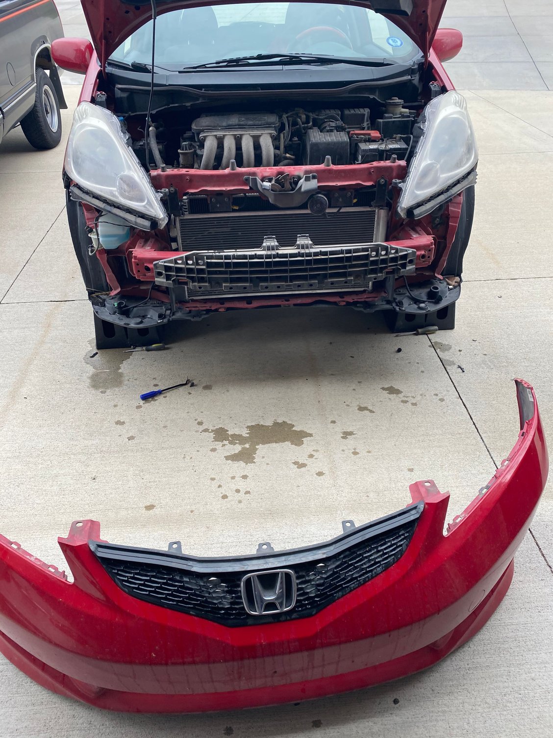

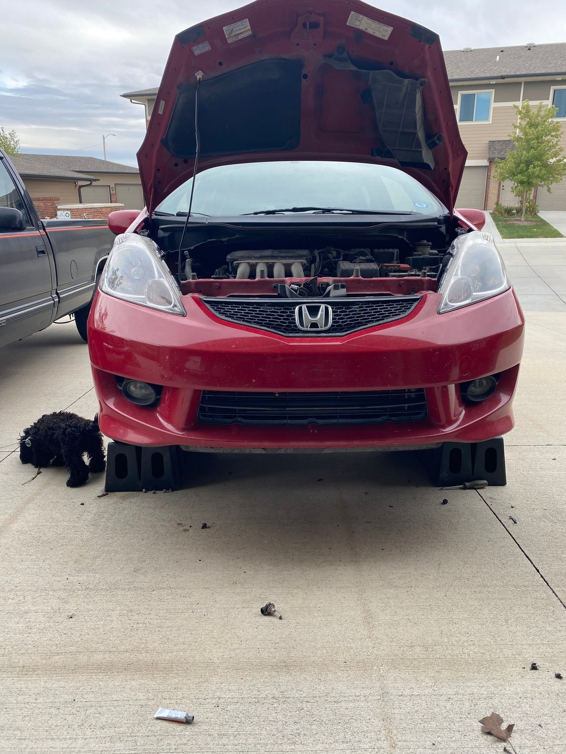

Big day for the Fit! After I had the old ones out, I looked them over a lot and discovered that the adjustment screw that was mentioned earlier was stripped out on both headlights causing the housing to move around freely... not a great design
