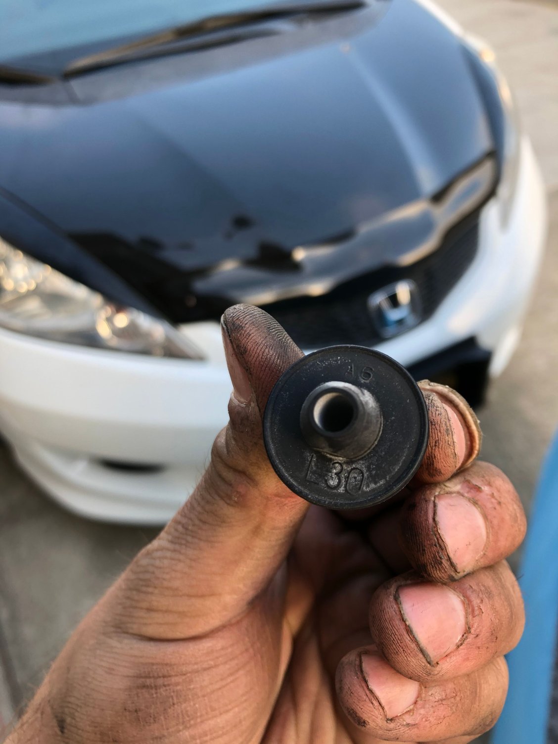

Here’s the part in question, it fell onto the ground while I was taking the cowl and the surrounding parts off for a valve adjustment and spark plug check. No idea what it is or where it goes, so I wanted to reach out the community to see if you guys had any insight.

It's a hood bumper. Look at your radiator support. You should still have one in place on one side of the support.

Awesome! Thank you for the quick identification! I appreciate the help.
