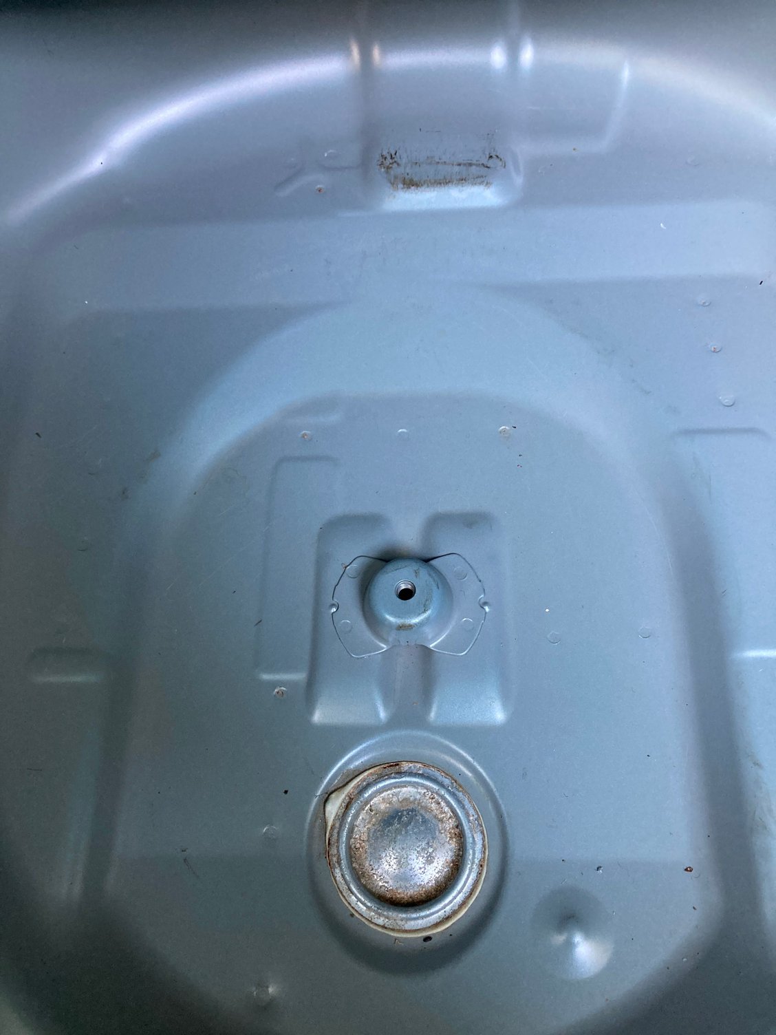

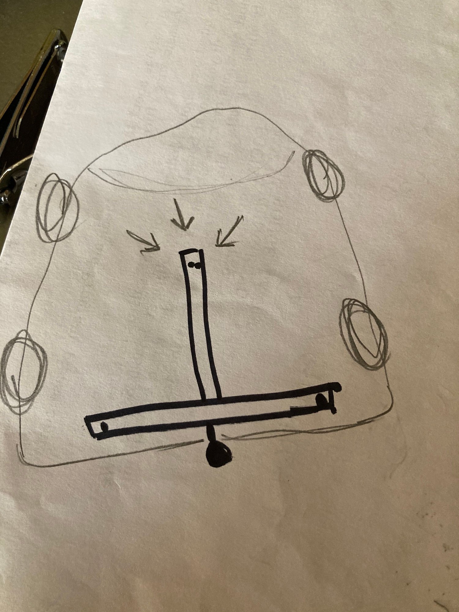

My Fit is a manual transmission. I tow a small utility trailer rarely, but mostly I use it for a bike rack. Lately Ive noticed some fore aft rocking movement when I'm driving. Its secure in its bolt holes. And a squeak. I've gotten under the car and checked all my bolts. Everything is tight as it should be. BUT...where the forward most connector is bolted to the car body, it seems that section has loosened by either metal fatigue, or possible a factory weld coming loose.
This is a hand drawing. It's that long extension that goes forward. I'm wondering if I can go to a good welding shop and have that spot reinforced.
Any suggestions welcome. Thanks

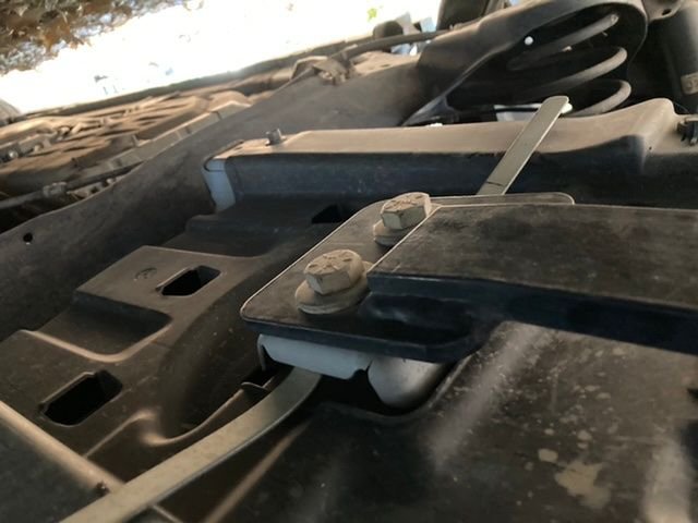

This is a photo of it under the car

I'd suggest finding the place where the actual problem i.e. crack is. Then it is easier to make right decisions about how to fix it.
I'm unfamiliar with your type of hitch...I just posted yesterday about the Draw-Tite brand and it uses just four holes in the frame for mounting.
The thin straps that you show in the pic... are used to locate the front attachment...I think. (some trim the ends off after installation. (Might be good that yours aren't..if you have to remove it and re-install)
The strap I was mentioning, is used only when using the bike hitch. It's attached one end to the bike carrier and the other to the car.
If you didn't get one of those...your carrier doesn't require one.
I would loosen all the bolts and see if you can spot anything that doesn't look good...esp under the front bolts.
