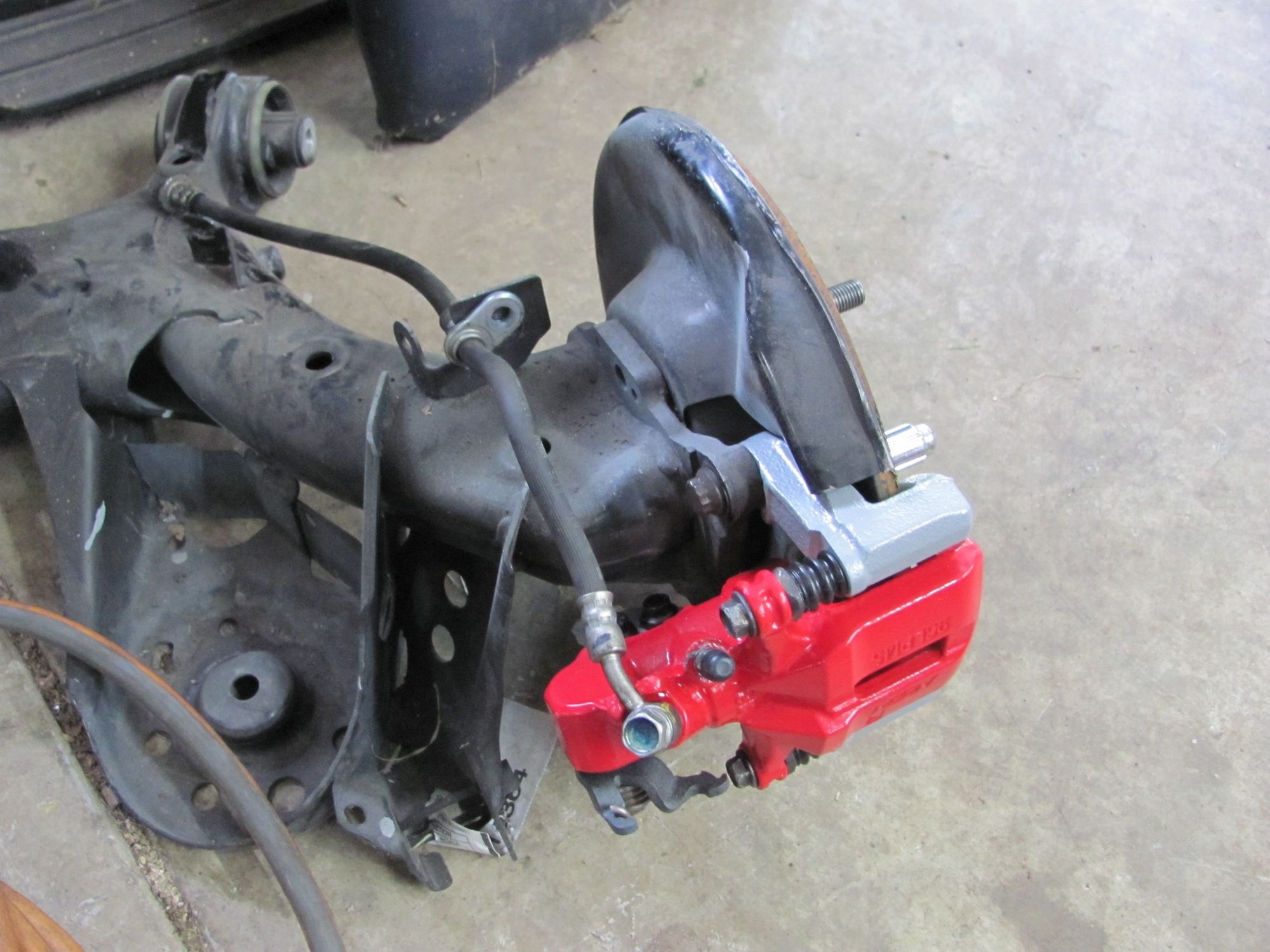

I used a CRZ rear suspension.
If I was to re-do it, I would have simply used the existing brake line routing. At the time I wanted the car to be symmetric so I opted to change the hose routing. Today I wouldn't do that. I'd just weld the brackets to the CRZ U beam, mod the brake lines on the U-beam leaving the fit body and hose routing as stock.
It's always easier the second time.
It's been a couple years. The mod was completely worth it. Every time I walk towards it and see the red calipers peeking out, I'm satisfied. I still want to engine swap it but, the right engine just hasn't fallen into my hands. I'm leaning toward L15B turbo because the K swap requires cutting into the body.
