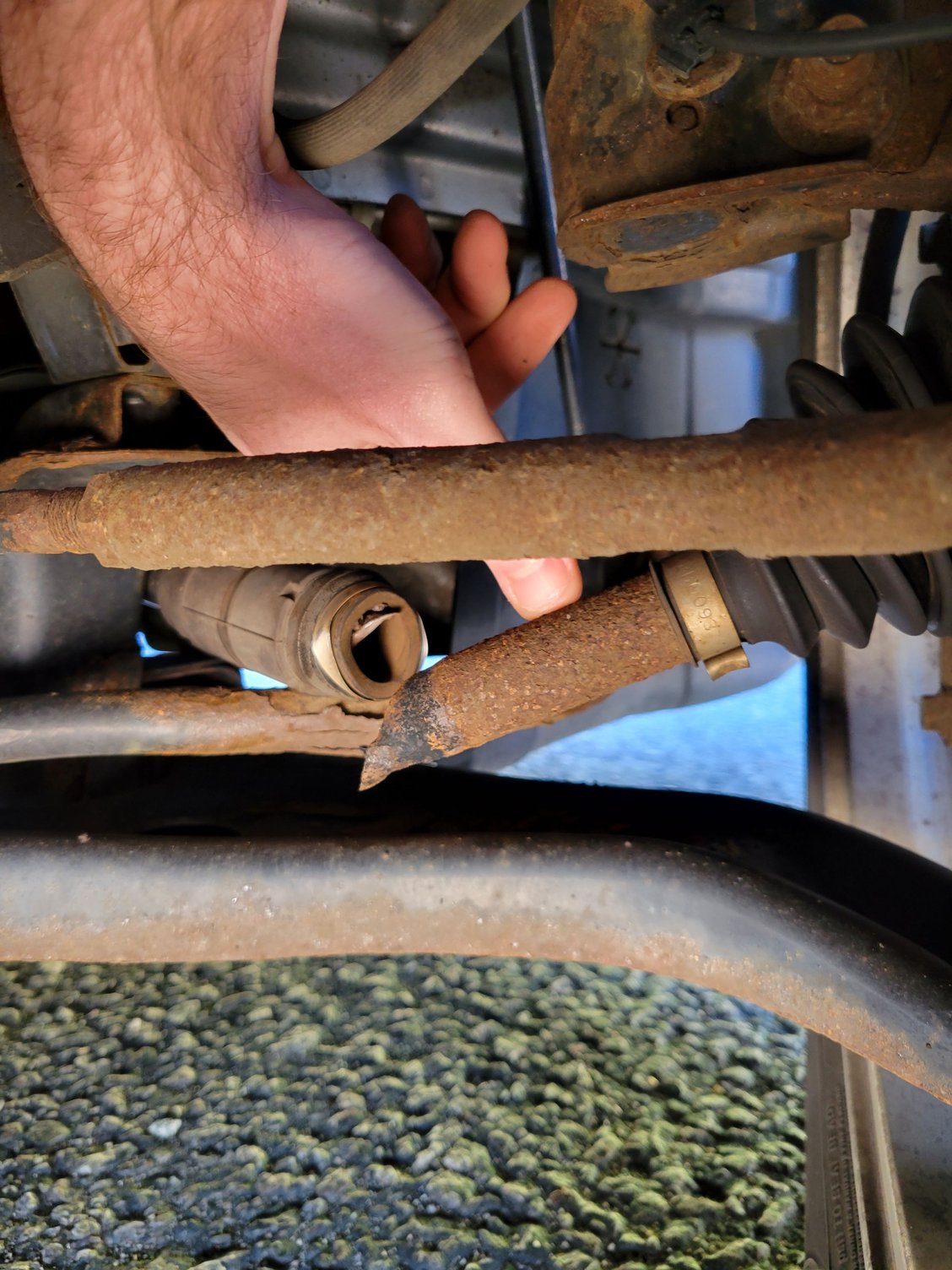

Mine snapped right before a long road trip in the middle of the night... kind of a bad luck good luck kind of a situation. Was able to get it replaced at a dealer with no issues after getting back.
Old Aug 22, 2022 | 02:05 AM
Eastcoast Joe's Avatar
Joined: Aug 2022
Posts: 2
From: US
Note mine is a 2012 Fit Sport Manual. (Picture waiting for moderator to approve)
