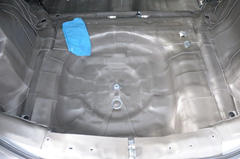

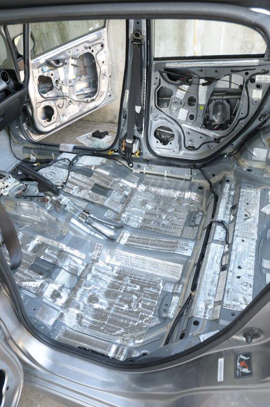

I did DIY sound deadening on my 2010 Fit Sport and can confirm that it's not difficult to go too far and make interior trim reinstallation difficult or impossible. I used Siless 80 mil (approx 2 mm) butyl automotive sound deadener sheets topped with Siless 157 mil (approx 4 mm) sound deadening closed cell foam.
I didn't completely cover the interior with the butyl sheets, but I overlapped the foam pieces slightly, so in any area the (mm) thickness of applied product ranged from approximately 8 - 10 mm, or 0.3 (5/16) - 0.4 (13/32) inch. Note that the closed cell foam is somewhat compressible, although that probably reduces sound deadening so might be counterproductive.
At this thickness, reinstalling some of the interior panels was difficult. It's been awhile, but I remember that the toughest panels to reinstall were the side panels (wheel well area) in the rear hatch along with the trim surrounding the rear hatch opening. Also, the small plastic covers for the front the front seat rails were super difficult to reinstall, and instead of breaking them I just left them out.
One tip that I figured out was to leave (or in my case re-cut) a small open area around the holes where plastic pins/clips from the trim insert and engage with the metal body panels. If you look at the back side of most of the trim pieces there is a decent amount of clearance, but the clips really have to engage directly with the metal surface. With that in mind, you could probably have more sound deadening thickness than I used as long as you leave clear spots for the clips to re-engage.
If you want to attempt that, I would recommend test fitting the trim as you add sound deadening. If you remove the clips you should be able to feel if the trim is still contacting the metal body panels (without constantly breaking clips). If it doesn't, you know you've gone too far.
Hope that makes sense.
