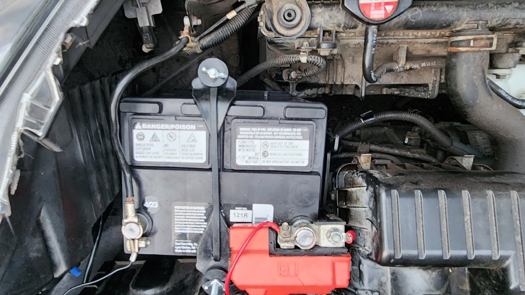

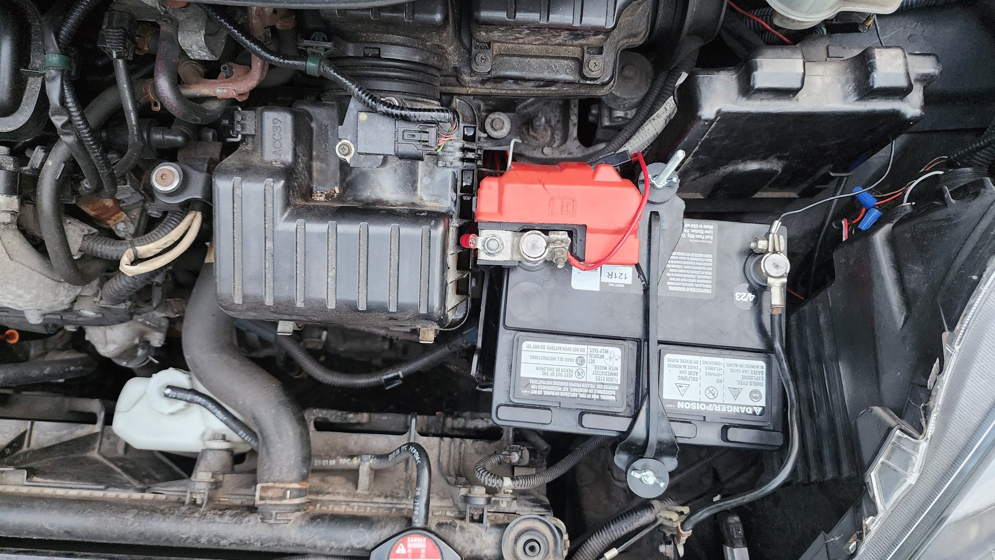

Just wanted to let you know that a 121R battery fits perfectly on our Fits without a lot of modification, keeping a stock look and allowing you to keep the battery tray.
As with the other battery fitting mods you will have to do some dremelling, but fortunately you only have to cut the front part of the original bracket. The one facing the ECU can stay there without modification. Also, the battery box has to be cut to accommodate the larger battery. About 150% the size of the wimpy 151R...BTW. The specs are amazing compared to other batteries.

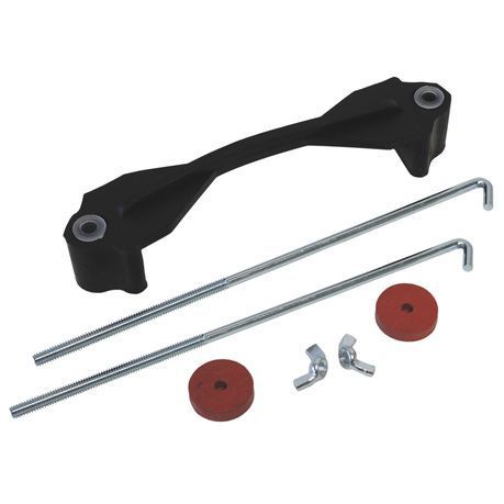

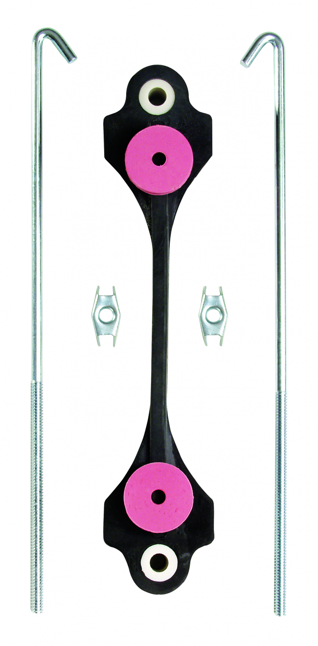

You will need either a battery strap or a universal bracket. In my case I used Duralast part #00678
You can find it under many different brands at every car part store or Walmart.
It's made of rubber and gives you a lot of mounting flexibility.

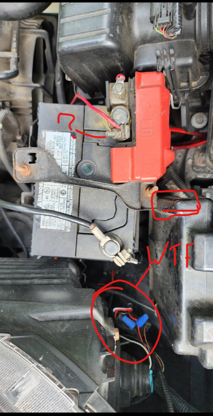

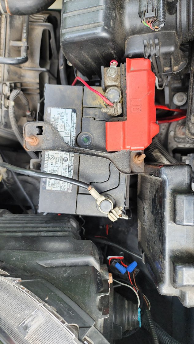

Whatever you did to the positive battery terminal doesn't give me a lot of confidence. Are you using wire nuts? The dead battery issues you are having might be self inflicted based on some of the things my little eye spies here.
Old Sep 5, 2023 | 04:29 PM
mykizism's Avatar
Joined: Sep 2019
Posts: 226
From: Garage Park
Lol... Man's gotta keen eye.
