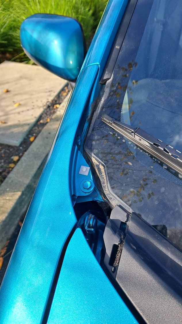

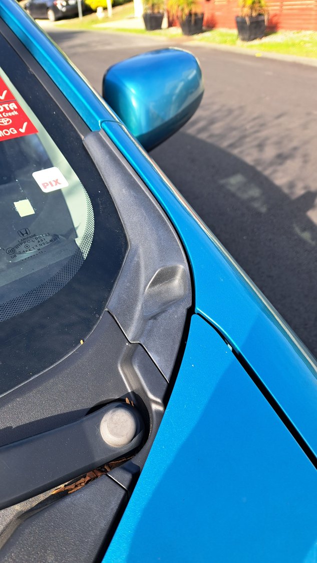

Recently purchased a used 2013 Fit in pretty good condition. Yesterday noticed that a largish piece of exterior cladding (or whatever it's actually called) at the base of the passenger-side windshield-wiper fixture was missing, per these pix of the passenger and driver's sides both. Can anyone tell me what this piece is called, and how one goes about ordering a replacement either from Honda directly or a dealer? Looks like it might just snap in...
Passenger side ... fitting absent
Driver's side ... fitting in place
Appart from a passion for symmetry, I'm concerned about rain and detritus falling through that passenger side opening as winter approaches here. Thanks for help ID'ing the part name (and number?) so I can get it replaced. And for any nomenclature tips I might find useful -- cladding was a shot in the dark. .

That is part of the cowl.
this is the specific piece as far as I can tell. You’ll need this and the clip linked below if I recall correctly.
https://www.bkhondaparts.com/oem-par...EtNWwtbDQtZ2Fz

Thanks a lot for those links. The 2013 uses the same parts. Can't argue with a first parts order that just hits $20.
