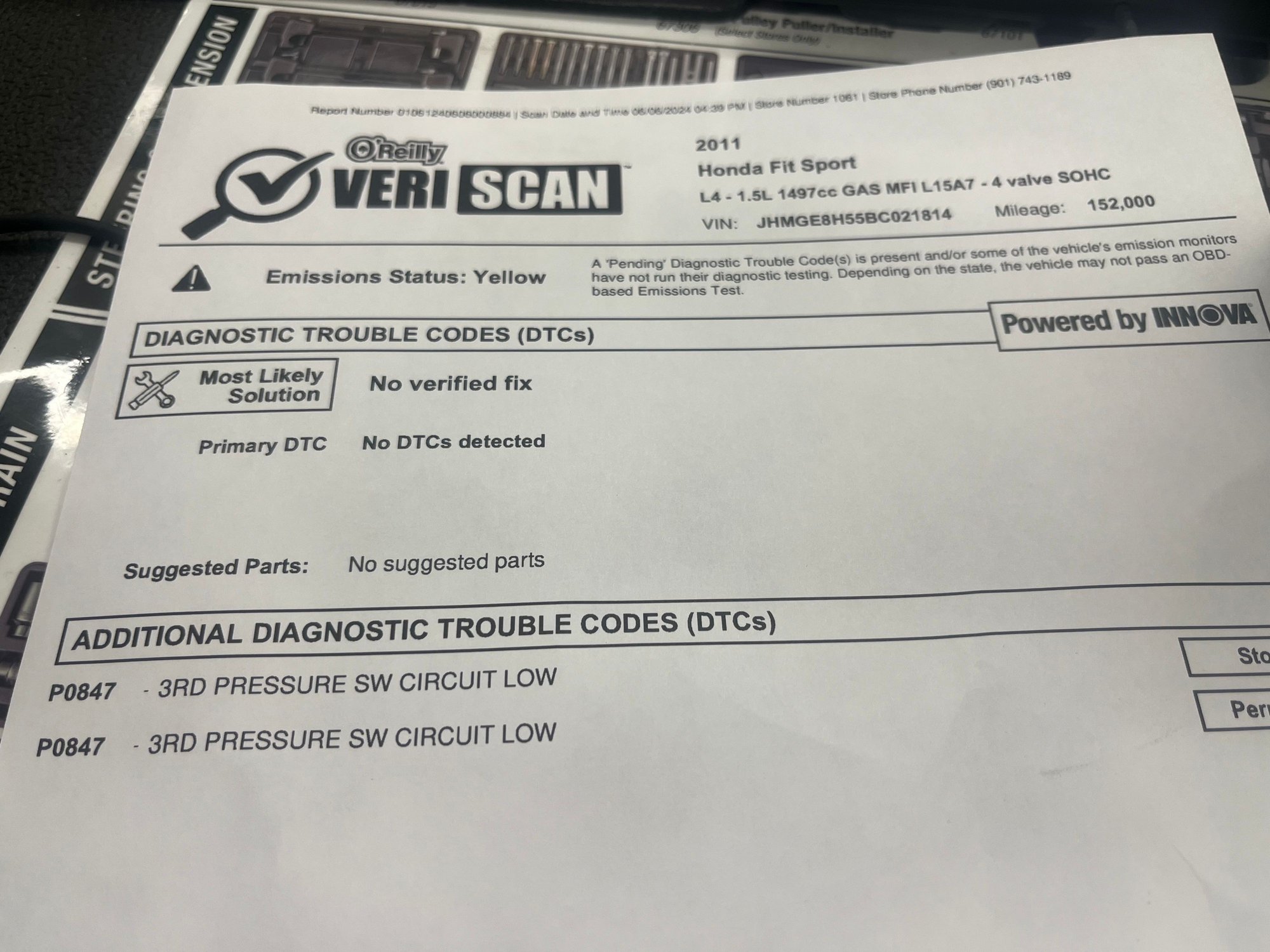

Honda Fit sport check engine light on
2011 Honda Fit Sport
What does this mean?

Do a search on Youtube. It has most of the info you'll need including where the sensor is located.

Easy 30 minute job to replace the transmission sensor BUT get one from Honda not aftermarket about $100. I tried to save money and the Amazon purchased sensor lasted 5k
