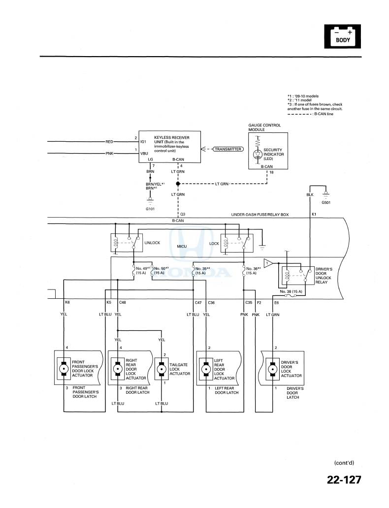

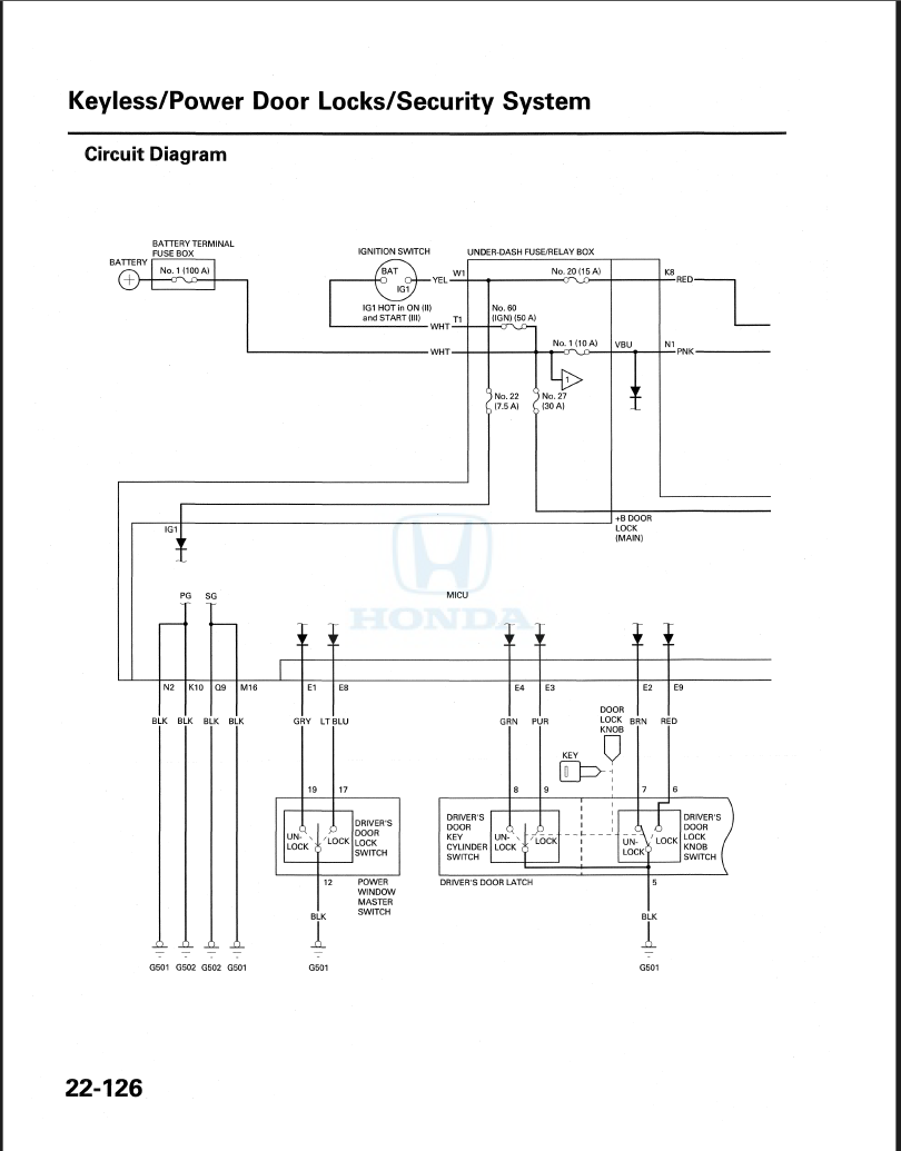

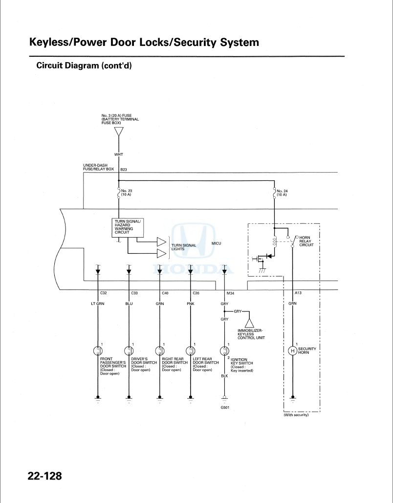

Hey Dan,
I have included some schematics for the car doors and locking system. Hopefully this will help.
Page 1
Page 1
Page 2
Page 2
Page 3
Page 3
Page 4
Page 4
Best of Luck!
