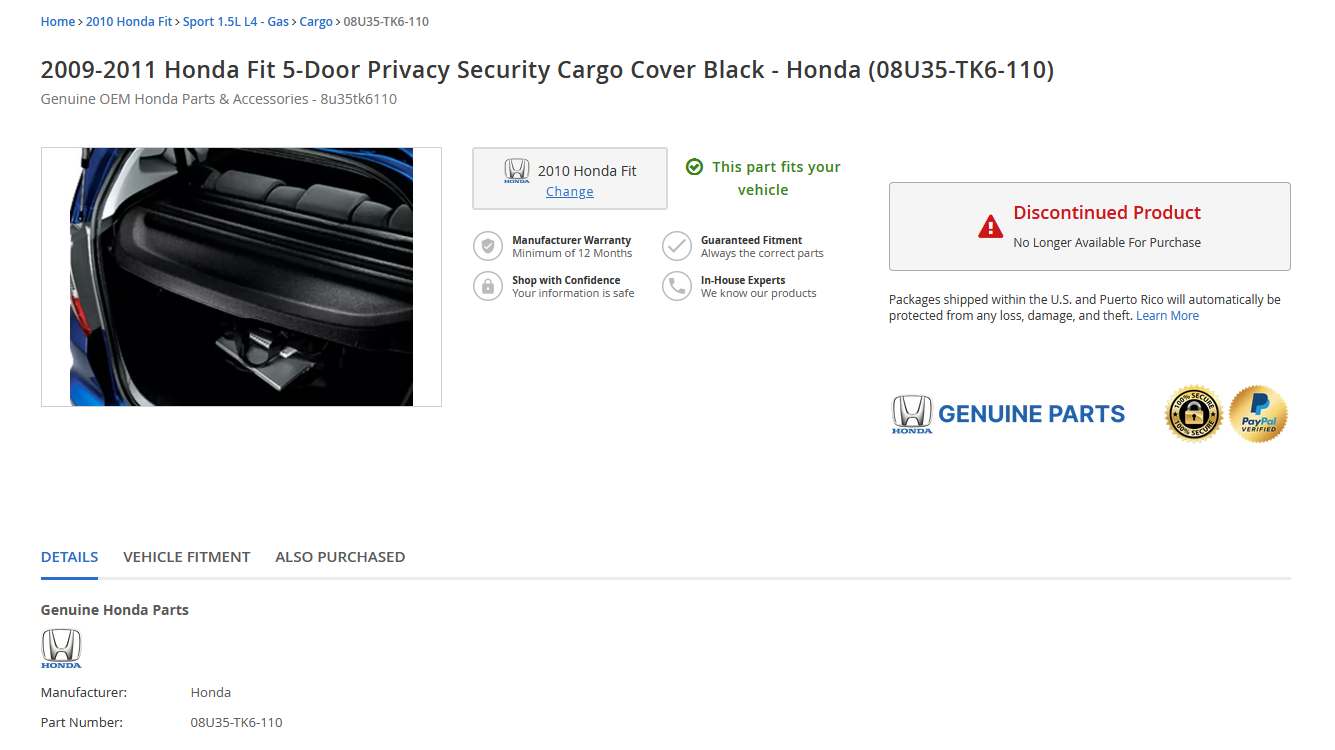

The two items you linked to look the same to me. Why do you think that the first looks like a good fit and the second doesn't?
If you search the various Honda Parts websites you can find a model number for the (discontinued) cargo cover, then use that to search elsewhere. Because you're looking for a 15-year old part it's unlikely you'll find the OEM part new, so you might have to go for a used cover from Ebay or a generic/knock-off item like the ones you linked to.
