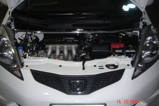

just new here, my jazz/fit doesnt have a pop-top cover like this:
http://i34.tinypic.com/zwgw79.jpg
how can i expose the horn area???
i already have a replacement stebel nautilus horn.
TIA

Awww the Asian model Fit/Jazz doesn't have that grill cover. Its a single piece whole bumper so we gotta remove the whole bumper 1st. Argh!
