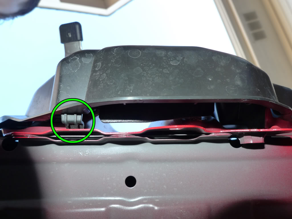

Word of caution: Order it from collgehills, because they will include a set of clips that you will INEVITABLY break when you remove one of the covers. It is impossible to remove the cover without breaking those clips, hence they are being included for you. Other places will NOT include the clips, and I have no clue what part numbers those clips are!
You can avoid damaging the clips by unclipping the bottom part of the plastic housing indicated below:
With that unclipped you can access the bolt with an open faced wrench easily.

I actually managed to get the clip holding the hood release cover in place without destroying it. This is what the clip looks like:
I was able to pry it out a little bit and then use a flathead screwdriver to push the barbs in so that it could slide out. For those that end up breaking them, the replacement part number is 91518-SM4-003.
