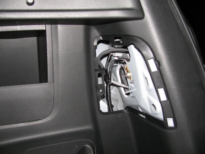

1. First take off the tail light access covers on both driver and passenger sides

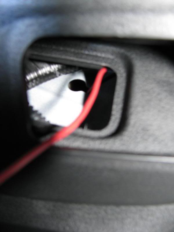

4. take a look at the hole where the stock hatch light used to be. way up in there is a small hole and a little notch. that is where you will be running the power wires down to the taillight access area.
5. I used a pretty stiff wire and stuffed it through. then i took the red power wire and tied it to the stiff wire.
6. Now at this time, you know where the power wire is gonna be running. So take your tail light plastic covers and find a place to drill a hole. that part is entirely up to you. this'll give you an idea of roughly where i put the LED holders
7. pretty symmetrical i think

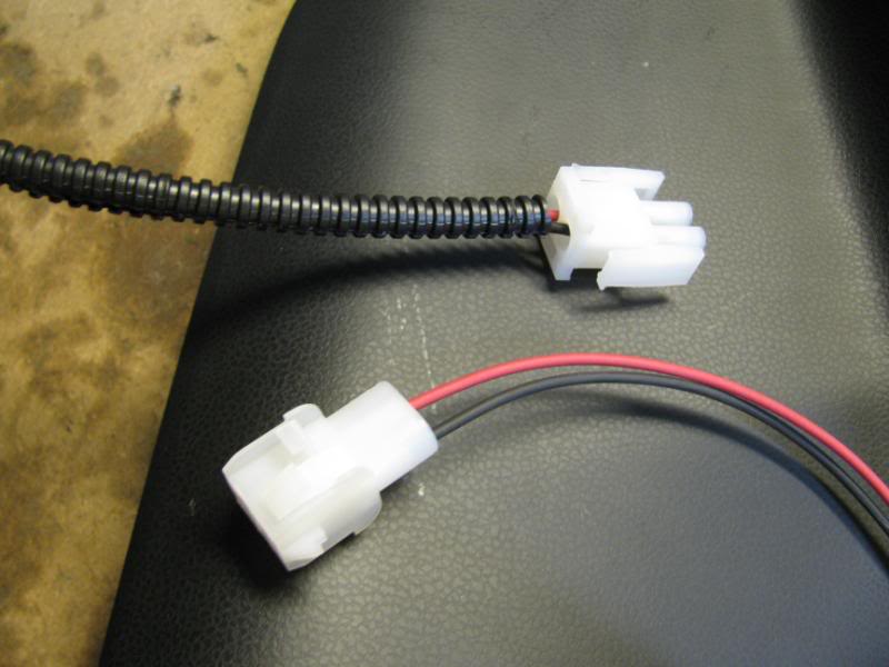

8. In the above picture you can see two separate heat shrinks and one heat shrink close to the LED itself. The one close to the LED is already there where oznium provided prewired LEDs with resistors. The two separate ones were made by me because i wanted to lengthen the wires. I also went "all out" and got some connectors, pins, and sockets from work, so instead of soldering or just simply wire tapping, i can disconnect these easily. You dont have to use connectors though.
male and female end:

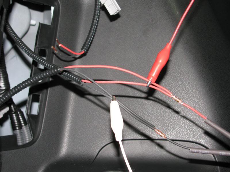

9. Now that you have your LED's installed in the taillight covers, its time to really wire up the hatch with postive and negative wires. in the picture below, you can see a set of + - wires coming from above, remember, thats the wire we routed though that tiny little hole where the stock hatch light was. the second set of + - wires that come from below go through the plastic panel and the bottom trim piece that we took off earlier. then it goes through the passenger side panel piece up the to the taillight access area. (I had a pic of it but cant find it now)
note: the two unstripped wires that hang from above are going to tapped into the stock hatch light connector.

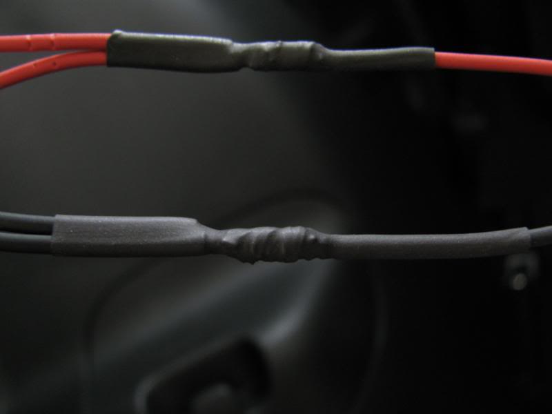

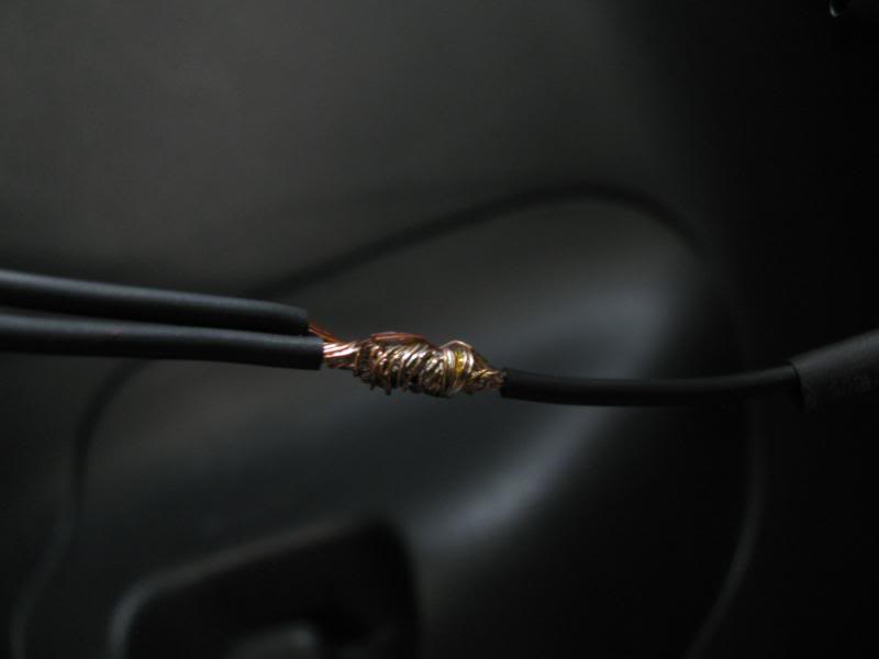

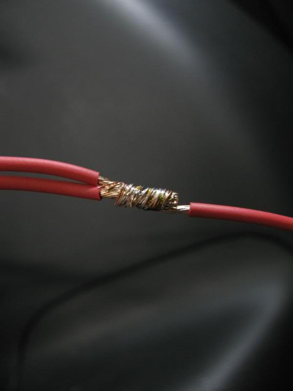

10. In the picture above: take the a short length of wire and solder it to the two sets of wire coming from the taillight access area. these + - leads are going to be connected to the drivers side LED.
note: remember heat shrink! or electricians tape
Size:  16.8 KB Name:  IMG_4530.jpg

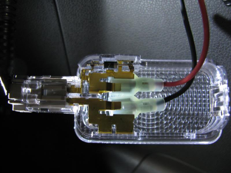

11. The drivers side is now done. head on over to the passenger side and connect your LED to the + - wires that you previously routed. Now its time to actually connect up the + - wires to get power! Remember those two stripped wires that were just dangling in a picture above? take those and crimp on female spade connectors. because these LED's are going to light up my hatch, i dont need the stock light bulb anymore. also i didnt want to directly tape into a stock wiring harness because you cant really replace it. instead i decided to hack up the light fixture itself because that is easy to buy at honda and replace. take a look:

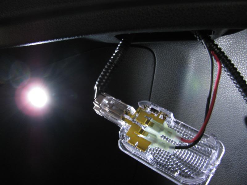

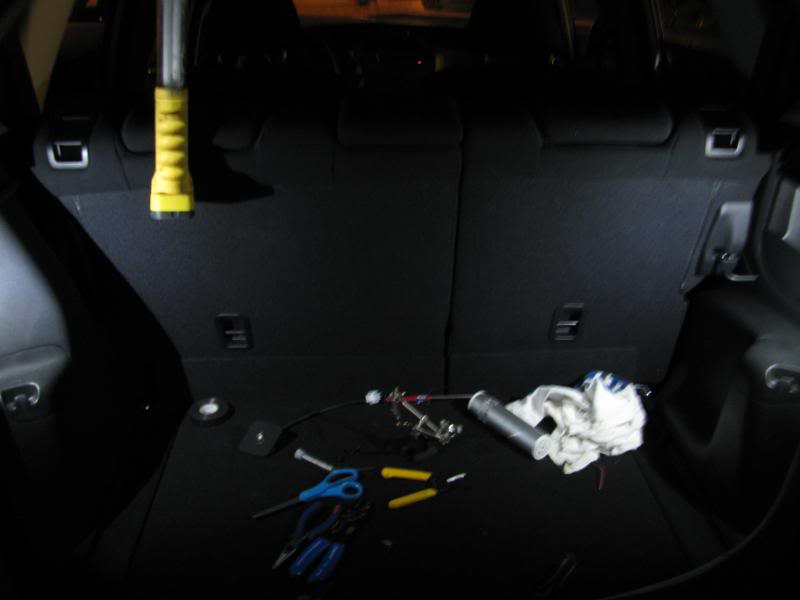

12. ENJOY! your new hatch leds!
So there you have it 2 hatch LED's to light up your ride at night. Now you dont have to stumble around to put your 6 pack in the trunk at night now!
