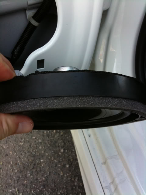

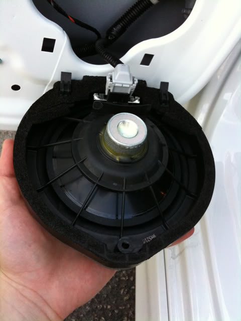

I just remembered I took pictures

Wow... those are... inadequate... lol >.<
So are the speakers all 6.5's? And how many of them are there?
Also, do you need any mounting plates in order to install speakers that have larer magnets (Though from the looks of it my headphone speakers use larger magnets )

Yeah 6.5 all the way around (2 front door, 2 back door) though I wouldn't waste my time upgrading or even using the rear speakers unless you have rear passengers often.
The depth of the door panel seems adequate for even the largest magnets. As far as a mounting bracket the only thing I've seen done so far is someone taking apart the stock speaker and using the plastic ring/bracket as a bracket for the new speaker.
Looks like Crutchfield has some adapter brackets. I would personally have some MDF baffles made but I know a guy that's local to me that does that

I would bet $$ that that magnet is a neodymium is probably equal to a 10 to 15 oz ceramic.
I think they are made by Foster http://www.foster.co.jp/en_corporate...ductsInfo.html
Adapter plates are available. The ones I found listed on ebay are 3/4" deep. http://cgi.ebay.com/ebaymotors/ws/eB...K%3AMEWAX%3AIT
Seller says they are the same as 01-05 Civic 03-09 Accord.

Damn, those speakers are sad...
