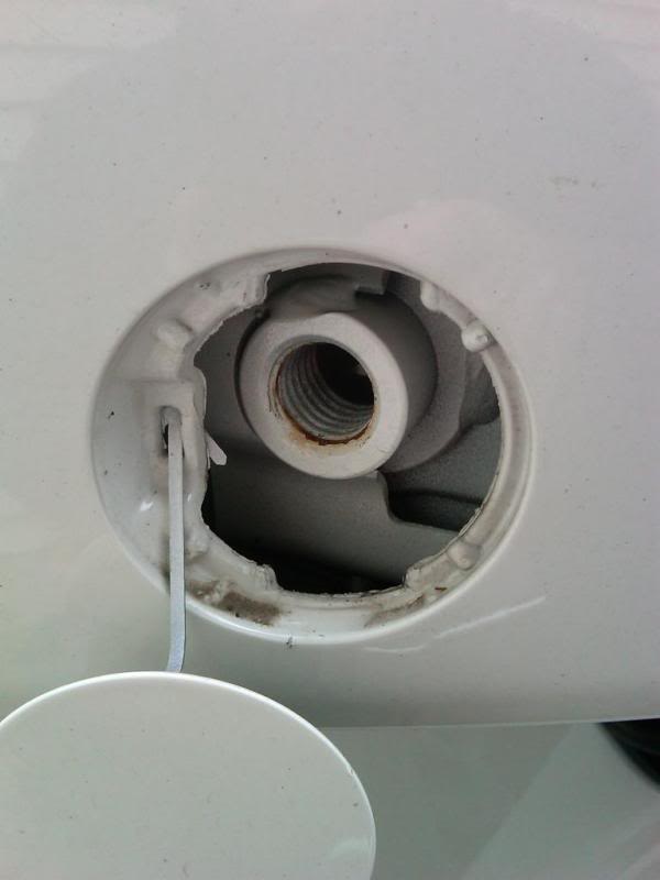

Isn't really that big of a deal, but at the same time for me, it is since its on a car which is less than a year old.... Its located in the area on the front bumper where the tow hook screws into the frame...rear towhook area was fine when I checked it. Just happened to pop the cover loose earlier and noticed it. You guys think anything should be done about it, mentioning it to the dealer or anything??
Anyone else noticed this?

I would'nt worry about that. Very little paint gets sprayed there..clean it and touch it up. I would however remove the top plastic cover..the one located just above the top grill (under the hood). With that removed, you can see the entire bumper beam, which is what you are looking at now. See if there are any more problems.

I would coat that and the threads with anti-seize compound.

My guess is that the paint didn't "take" there due perhaps to the threads that were cut. Maybe there was cutting oil on that spot, or some other comtaminat. I would look the car over good just to see if there are any other problems. That particular part is the front bumper beam that acually unbolts from the frame. I would look to see if it has any other problems with rust by removing that upper plastic panel, but I doubt that it will. I think that issue had something to do with the treads.

Factory Warranty covers rust for 5 years if I'm correct, so if you have any rust, you should talk with your dealer and they will address the issue, a little sandpaper and some touch paint might be all it takes.

As others have said, this is cosmetic, not structural. If it bothers you, clean and paint, then find a metric screw and screw it in (with some thread lubricant, or wrap the threads with Teflon tape. OR, find a piece of plastic or rubber plug big enough to engage the threads, and screw that in. Dealers have more important things to do than deal with something like this; if I were a dealer, I would probably tell you to go take a hike (which may be why I'm not a dealer...) Your time is worth something: driving to a dealer, then waiting, then driving back home will take a lot of it; you can do the repair yourself for less effort.

The dealer would likely have a hard time hiding a smile at you. I know I would. The warranty is for rust perforation, from the inside, not for surface rust. When you ad in that the surface wasnt treated originally, likely because it is the interior threads for the two hook, which is covered by the bumper...
Haven't you ever had a car that's a few years old that has some rust on the undercarraige, but the paint was exceptional?
Just enjoy the car, and stop worrying!
