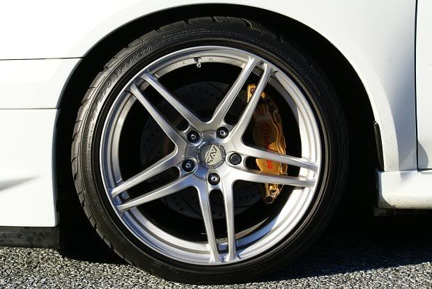

These are the brakes that I am running on my STI. And like I said before I think the Fit drives and stops awesome for the cost. The only weak point I feel that this car has is the lack of more top end power. But on that same instance it wasn't designed to really have any so I would never even feel the need for it. I cant say enough about how well the fit drives.
By the way if anyone happens to ask these are Advan model 5 wheels. I had to wait 6 months from the time of the order for these to come in from Japan.
