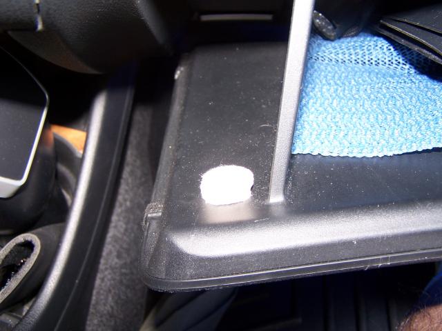

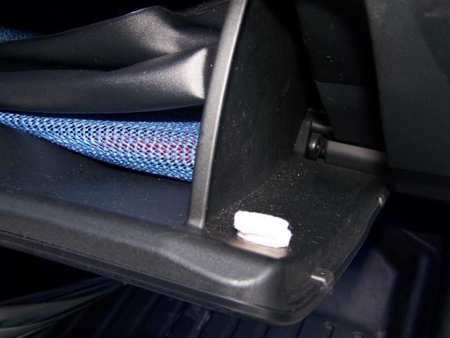

I went at it another way. If I pushed in on the door it would stop rattling. So I add a couple of felt chair guides to each side of the door. No more rattle. My would only rattle in the summer. In the winter I guess it contracted enough to not rattle.
