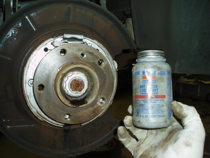

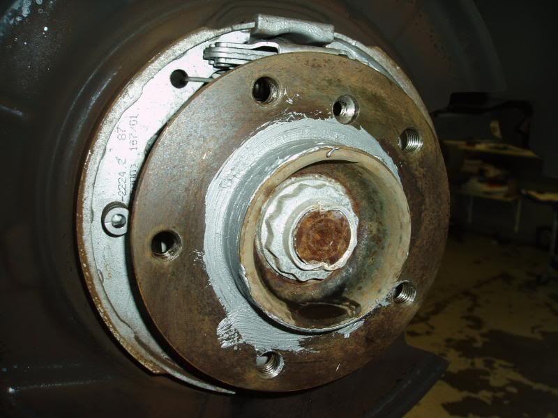

Here's your pic:
Use a steel brush to clean the hub:
Apply anti-seize compound on the center of the hub to prevent the rim from sticking:

Ah thank you! I've got some nickel-graphite anti seize laying around. I guess on my previous vehicles I was rotating every 3k and never had this problem.

When I did my Rotors or brakes on my cars, It took me a number of smacks on the tire to get the wheels off. Usually the fronts are more stuck on there. Looks normal to me from the photos. The anti seize is a good solution.
