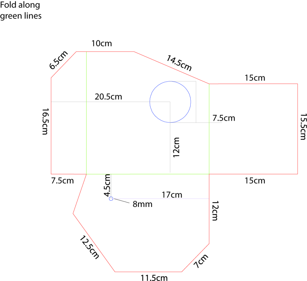

I drew up a 'real life scale' schematic for this heat shield design as provided by MADMAN-_-zZ here:
AutoCAD DWG file and 4 part PDF (So you can print the 4 pages 11"x17", tape together and use as cutting template in case you dont have a large format drafting plotter handy):
UPDATED LINK: https://ryangielow.sharefile.com/?cm...df7d19742d4088
AutoCAD DWG file
http://www.compsolserv.com/fit/cai/fit_cai.dwg
4 part PDF (So you can print the 4 pages, tape together and use as cutting template in case you dont have a large format drafting plotter handy)
http://www.compsolserv.com/fit/cai/fit_cai_1.pdf
http://www.compsolserv.com/fit/cai/fit_cai_2.pdf
http://www.compsolserv.com/fit/cai/fit_cai_3.pdf
http://www.compsolserv.com/fit/cai/fit_cai_4.pdf
Nice nice, did you make one? or only schematics? would like to see it!

Its on my 'to do' list but Im waiting for my air filter to arrive first. Feel free to add the links to your original post if you like.
