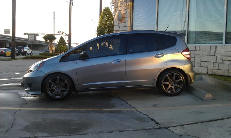

Well finally got off my ass and put the wheels on the car! Here are some pics... All the way down and drove to work no probs... I don't like the gap in the front but what can you do...
-Ray
Last night:
Today:
Old Oct 20, 2011 | 09:42 PM
  #80
1SickVeilsideZ's Avatar
Joined: Sep 2011
Posts: 765
From: Cali
Looking good man, nice progress on the car, just went through the whole thread. Where did you get the spoiler from if you don't mind me asking?
