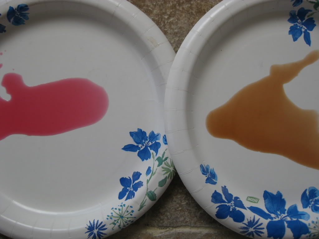

DO NOT WAIT FOR 60K MILES BEFORE CHANGING YOUR AUTO TRANS FLUID (Unless you're leasing the Fit or don't plan to keep it long term).

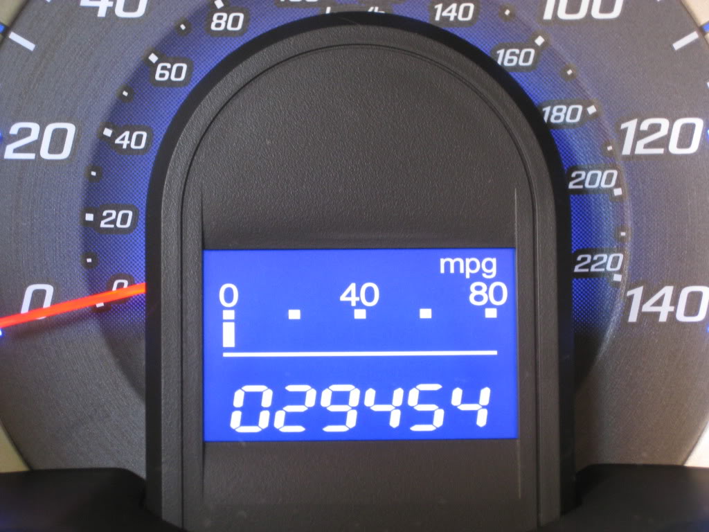

As of this morning, I was at 29,454 miles on my 2009 Fit. 90% of the miles are highway and decided to do the transmission fluid change before the Football games began. I was in pure shock to see how brown the original transmission was.

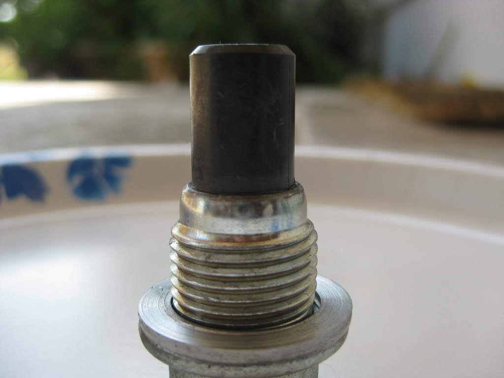

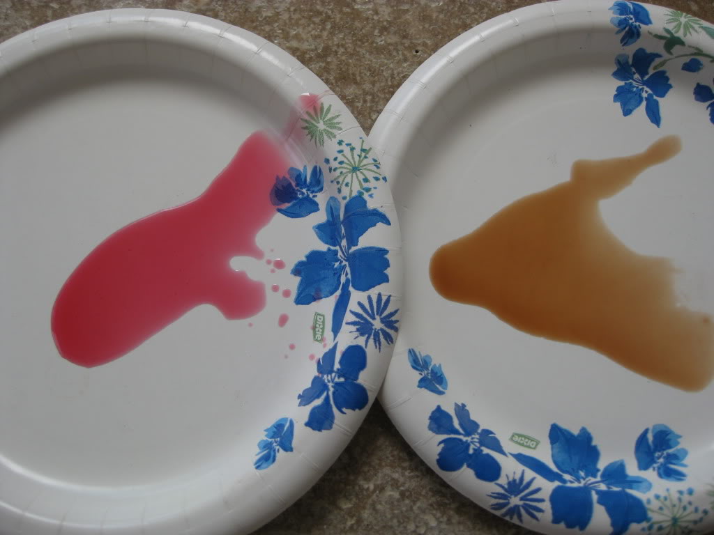

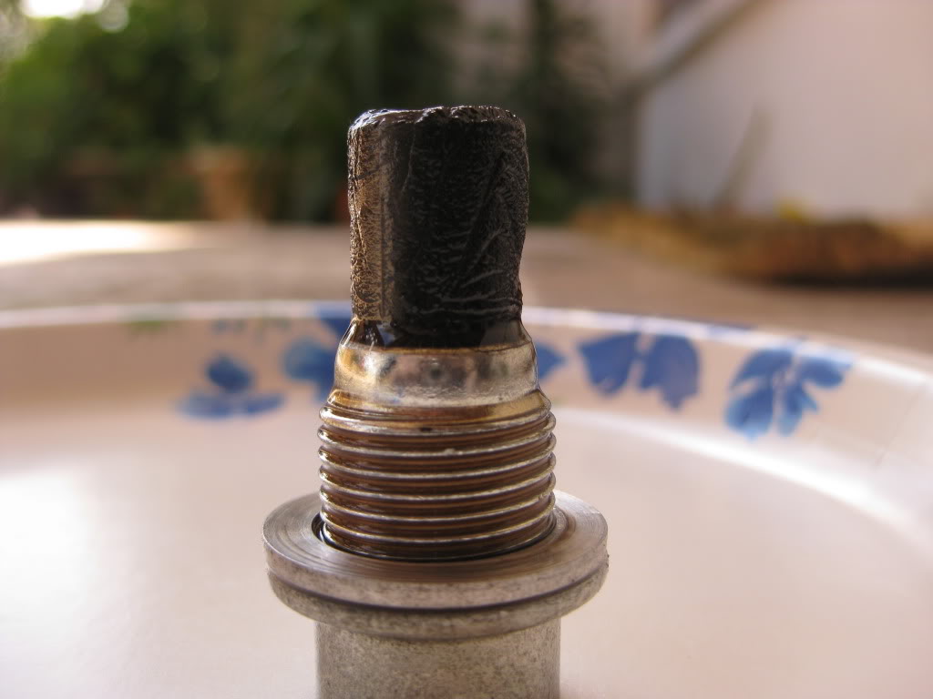

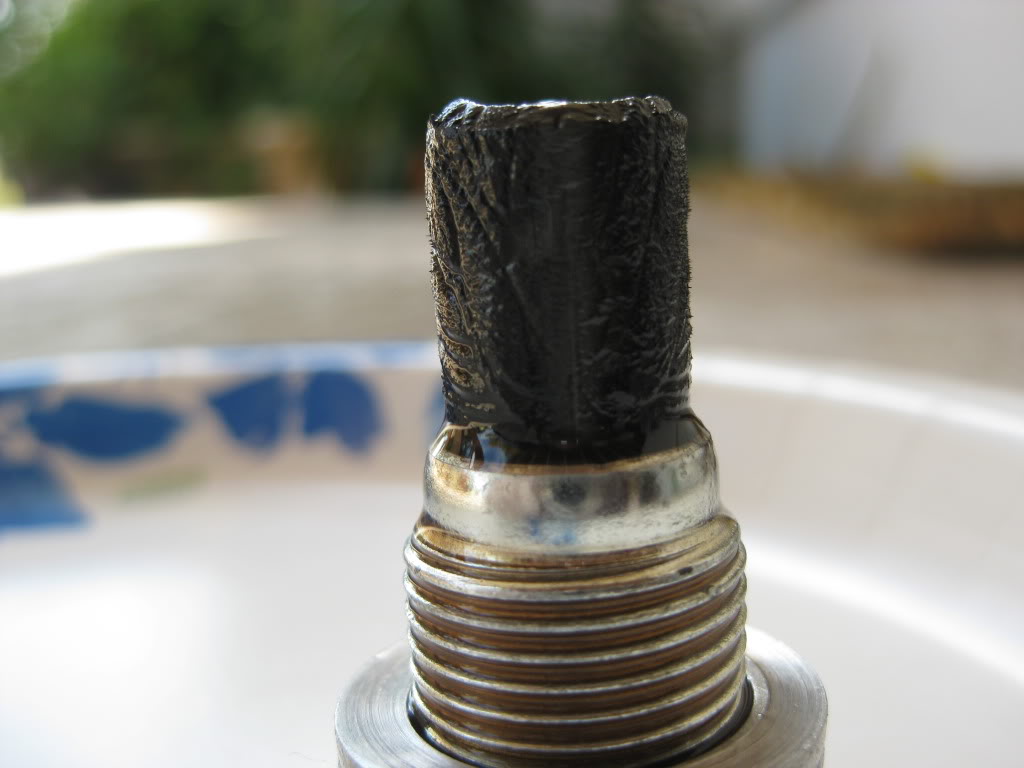

Note all the metal shavings.

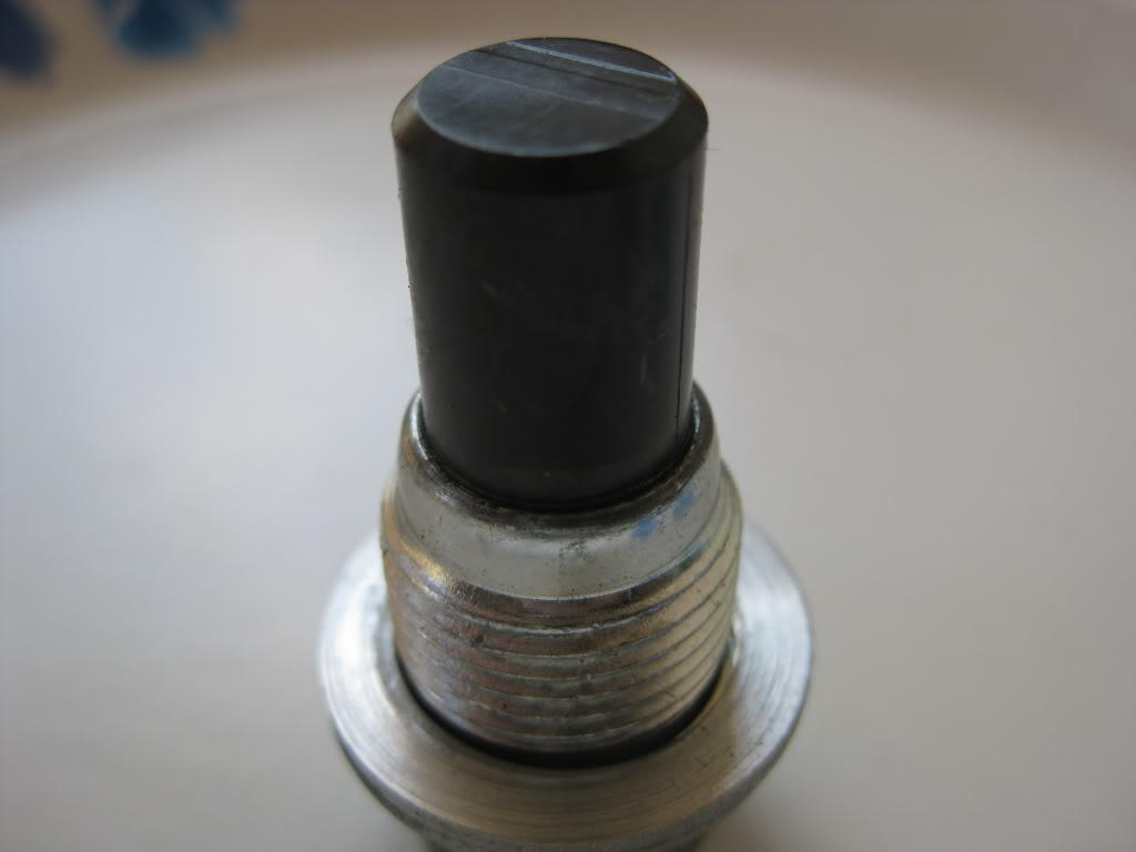

Magnet after its been cleaned.

Biggest shock is that Honda recommends that we drive 30K more miles on this fluid before changing it (new DW-1 on left, used Z1 on right).

What kind of driving? It looks pretty dirty and would change sooner. It might be because of the higher temps down there.

We all know that one cannot or should not judge motor oil by its color (being dark doesn't mean its broken down).
However, most people that I know "do" take the color of the transmission fluid into account. This fluid, at just under 30K easy miles, did not look good at all and it bothers me that Honda recommends to change it soo late.

I honestly don't believe the issue is the climate. If you look at the pictures in Clay's thread (linked in my first post of this thread) you will notice that his 30K mile ATF is at the same state as mine was and he doesn't live in S. FL.
I am willing to bet that most, if not all, the Fits on this board have their ATF at the same state at 30K miles or so.
Honestly, I believe that the issue is either that the Z-1 fluid breaks down too fast, or that the transmission in our Fits puts unusual stress on fluids.

Hey Shora thanks for the shout out.
And I do not think geographical location makes a difference with fluid degredation.
I live in Charlotte, NC and the fluid in my thread was probably a tad darker than Shoras.
I put 20K miles on my Fit in the 7 months before I changed my fluid that is in my thread. We had some hot ass days during the summer here but probably not the continual hotness of South Florida.
I could honestly say that out of those 20K miles about 2-3% was stop-n-go traffic or short runs, the rest was all interstate 60-75mph.
Like in my thread I always see ATF Z-1 fluid that color after 20-30K miles in my 94 accord.
I am so glad I did not wait for the car to "remind" me or the 60K mark to change mine.
If people are unsure, just unscrew the plug and drain an ounce or two in order to see the current state of the fluid.
I am going to do that every 5K miles with the DW-1 fluid I just put in a few weeks ago to see at what point it starts to discolor.
Clay
