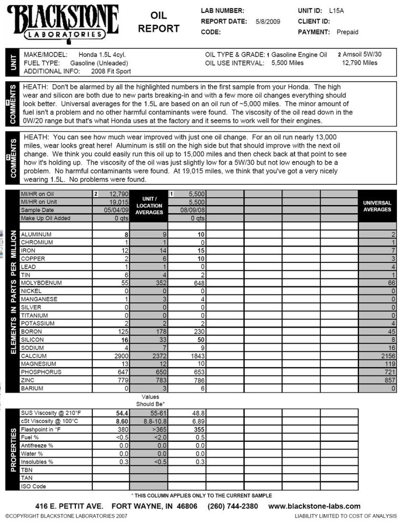

Honda themselves will tell you, every manufacturer does this and any engine should be run with a high moly/zddp dino oil for break in.
Urban legend huh? Why is it with the internet at your disposal you couldn't be bothered to do some basic research and instead assert an ignorant "gut" feeling with no basis what so ever?
Here's a nice hot cup of shut the fuck up:

The additive is not in the factory fill oil, but the pistons are moly coated. This disperses gradually during break in. You do not want to flush it out by changing the the initial fill oil too soon. Note the high moly in the Blackstone report above. A large dose of ZDDP is not there because phosphorus degrades the cat over time, an emissions warranty issue. One of the reasons I prefer Chevron oil is moly in the Oronite additive package.

Your answer might be Amsoil, which appears to have a recipe with fairly low moly content. As does Mobil 1. Was sulfides checked?
Al has stabilized at about 8-10 ppm, pretty normal especially since the 3 sigma variation is about 5 ppm. Fe also, interesting that Boron is decreased but Ca in increased ! That one involves some research.
It would also be useful if the friction level was checked by determing the power loss across a known gear train. That's the real measure of lubricant worth.
