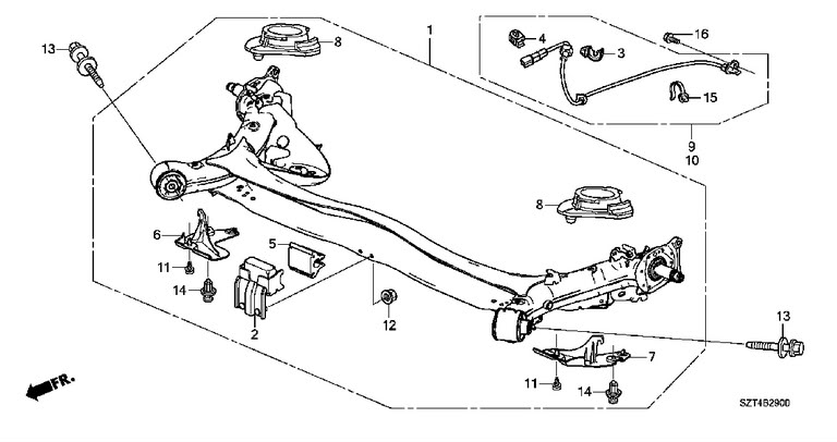

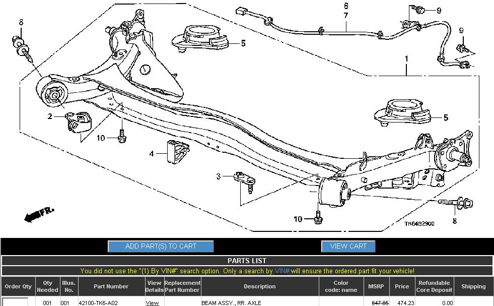

Originally Posted by blackndecker
I realize this is a really old post...but can somebody please explain the logic of how a thin RSB attached to the massive rear subframe is going to do anything at all? The rear suspension on the Fit is not independent...they are already connected via the massive swing arm. I just don't get how a thin RSB is going to do anything at all.
The rear suspension is semi-independent as it's a torsion beam connecting the two sides. The whole thing twists allowing one side to move some opposite from the other. The amount of twist is determined by the design of the torsion beam. The extra bar makes it stiffer. The sport already has an extra anti roll bar but apparently it can take more.
here's more.
Old Oct 19, 2011 | 06:54 PM
  #45
blackndecker's Avatar
Posts: 1,316
Thanks for the link! Great info...especially this nugget:
Originally Posted by Wikipedia
The longitudinal location of the cross beam controls important parameters of the suspension's behaviour, such as the roll steer curve and toe and camber compliance. The closer the cross beam to the axle stubs the more the camber and toe changes under deflection.
Notice the location of the longitudinal cross beam on the Fit rear axle:
Vs. the CRZ:
