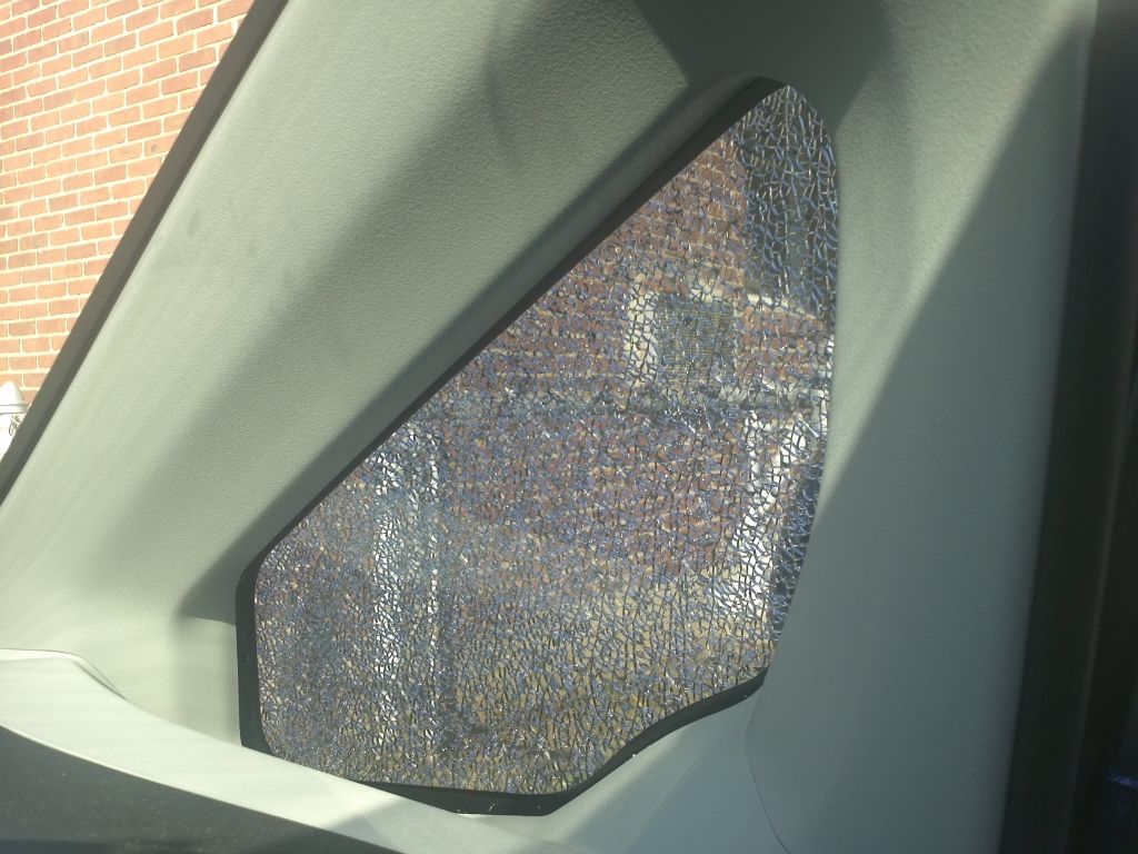

So before going to work this morning i noticed that the tiny window in front of the passenger side window is all busted. That window is still attached together but its completely cracked into pieces.
So my question is, how much to replace that tiny window? Has anyone ever experienced anything like this?
Thanks in advance.
********UPDATE**************
took 3 pics;
Looks like it was hit near the upper corner and that was what caused it to shatter.
Went to Honda, quoted $350+tax. Gonna try elsewhere to get it done cheaper.
On another note, i was reading the Car & Driver article today and had an article where the Fit was rated #1 in a comparison with like 4-5 other cars. The car they tested was a 2011 and they said the 2012's will have sound insulation, etc.. and *thicker front quarter windows*. Hmmm, i wonder why??

This thread is useless without pics!
Was it an attemped break in? I'm curious if it didn't break because of tint or it pressure ultimately forced it to crack.
Replacing it will be a matter of removing the glass and sealant, and putting the new window in (along with the appropriate sealant) and taping it to prevent movement for a couple days.

If it's in "pieces" I can almost guarantee that it was hit with something. If it was just a simple crack or two, it would've been from stress. Again, hard to say without pics.

After looking at the pics, I would say that does not look like vandalism...

Interesting. I still don't know. You'd think if it was an attempt at theft, the would be thieve would of just impacted the window in the center, or at what appears to be the most vulnerable point. This appears to have been impacted at the top...but it's so entirely shattered, hard to tell.
Oh well? You may never know. I'd be curious as to what your dealer/insurance says and what the total cost of replacement becomes..keep us updated.

I am still searching for a glass piece. Went to a local junkyard and they dont have any salvage Fit's to take this part from.
Not going through insurance because its gonna be less than the deductible.
Honda said $350+tax to fix, not covered under warranty.
I just taped it up and gonna look on ebay/craigslist to see if any1 has a totalled Fit to part out.

I just did my drivers front 1/4 glass. Its essentially glued on from the outside with windshield adhesive. I found a used on on ebay for $65. Car-part.com has some too. It does require three plastic clips from Honda. If you are carefull removing the old one, you csm reuse the plastic trim that goes on the back. Otherwise buy it from Honda. Don't scrspe all the old adhesive off the car opening. The adhesive bonds better to the original glue vs the metal.
