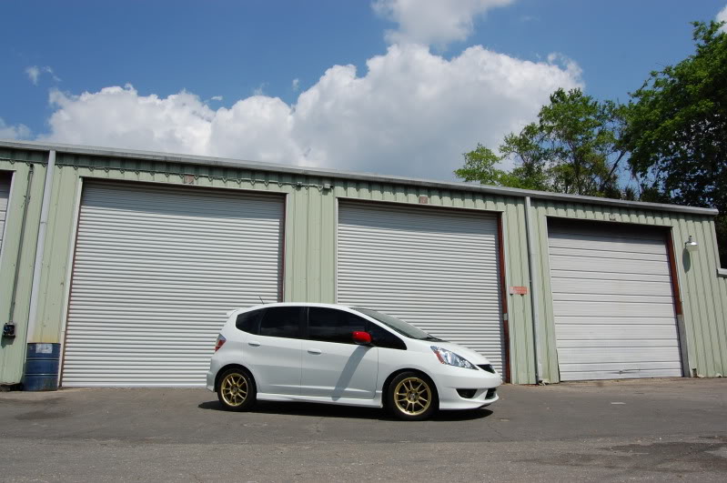

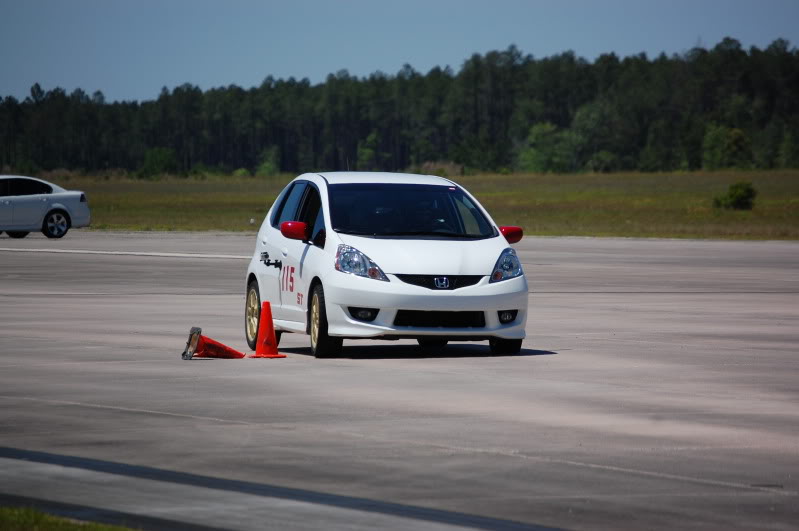

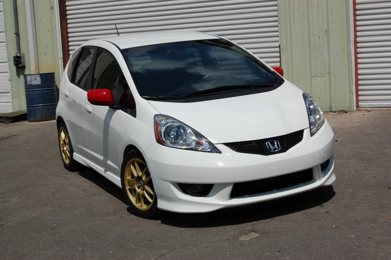

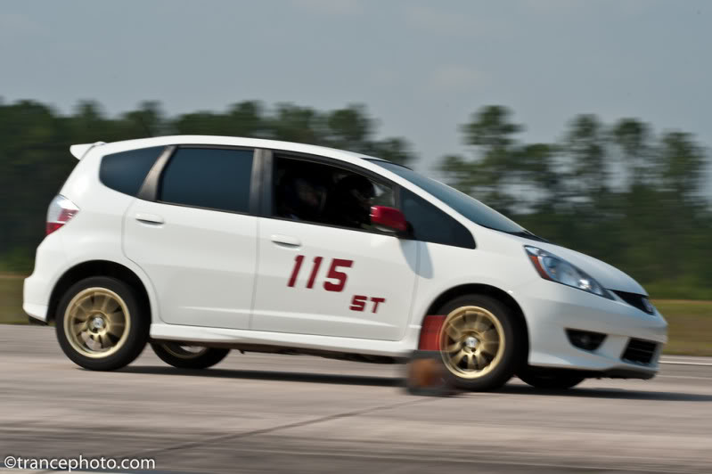

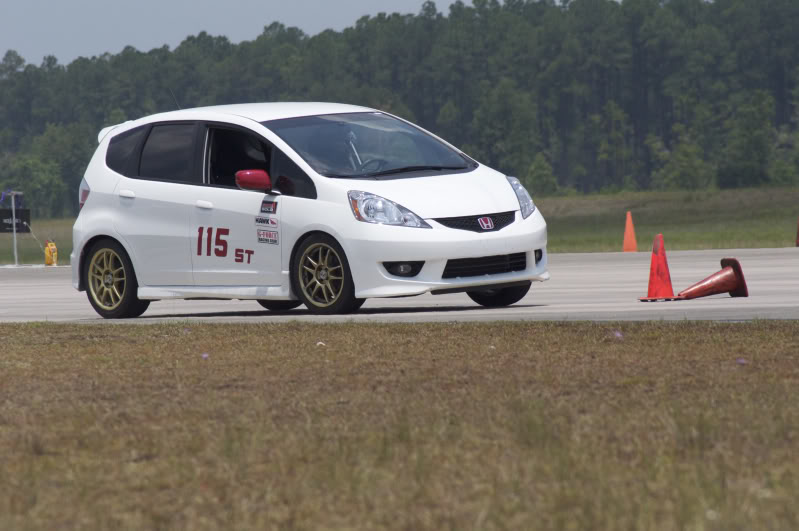

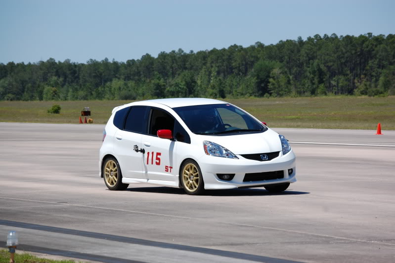

I've had these since the beginning of the year. I daily commute and autocross the Fit. These coilovers do both exceptionally well! I like the fact that it's quality Bilstein, and they took the time to do the R&D. It shows.
Here's some pics:
