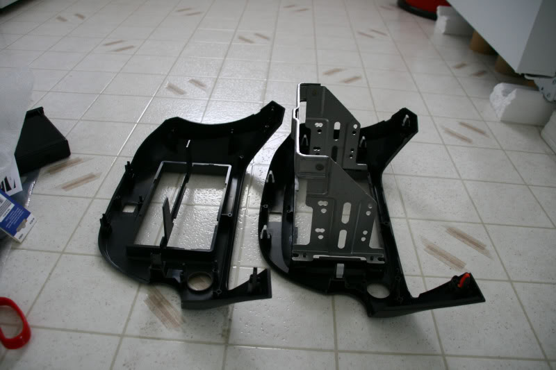

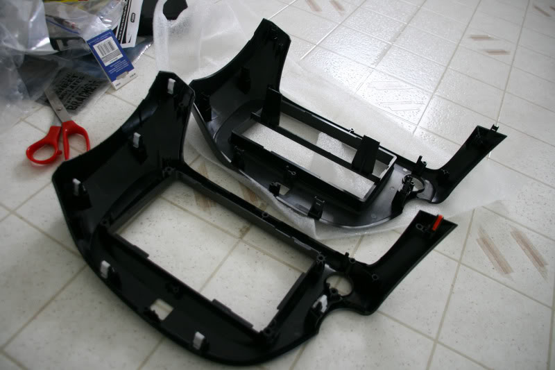

Old Sep 10, 2011 | 12:25 AM
jookybanana's Avatar
Joined: Jan 2010
Posts: 308
From: Victoria BC Canada
the bottom one is the one you want to look at, it has 4 holes for the bracket to mount to
and this pic you want to look at the one on the right, with the metal bracket on, so if you use some metal washers (i think mine were 1/8" thick) whatever size you need to make it sit back a bit so it is flush with the console, and its easy figure out if you measure how much the headunit is sticking out, then thats how thick of a washer you need
also if you do use the washer to space it back a bit, the one screw on the bottom of the metal bracket won't line up any more, so don't need to use that, you will know what i am talking about when you take your stock headunit off
