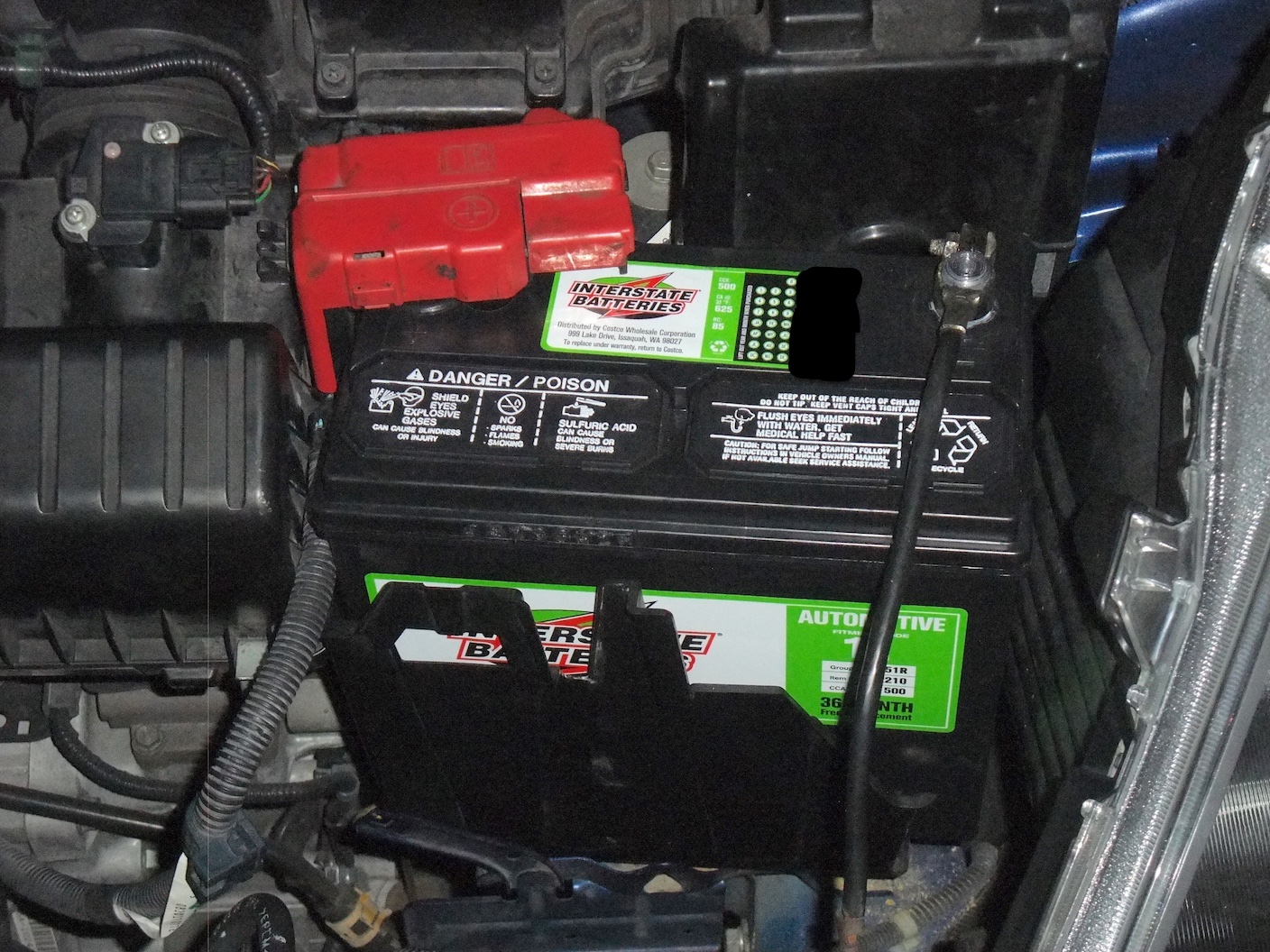

I just copied my old reply from another post. This is what I did a couple years ago. Note only had to dremel the fins off. Easy to do.
Pics of my install. I was able to get the positive to connect though I am missing part of red cap I broke off long ago. By moving the strap I was able to fasten the positive wire to the the original connector to keep it away from engine block. A tight squeeze though between air box and battery. I hope we do not rub through for a short. I just cut the one end off the original tray.

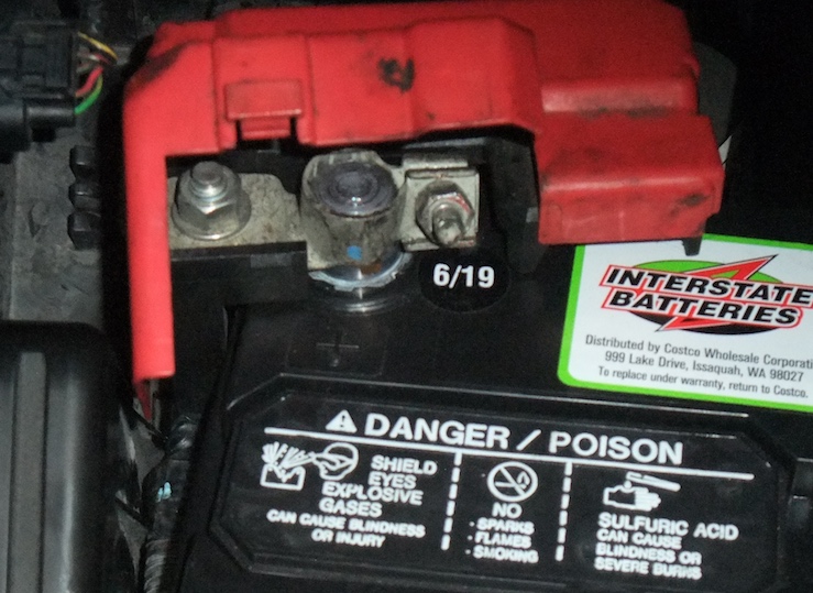

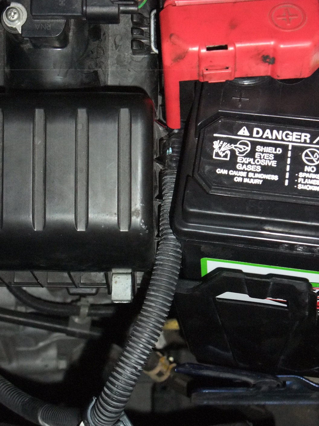

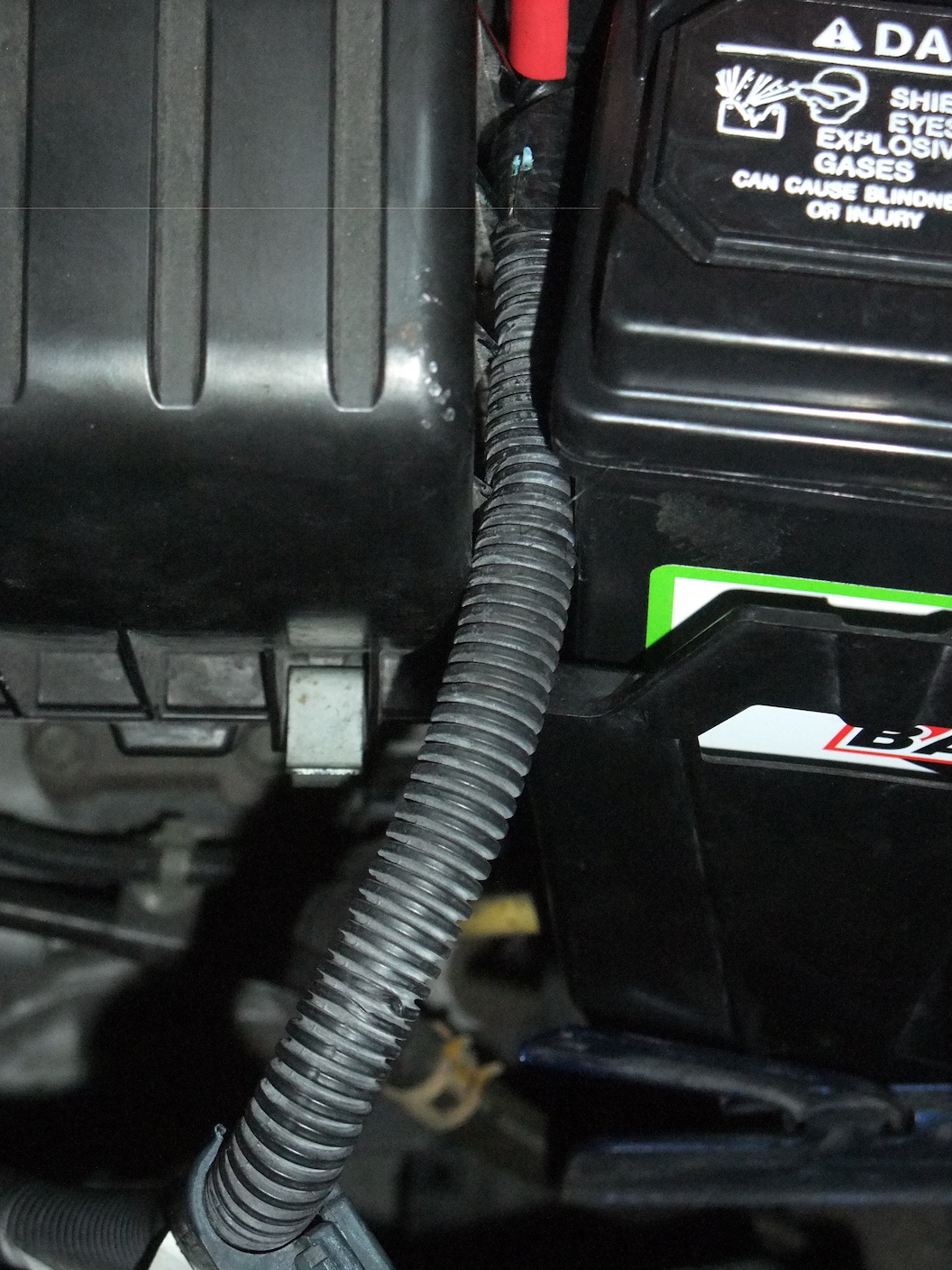

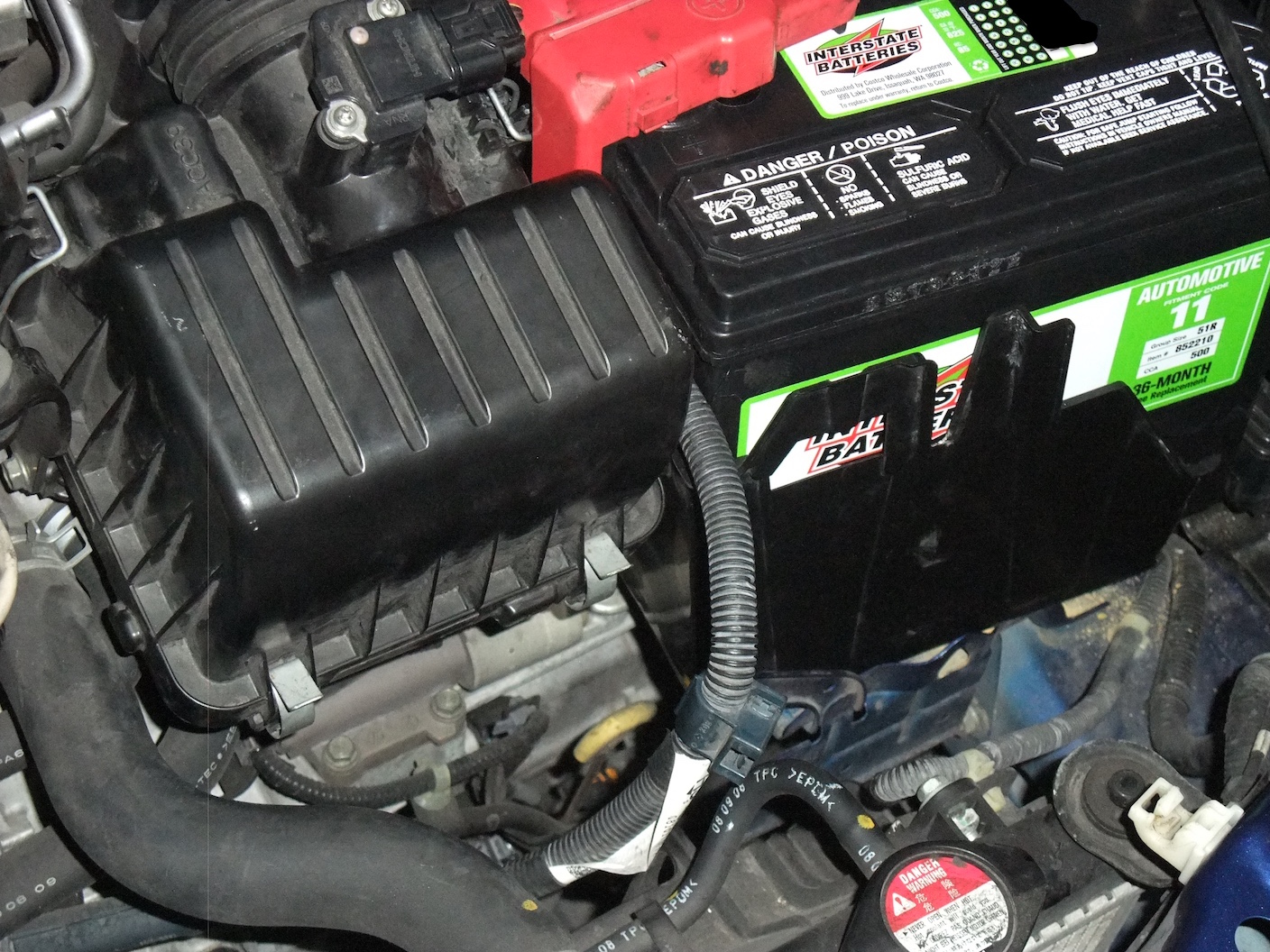

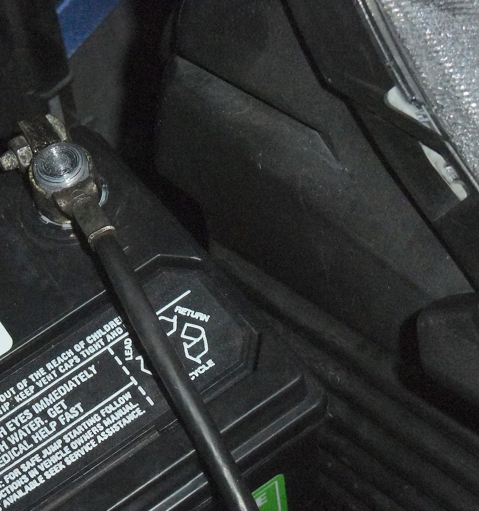

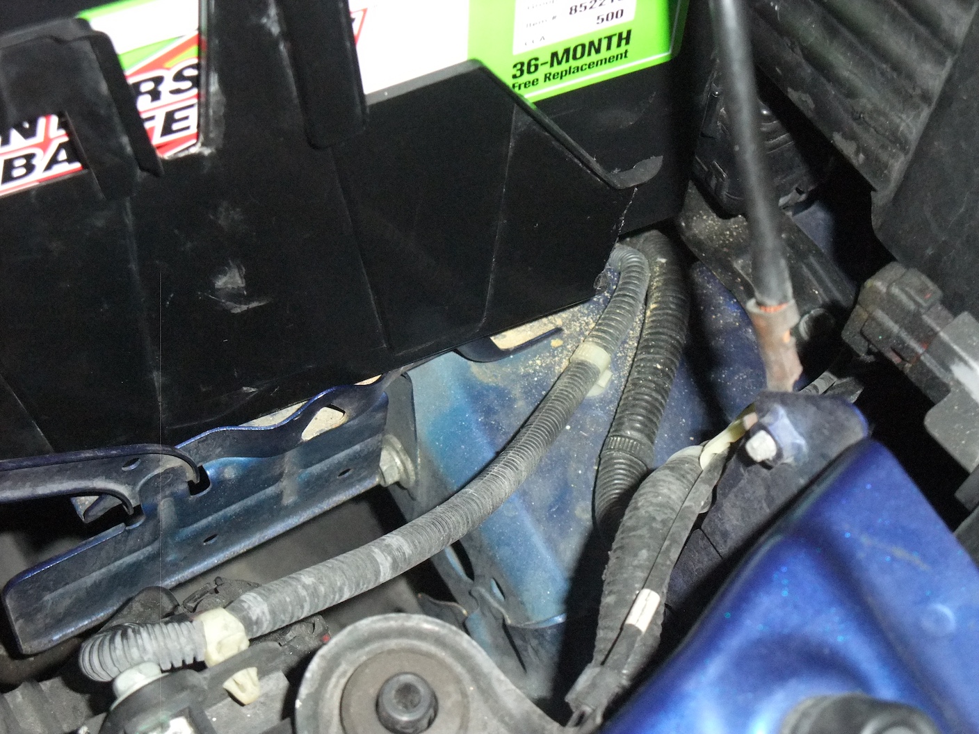

Decided to go with the 51R. $76 plus core at Costco.
It was very, very difficult to get the battery in. I tried it both with the original box (after cutting off the right side) and without. Either way, it is an extremely tight squeeze. On the left side, the battery abuts the electrical cable that exits off the positive terminal assembly. That cable is squished between the air box and the battery. On the right side, the battery itself directly abuts the wall of the headlight.
Trying to put the battery in so that it would line up parallel with the air box in the same way that the original 151R sits was not an option, even if I put the battery in by itself without the battery box; it was just too tight. So I had to put it in at a slight angle. The battery box sits on top of the arms of the metal tray that is supposed to hold the battery box. The pegs in the bottom of the battery box that are supposed to fit into holes in the metal tray just float above the metal tray bottom.
I was able to get the positive terminal to connect to the assembly by raising up the battery about a half inch. If I hadn't done that, only half of the terminal would fit into the assembly because the cables that come off the back of the assembly are very stiff and force the assembly up to that particular height.
So I am left wondering whether it will be safer to leave the set up like this or use a cable extender for the connection at the positive terminal, which might allow me adjust the battery angle and height a bit more. (I'll go back and add anticorrosion stuff and put in a taller and broader hold-down later.)
It's in so tight that the issue isn't going to be friction from rubbing so much as constant direct pressure. I'm more worried about the pressure on the right side than on the left with this setup.
Another poster in one of these threads showed how he just sawed off part of the arms of the metal tray, which allowed him to put the battery in at an even greater angle. That could work, but I don't really want to make that big of a structural change to the car.
(Note: I uploaded one image here directly just in case something happens to the website where my images are hosted.)

Went back and trimmed the fins off the right side of the upper half of the air box and the cable hook off the left side of the battery box. Trimmed the pegs off the bottom of the battery box. Put rubber-ish pads beneath the battery and between the right side of the battery and the wall to the headlight. Everything seems ok now.
Anybody who claimed that it's possible to fit a 51R into 2nd generation fit (at least the 2009, non-sport model) without any modifications was lying or delusional.
If I hadn't needed to renew my Costco membership and buy a Dremel, neither of which I had been planning to do, would have saved over $50 with this battery from Costco vs getting the 151R OEM from the dealer, and that's not counting the service charge.
