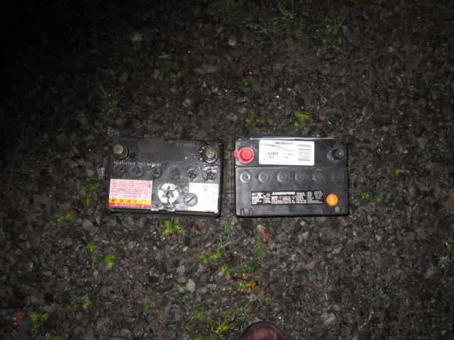

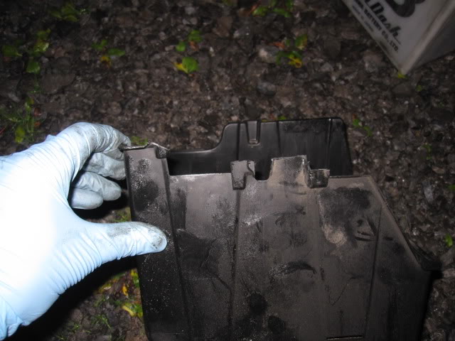

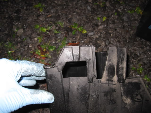

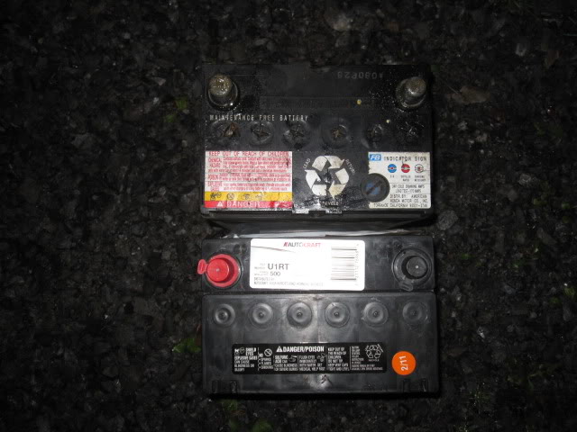

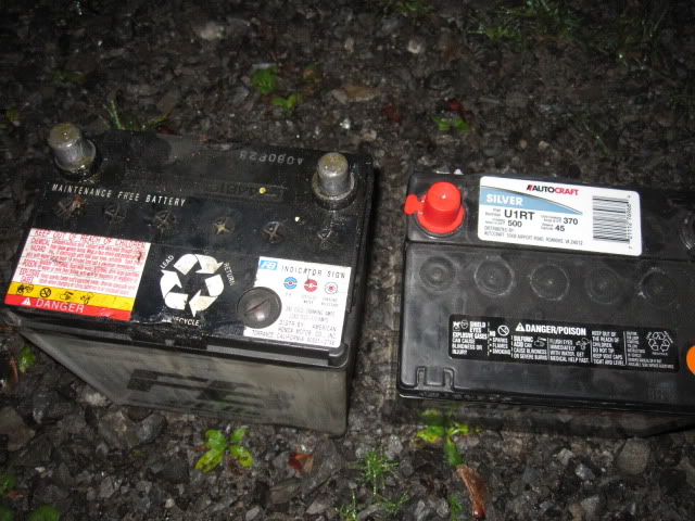

It works! The Autocraft Silver U1RT battery from Advance is identical in length and width to the OEM battery. It's about 1/2" shorter, which does present a few challenges. The battery box needs to be trimmed up on the front, and a 1/2" spacer made for the battery hold-down bar. After those were accomplished, it dropped in slick as snot.
Old vs. new:

Stock battery box:

Modified battery box:

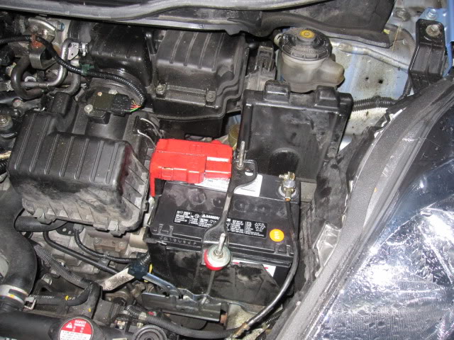

All installed. Note the spacer in the front to let the hold-downs get tight enough. I used an old polyurethane endlink. You can be more imaginitive, as long as it's about 1/2" high. Lowe's or HD sells 1/2" steel or nylon spacers for $1.50 or so. Nylon doesn't rust.
Despite how it looks, the battery is not touching either the airbox or headlight.
And, all the bolts are 10mm on the battery and hold-down bar. A ratcheting wrench comes in handy tightening down the hold-downs. Remember, negative off first, then positive!

That 45 is reserve capacity in minutes. CCA are 370. It was $68 after my credit card's cash back and a discount code through Advance's Web site.
Yeah, I was disappointed in it being almost a year old. It works fine, though. And I can get another one off the shelf if anything goes wrong.
