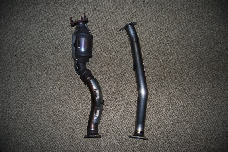

Here is the stock converter next to the J's downpipe I am running. As you can see on the stock pipe, the sensor is before the actual converter. So going with a downpipe will not fail an OBD-II check, but it might possibly fail on a sniffer check.

Did you have to do any kind of trick fix on the J's pipe like using a couple of spark plug defoulers?? Your stock cat pipe looks very much like a Megan down pipe with a resonator.... I pass inspection with one.

TC that's the thing, no need to as the secondary sensor comes before the actual converter. The secondary sensor is reading from the primary converter. The secondary converter plays no part in the OBD-II and is just there to further clean up the exhaust and possibly for visual inspections as it is not very easy to see the primary close-coupled converter hanging off the block.
