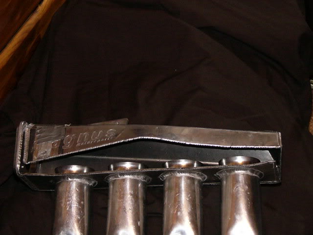

Originally Posted by GAFIT
Yeah, I've broken a lot of stuff in my day, but I didn't blame the manufacture and post a "warning" to all owners.
I blew an intake into a bunch of little pieces with a nitrous backfire one time, but I didn't suggest that the manufacture should have built an intake to handle nitrous backfires. It was my own stupidity trying to stuff a 200hp shot down a factory intake. I learned from my mistake and backed it down to a 150 shot and then had a bone stock looking car (even under the hood) running 11's
Ya don't say? And that is on a high quality manifold designed for nitrous. Some of them have those burst caps, this one just let the plenum pop. The IC piping was dented where it slammed into the shock tower after the couple blew off the TB. LOL

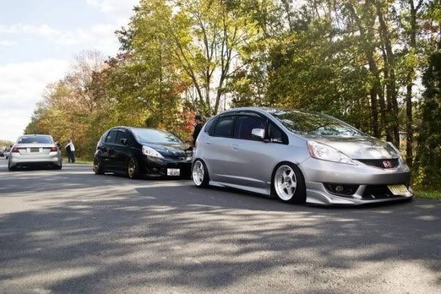

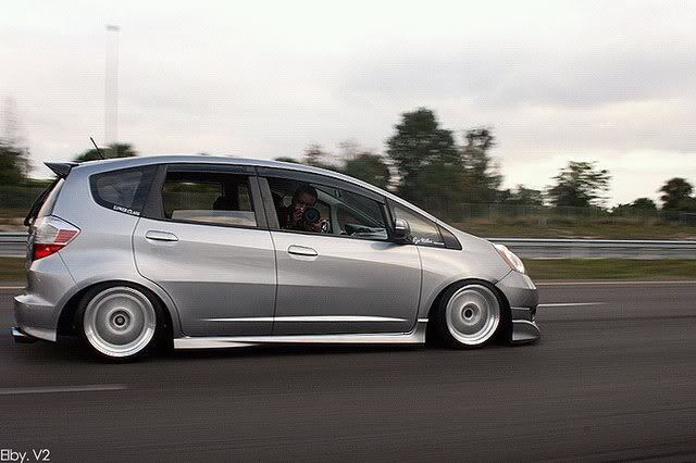

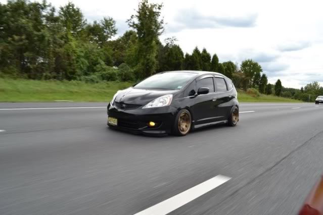

So this is my buddy Ron's car he's running the same suspension set up and wheel set up more or less he's had it done for the same amount of time that I have, yet he has nothing wrong with his car at all, not to mention that he rides it at the highest damper setting ,now when he checked his car there's no sign of damage like what happened to My car
When you remove the bendy bouncy part the suspension has less travel. The shocks cannot do their job absorbing kinetic energy. It has to go somewhere. Some winds up all over the car but it's especially focused at the top of the strut towers. Metal fatigue will occur normally, but much faster in this case.
I suspect the driver's side tower is compromised too.
