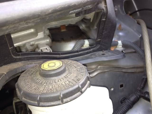

FitDEEZ's Avatar
Posts: 2,039
From: NJ
Driver side no damage

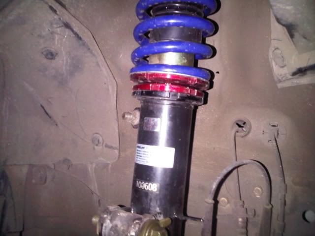

FitDEEZ's Avatar
Posts: 2,039
From: NJ
At lowest setting

maybe it's my lack of sleep... but all that still doesn't answer the question of how much suspension travel you actually HAVE. How far can yours (at your setting) compress before you bottom out?
