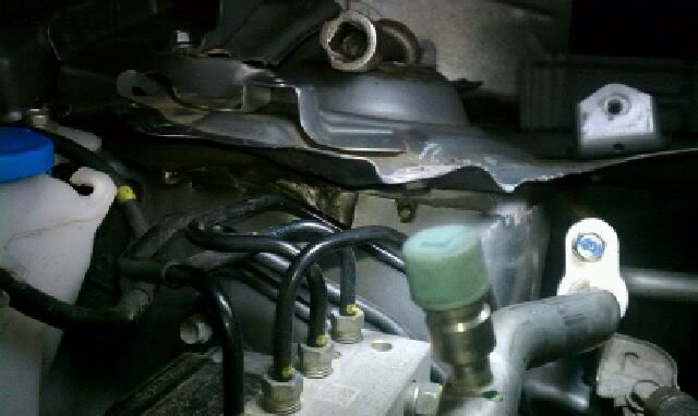

Yeah, wow can't believe I forgot to update.. I took the suspension out pulled the shock tower back down to where it belonged , lined it up and welded it all around instead of little tack welds and now the car is back together actually better then before since its stronger then the original welds
Here's a pic of it lined back up

Heavy spots or reenforces like these would be appropriated.

No way that's not right 2 spotwelds there should be 6 or more there. I'm going out and check to see how many MzFiT has there. Sorry brother that's another 1 of the nicest GE's here!
GLOR
Ya Deez I checked my GD and I counted 6+ spot welds in the same location.
Honda has sum esplain'n to do, keep us posted.
Mike
GLOR
Mike
Are you counting ALL the spot welds, or just within the few visible inches shown on FD's pics? Cause if you want to count all of them, there are plenty more, at least 9 (7 plus the 2 shown) dealing with the strut tower housing.
I'm pretty sure all GEs have the same number of spot welds, since I'm fairly certain this part was done by a programmed robotic arm.

If there is no more then 2 spot welds on that part of the strut towers, Honda is not on top of their quality control.... I like looking at dropped (slammed) cars with crazy offset for the hella flush thing but really guys there will be a time when the lack of suspension travel, stiff springs and damping is going to create problems.... I know this to be a fact because I have experienced it myself when I was half the age I am now..
